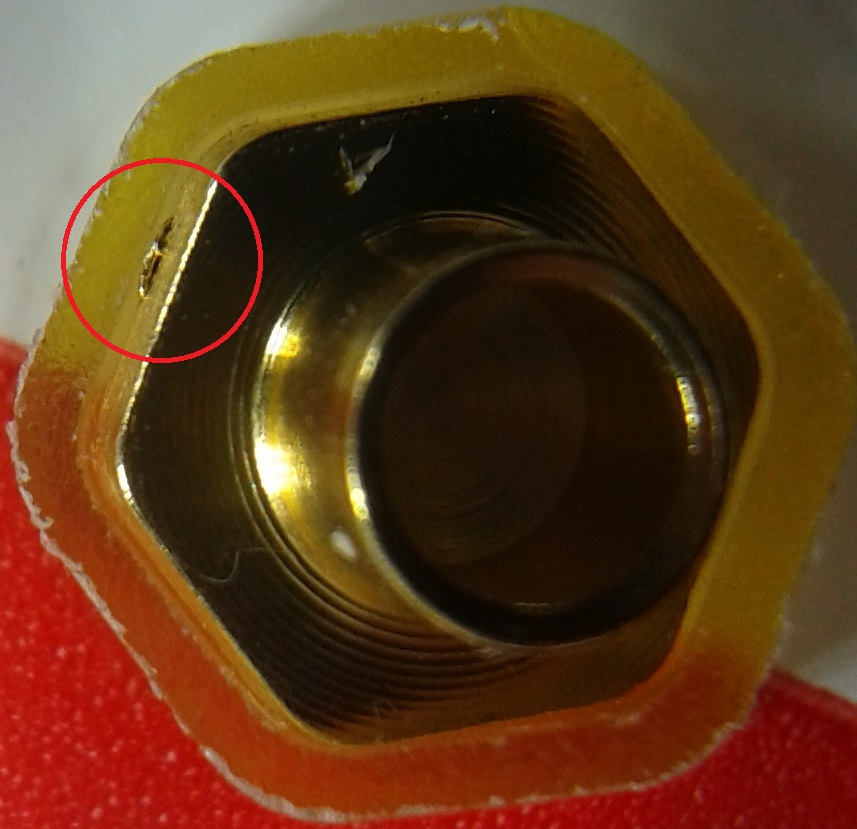

vince159 Posted May 4, 2016 Report Posted May 4, 2016 I'm not sure if this is the right place to ask about this, but it seemed like a good place to start. I'm having trouble with my Evolv 510's. They're jamming up. I'm assuming this is due to juice getting inside etc. I've been soaking some rubbing alcohol in them, and after some effort I can get them freed back up. Maybe the residue build up from the electrical contact is binding up the spring. Anyone else having this happen?
VapingBad Posted May 5, 2016 Report Posted May 5, 2016 vince159 said:I'm not sure if this is the right place to ask about this, but it seemed like a good place to start. I'm having trouble with my Evolv 510's. They're jamming up. I'm assuming this is due to juice getting inside etc. I've been soaking some rubbing alcohol in them, and after some effort I can get them freed back up. Maybe the residue build up from the electrical contact is binding up the spring. Anyone else having this happen?Some of the early ones had a slight bump on the inner part that may catch, I knocked this flat gently with a pin hammer and it works perfectly now.
