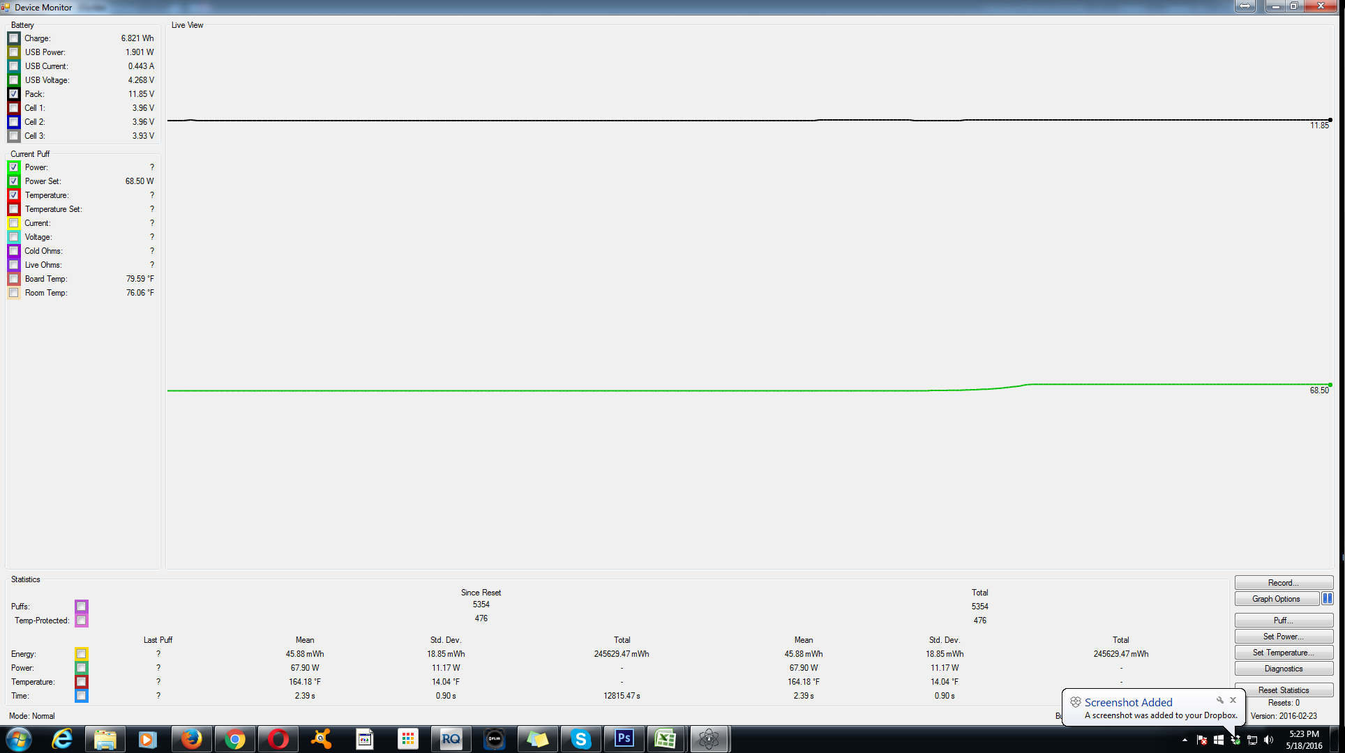

TKOVapor Posted May 18, 2016 Author Report Posted May 18, 2016 New to the forum, new to DNA200 chips. I'll try to be as detailed as possible. Problem: When I attach a tank to the VT200, the power automatically ramps up to 200W. Won't fire after that. Doesn't read oHms on the coil, either (although that could be because it won't fire/read the "new" coil"). IF I attach a tank and try to fire before it reached 200, it'll stop ramping up to 200, but doesn't actually fire. Doesn't read the oHms either. And once I take finger off fire button, the power ramp up continues. Tanks used while trying to figure this out:2 different TFV4 tanks (1 full, one mini) with triple coils at 0.2 oHm1 Vapmod XTank with 0.3 oHm coil1 Matrix tank with 0.6 oHm coil(All coils Kanthal)Uwell Crown with .15 oHm Ni200 coilTroubleshooting already tried:Installed Evolv DNA 200 Escribe software - device connects just fine. All controls within seem to control/affect the device as supposed to.Performed firmware update - NothingReset to factory defaults - NothingReset all profiles to Temperature: Off - NothingTried a few different combinations of the above - NothingAtomizer Analyzer DOES read correct oHms off coils when connected.CAN reset power output in the Device Monitor, as well as perform simulated fire (which SOUNDS like it actually fires the atomizer when connected).Essentially, no matter what setting we change, revert, update, firmware upgrade, etc, when you attach an atomizer to it, it automatically sends the power up to 200W. Thoughts?

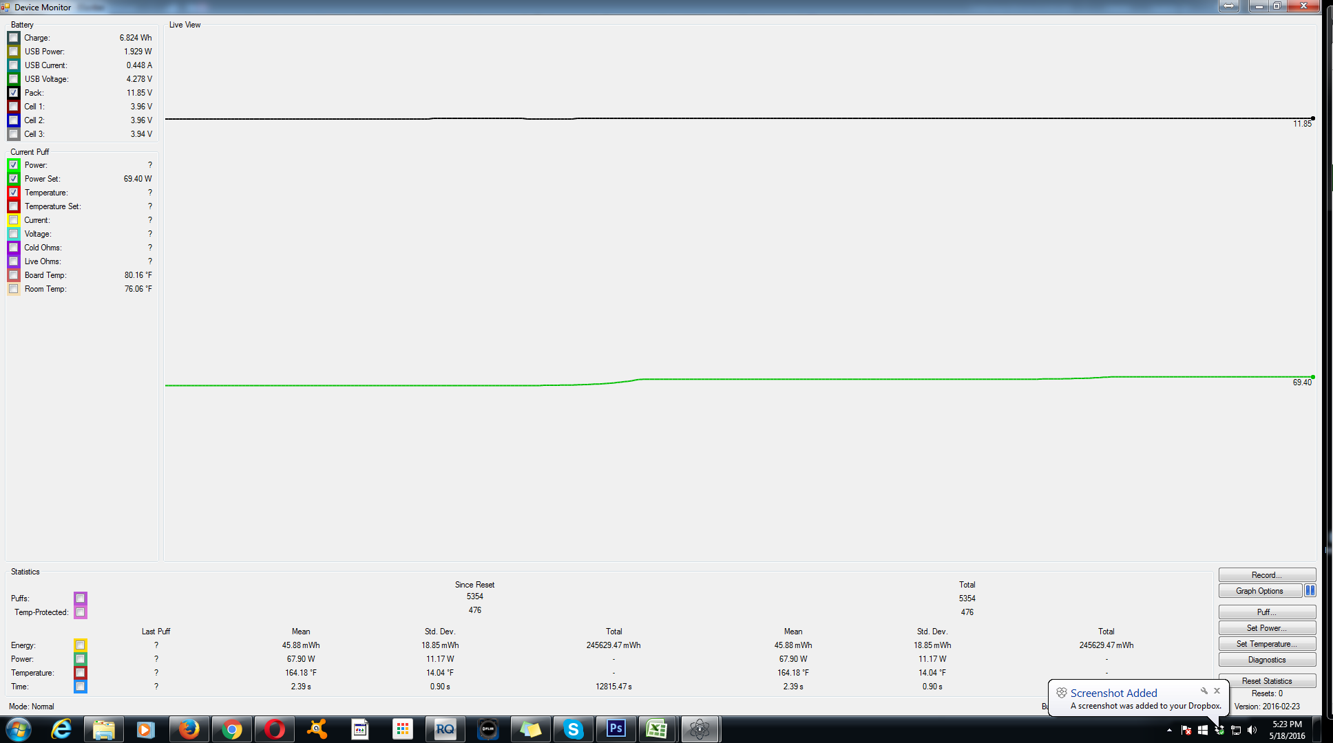

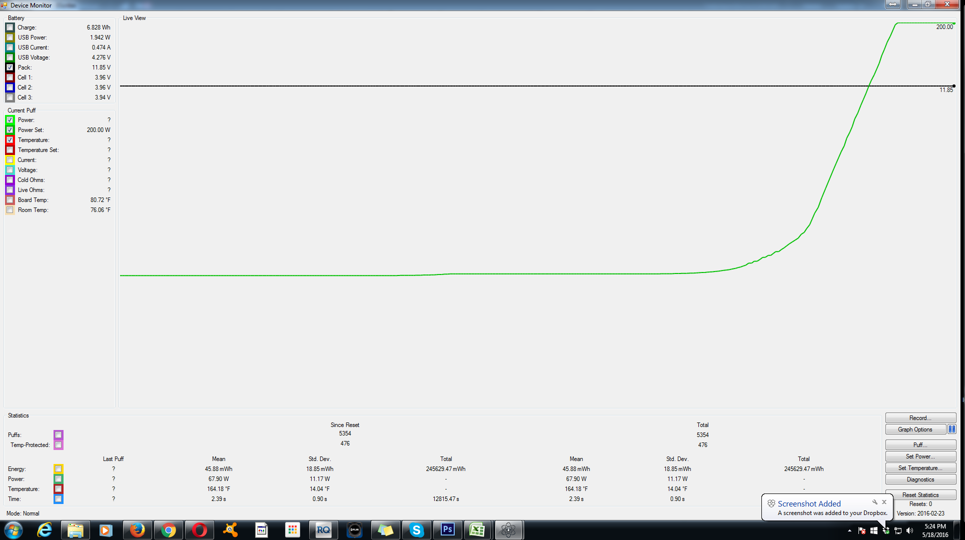

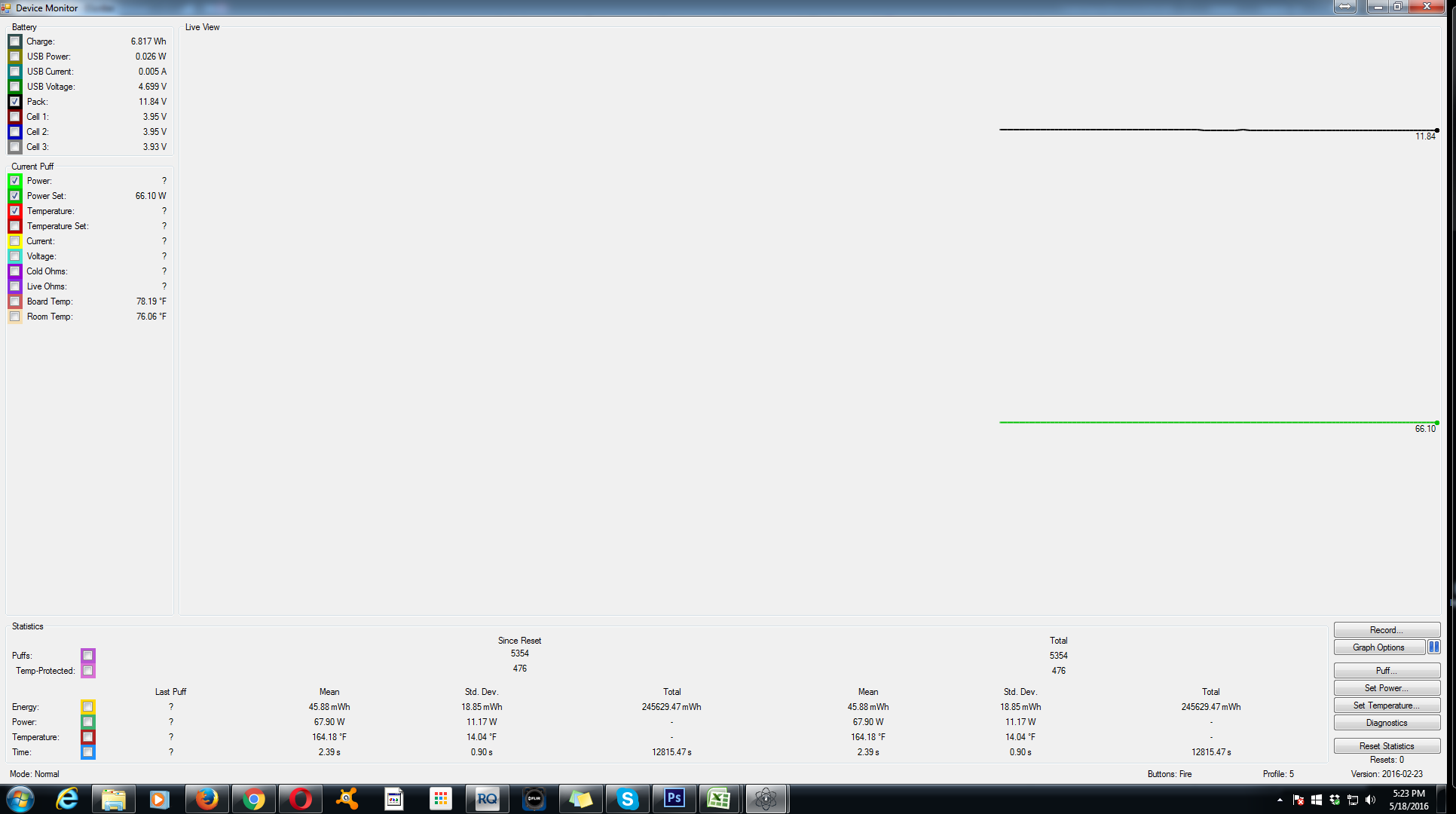

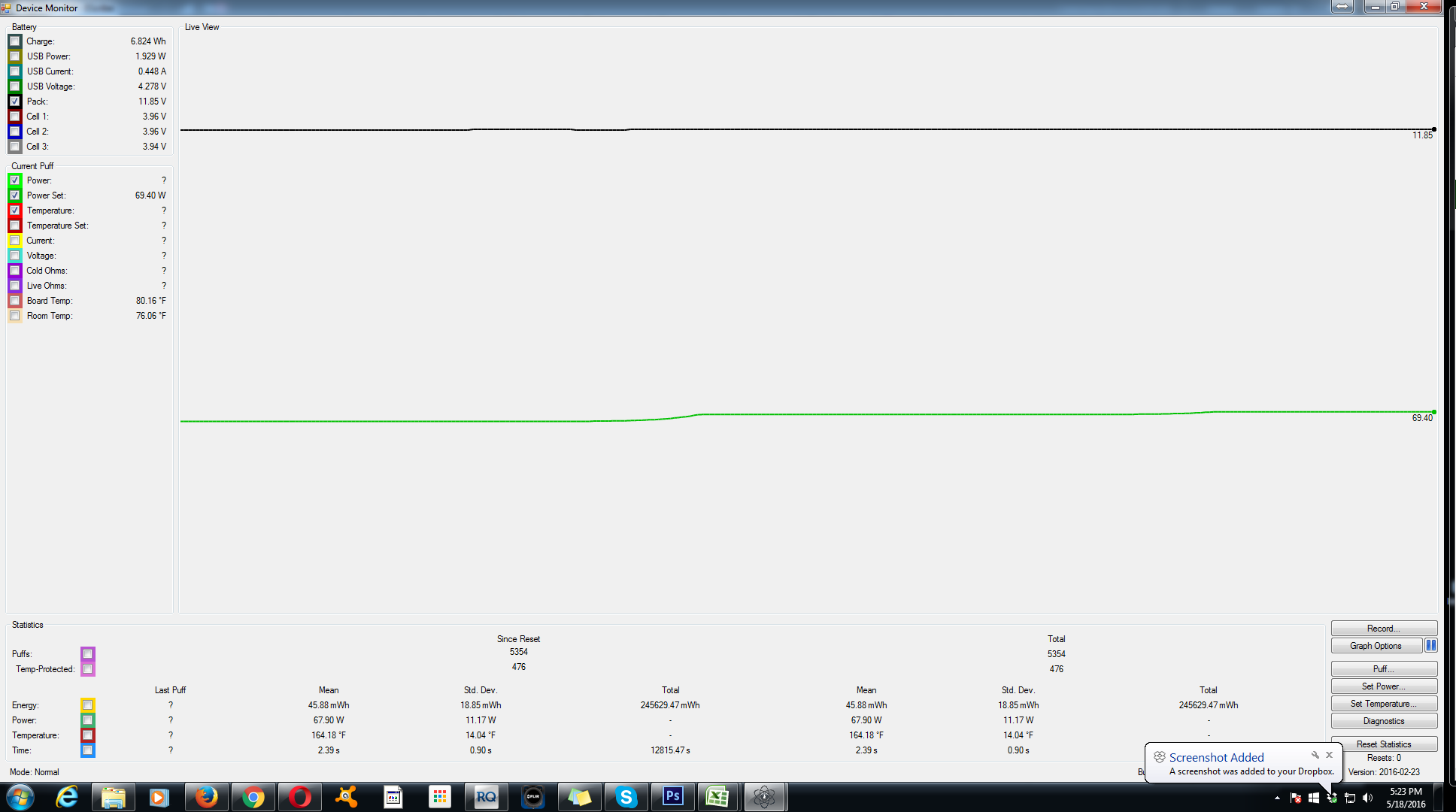

BillW50 Posted May 18, 2016 Report Posted May 18, 2016 Do you know how to take a snapshot of the screen? If so can you take a snapshot of EScribe's Device Monitor while the fire button is held down and upload it here?
TKOVapor Posted May 18, 2016 Author Report Posted May 18, 2016 Yes, I do. I may be new to the DNA200 chip, but I'm not new to computers or software by any stretch of the imagination. Connected, holding down fire button without an atomizer attached. TVF4 Mini attached with triple coil, fire 1 Second fire with same tank No fire, tank still attached. You can see how fast it ramped up to 200W

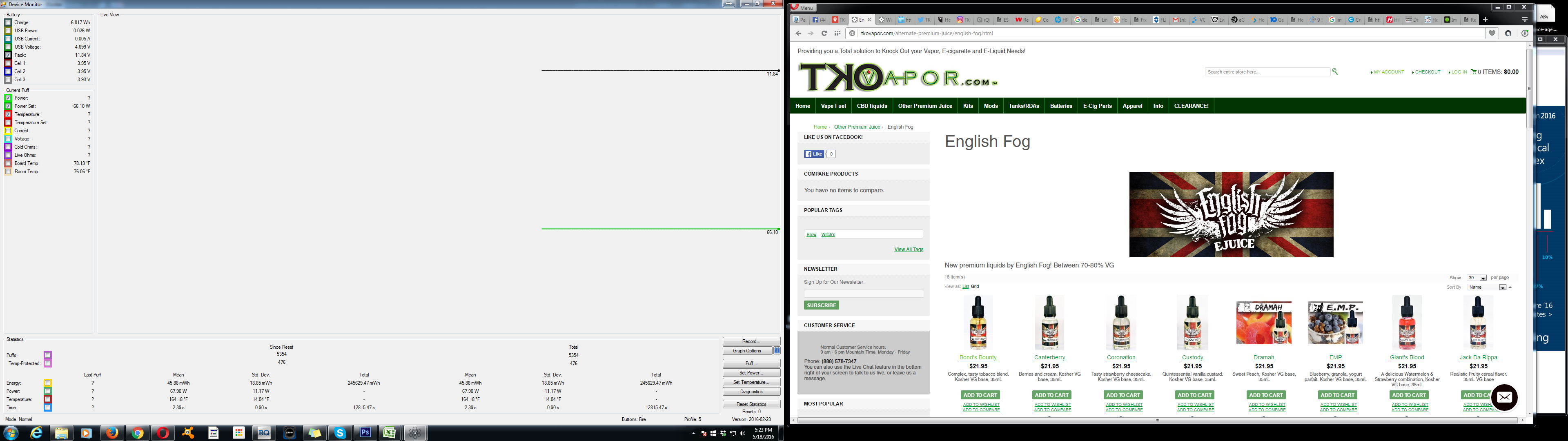

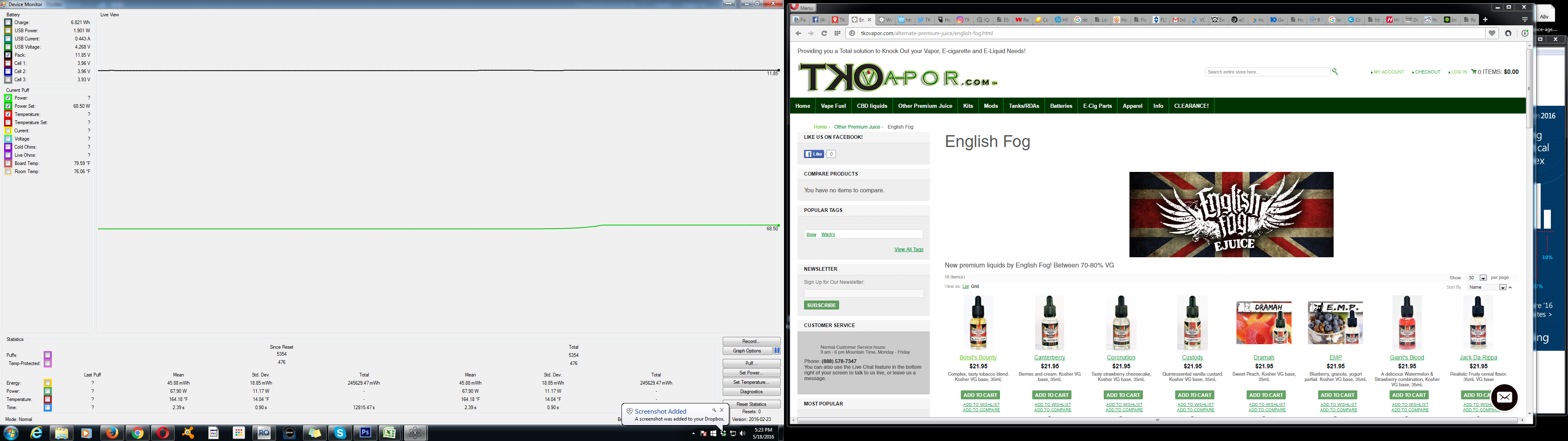

TKOVapor Posted May 18, 2016 Author Report Posted May 18, 2016 Was not intentional. Apologies. Just grabbed the screenshots, that's what was on my second screen. I've removed the second screen. See updated post.

BillW50 Posted May 19, 2016 Report Posted May 19, 2016 That Screenshot balloon is covering the button pressed status. I am guessing the only one that you had pressed at all was the fire button. The first one you can see just the fire button being pressed.It also seems you had this for awhile and it was working fine, right? Then this problem popped up, right?Man it looks like part of the board is working and part of it is dead. Does the display work when unplugged from the USB? Besides a bad board, maybe a bad connection to the 510. Not only check the hot wire, but the ground is just as important.
TKOVapor Posted May 19, 2016 Author Report Posted May 19, 2016 mikepetro: The Up/+ button isn't stuck. When an atomizer isn't connected, I can control the wattage up and down without a problem. And it doesn't automatically ramp up unless you connect an atomizer. Been left overnight without one connected, and still reading 55 where I left it.BillW50:I was pressing only the Fire button in the first three screen shots. Wasn't pressing anything in the 4th. I could try taking another set of screenshots to confirm, if you'd like. Yes, the person that owns this device has had it for a while, although they hadn't used it for a little while. Yesterday was the first time they used it again, and this just started happening when they started to use it. I don't actually own this device (hence my inexperience using DNA200 chips), but I was asked to take a look at it. The display does work when it's not plugged into USB. I'll check with my friend, see if they want to take it apart of not. Thanks for the help, this was kind of what I'd come to a conclusion on before coming to this forum. I wanted to see if someone had actually run into this issue before, in case this was a specific issue. Anyone has any other ideas, would love to hear them. If part of the board is dead, what do I do about that?

James Posted May 21, 2016 Report Posted May 21, 2016 black lace, what are you talking about? His graph is showing the setpoint. That's the Up button most likely.

BillW50 Posted May 21, 2016 Report Posted May 21, 2016 James said:His graph is showing the setpoint. That's the Up button most likely.But the Device Monitor isn't showing the Up button being pressed.
dwcraig1 Posted May 21, 2016 Report Posted May 21, 2016 Poster claims no atty in first screen but it fires set wattage when fire button is pressed.Last screen claims no fire button is pushed just atty installed and it fires by itself @ 200 watts.How can this be even possible?
BillW50 Posted May 21, 2016 Report Posted May 21, 2016 dwcraig1 said:How can this be even possible?Easy, the board is acting on its own. I would check for any juice on the board. If that isn't it, then it needs to be replaced or repaired.

VapingBad Posted May 21, 2016 Report Posted May 21, 2016 dwcraig1 said:Poster claims no atty in first screen but it fires set wattage when fire button is pressed.Last screen claims no fire button is pushed just atty installed and it fires by itself @ 200 watts.How can this be even possible?It's not firing in the last pic, it's just showing the set power rising, power is showing as "?" on the lhs, ther is no power trace and the battery voltage is level.Also re battery safety the fuse should protect the battery from any board fault providing the battery is suitably rated.
dwcraig1 Posted May 21, 2016 Report Posted May 21, 2016 VapingBad said:It's not firing in the last pic, it's just showing the set power rising, power is showing as "?" on the lhs, ther is no power trace and the battery voltage is level.Also re battery safety the fuse should protect the battery from any board fault providing the battery is suitably rated.Got that.....finally, now that you pointed it out. thanks

dwcraig1 Posted May 21, 2016 Report Posted May 21, 2016 Perhaps I should have said that I got it that the green line was the set point and not the firing wattage.Juice or something conductive on the board is what I'm thinking as well....but just guessing.
