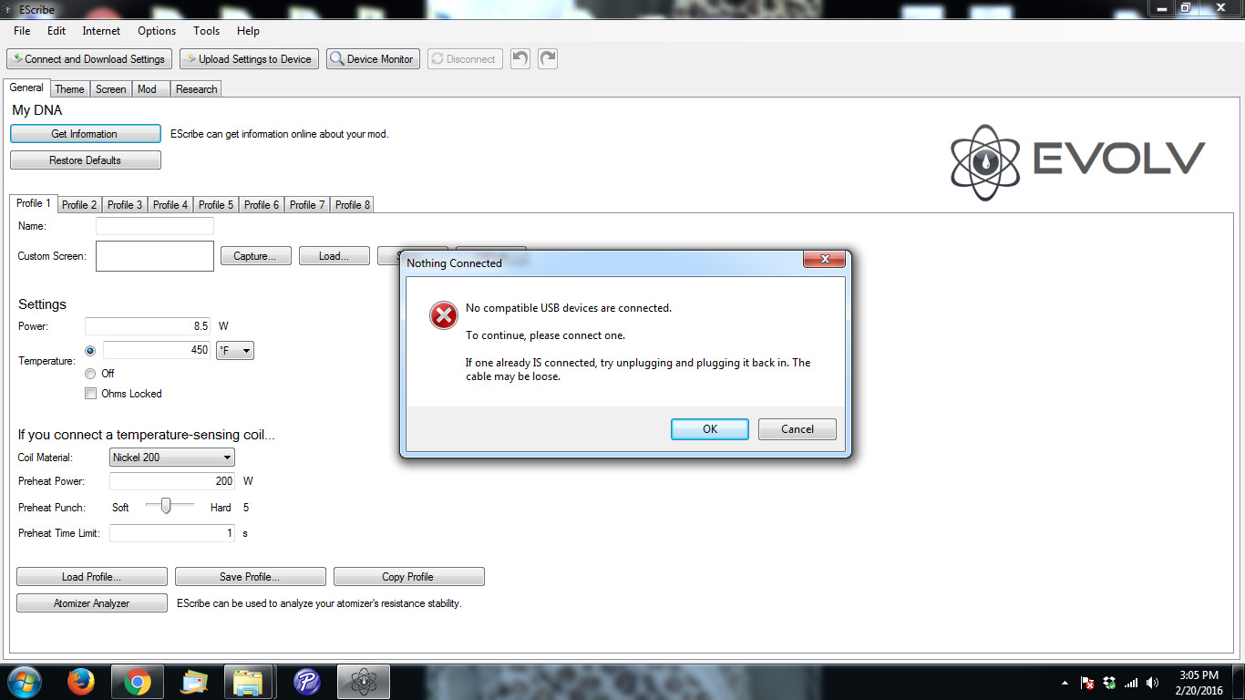

Bingo6104 Posted February 20, 2016 Author Report Posted February 20, 2016 Well after getting my board back from warranty I go to load it up with escribe to update the firmware. Escribe crashed during the upload and now my board will not come on. I have tried to do so manually in ecribe and I get a no device connected when i try now. I have searched for a while and I haven't had any luck finding a solution. I've tried 5 different data cables, even ones that have worked before with no luck. Any suggestions? ?

Bingo6104 Posted February 20, 2016 Author Report Posted February 20, 2016 Just downloaded and to force update again. Same issue, no device found
retird Posted February 20, 2016 Report Posted February 20, 2016 So you tried to force the update and got an error message... did you click thru the error message? Try again...In EScribe try clicking Get Information under MY DNA in the General Tab....
Bingo6104 Posted February 20, 2016 Author Report Posted February 20, 2016 No matter what i do escribe will not connect to the board.
Bingo6104 Posted February 20, 2016 Author Report Posted February 20, 2016 I just got it, dont know what the deal is. Maybe the thousand time unplug and plugging it up and forcing the update worked. Might be a communication issue with my laptop

Nick Posted February 23, 2016 Report Posted February 23, 2016 Just to chime in, this was likely caused by windows update driver search. I have noticed on a few select machine that the device will connect, the board shows up in Device Manager, but it doesn't become "available" to connect to EScribe as the driver search sometimes takes 5-10 minutes. Not sure exactly why it works so fast on some machine, and takes forever on others but I've had to turn this off under advanced system options in a few cases, such as on my laptop. We looked into this a bit but it seems to be related to how windows handle drivers and not something we are doing.
