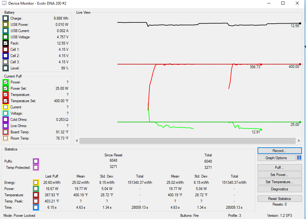

retird Posted August 22, 2016 Report Posted August 22, 2016 @2legsshrt, as you know the DNA technology is not the same as the SX you are used to using. The SS316 EScribe works very well once you set your settings to get the vape you want. You may not get the same vape using the same temp/wattage/etc you set on the SX. You just need to adjust the settings accordingly to achieve the same vape as the SX. Here is a screenshot of EScribe SS316 profile I use. The temp is currently 400F, wattage set at 25 watts, preheat set at 60 watts/punch 5/duration 1s. I am using a SS316 Notch Coil with a ohm's reading of 0.25. Note the smooth temp line. The Temp Protect is not an error message it just lets you know the temp setting has been reached.This Device Monitor screenshot is using the DNA200 but my DNA75's are set the same and have the same smooth temp graph ......

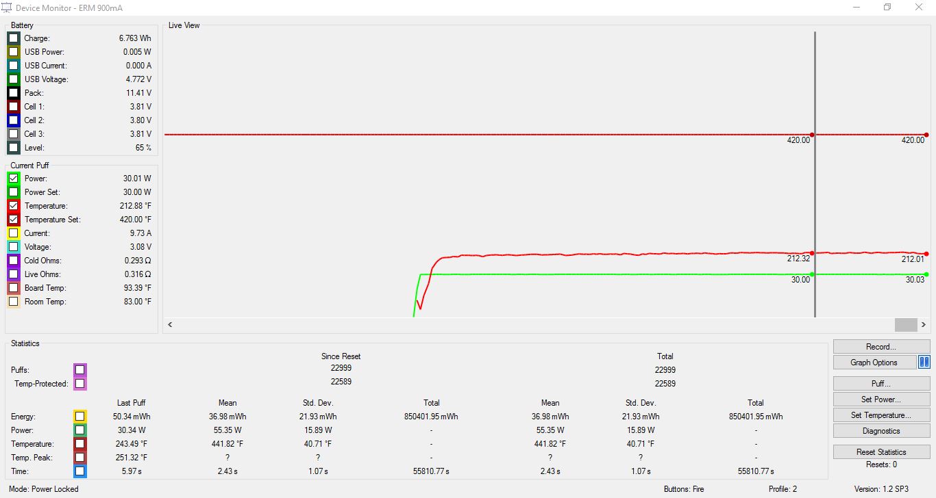

Spirometry Posted August 23, 2016 Report Posted August 23, 2016 Did a water test tonight. Single coil 24awg Temco ss316l, Vaporshark dna200, kayfun5 deck, Evolv default ss316 wire profile. After mating atomizer, I let it sit unplugged for 20 minutes for refinement.
VapingBad Posted August 23, 2016 Report Posted August 23, 2016 Your power is set way below your temp and it is not temp limiting and effectively in power mode, nothing wrong with that just saying.
Spirometry Posted August 23, 2016 Report Posted August 23, 2016 Not temp limiting because you can't heat water past 212° F. You can increase the power to a point that the water doesn't keep the coil cool, but then you will see the temp keep rising until it hits your limit. So yes, it is effectively running in power mode, but look at the temp it is running at. I just wanted to show that the Temco wire with the Evolv profile was pretty accurate. If I had a nice straight line at lets say 260F, then you would know that either the cold resistance was wrong or the tfr curve was wrong.
