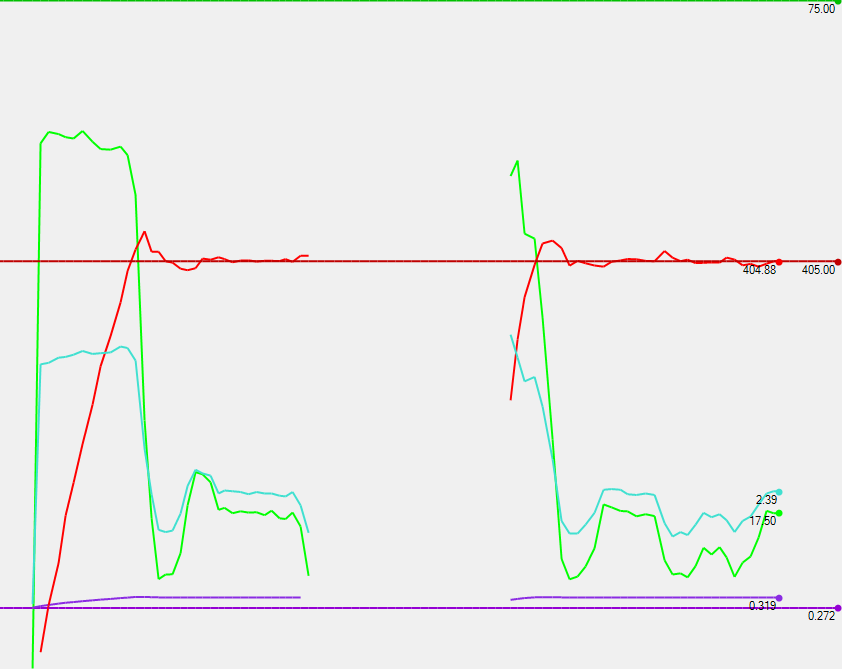

Can't figure this out, hoping someone here has an idea.
I have a DNA 200 running SP2 of the latest firmware.
I have 2 DNA 75's running the latest 6/5/16 firmware.
All 3 mods are using the exact same TCR file from SteamEngine for SS316L.
All 3 mods have had the case resistance set using a copper plug.
All 3 mods have had the case cooling analyzer run & settings adjusted.
The screenshots are of each mod using the same atomizer with the same build.
All 3 mods are using the same settings for the screenshots:
75 watts, 405 degrees, 75 watt preheat, punch set to 5 for 1 second.
The 200 seems to run great. I love the vape. Warm, dense, & flavorful.
The 75's are weak. I can actually detect the wattage cutting in and out once temperature is reached.
I notice the same difference regardless of atomizer. My builds are usually about the same so initially I chalked it up to the atomizer and just increased the temp. Today I decided to compare the mods w/the same atomizer.

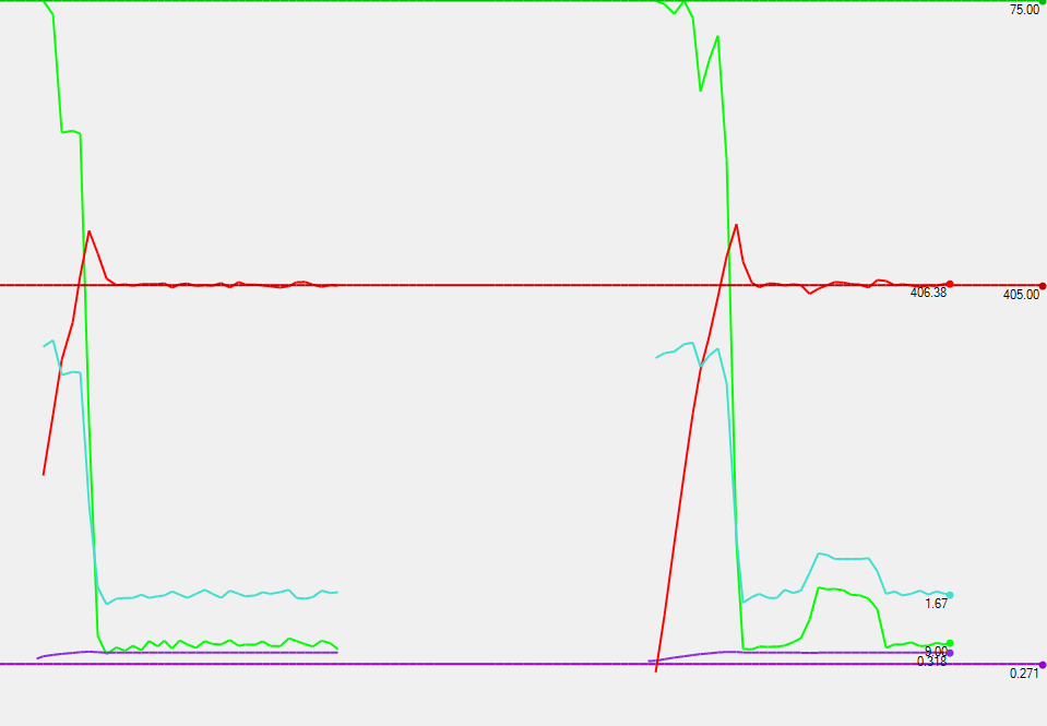

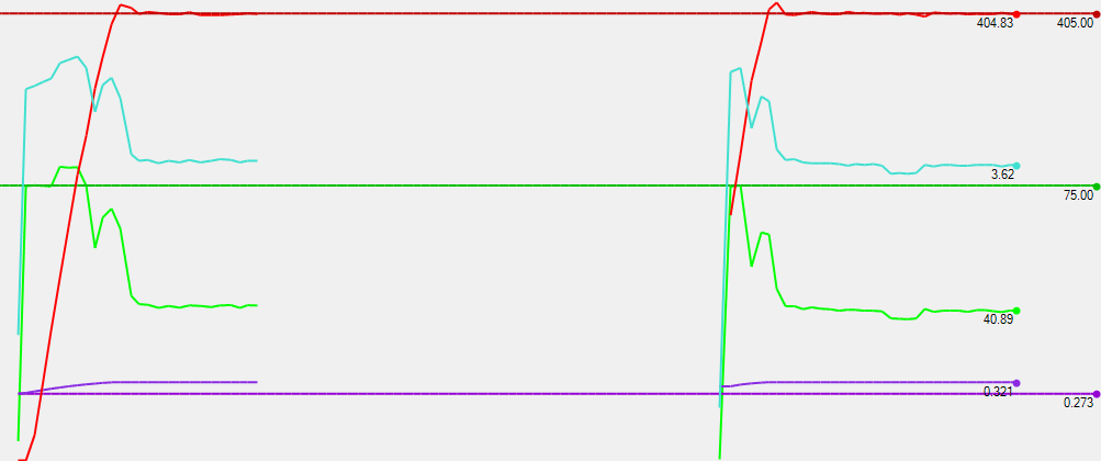

For the screenshots, I had Escribe puff the mod for 5 seconds.
The 200 levels out around 40 watts & 3.6 volts.
The 75's drop to between 9 to 17.5 watts and 1.6 to 2.4 volts.
The atomizer's 510 and the mod's 510 have all been cleaned with alcohol prior to the screenshots being taken.
The build is a dual, SS316L Clapton coil, 26/36, 7 wraps slightly spaced. .27 ohms.

Hey Bill, thanks for the idea but I don't think that's the issue. One mod uses dual 18650's while the other is using a single 26650. The screenshot below is of the dual 18650. Sag isn't the issue, in my opinion. Gotta be something else.... o.O Something to note; before I decided to compare the mods, I was 'living with it' by increasing the temp and therefor the wattage. Battery sag would be more noticeable at higher wattage if that were in fact the issue, wouldn't it? Also, when in power mode, both 75's also cruise along fine.

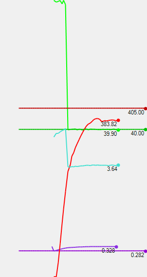

I wondered if the Temperature Dominate setting had any effect so, unchecked the box and now, at 40 watts, 3.6 volts, the device mgr show the coil doesn't even reach temp. When temp dominate was set, the dev mgr showed the coil reaching temp at 9.5 watts and 1.6 volts...
