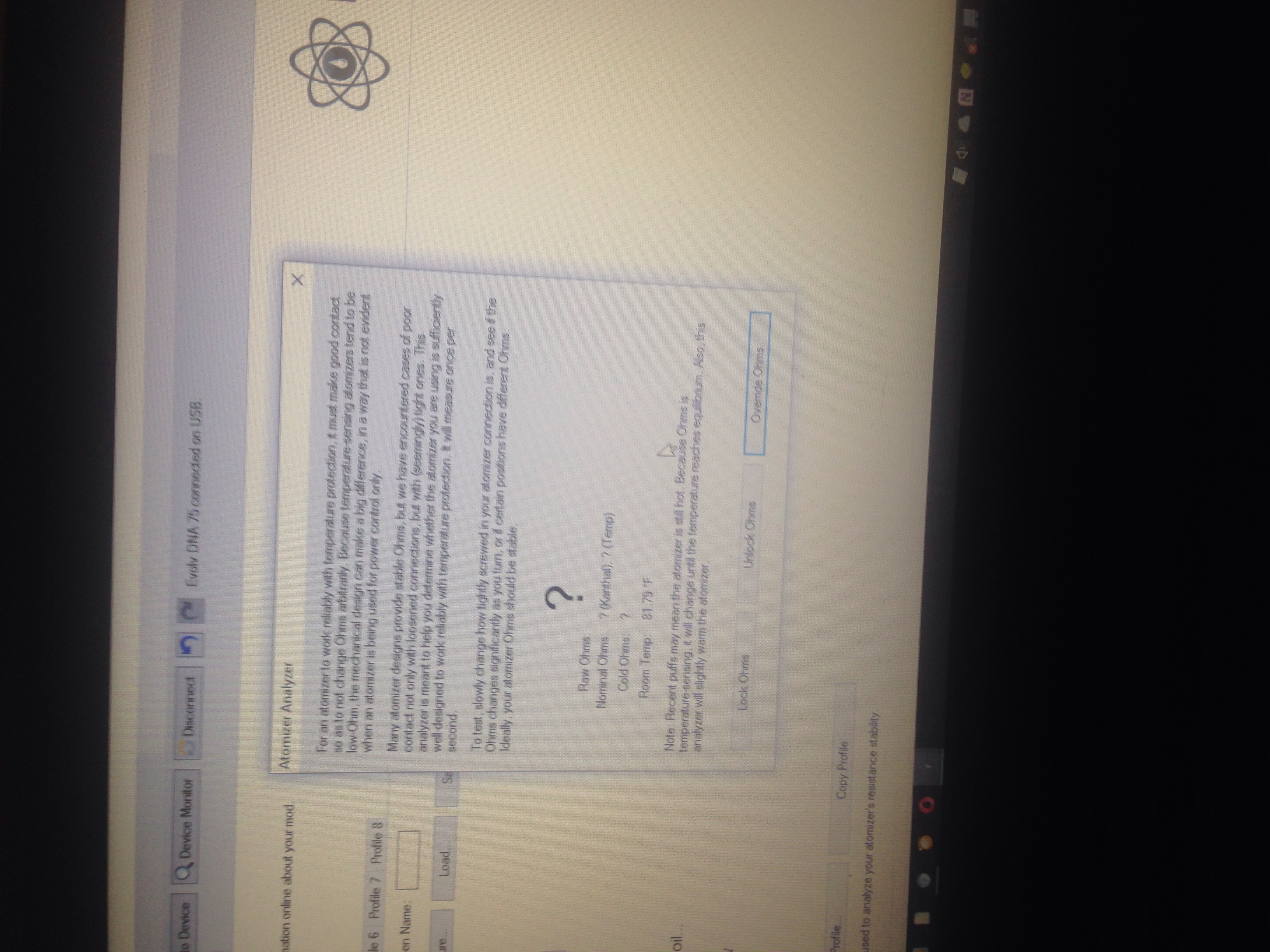

Wolf_7 Posted August 14, 2016 Author Report Posted August 14, 2016 ChunkyButt200 said:welcome to the forum wolf_7. most likely something with your top tank or the tank itself is not making a good connection to the mod. try another tank. if the problem goes away, it's the top tank that's the problem. if the problem persists, there could be something wrong with mod's 510. possibly a stuck positive pin.make sure the coil is screwed in tight, and the tank tight to mod.you can also open atty analyzer in escribe and check your atty's stability. try slightly unscrewing the tank on and off a little while watching the ohms. also rock the tank back and forth while it's screwed tightly on the mod and see what the ohms do. okay I will try watching them in escribe, what should I look for with the ohms exactly. A lot of variation or super consistency
Spector NS5 RD Posted August 14, 2016 Report Posted August 14, 2016 Wolf_7 said: okay I will try watching them in escribe, what should I look for with the ohms exactly. A lot of variation or super consistency one thing to do even without using atty analyzer is see if your coil is reading correctly on your lava box. if they're rated on the package as 0.25 (just an example) and your mod is reading it as .30 or above then you have a poor connection somewhere, whether it be the coil, where the coil screws in to the base or where the base screws into the 510 or even the 510 itself. what to look for in AA is basically the same thing, high ohms and/or if you see the "?" instead of a reading. "check atomizer" means the mod is losing connection to the atty, a complete disconnect. also, make sure the spring loaded 510 pin is......still "springy" and moves freely up and down. i have heard of one person here crushing their 510 connector pin permanently down on their lavabox from screwing down an atty that had a very long 510.

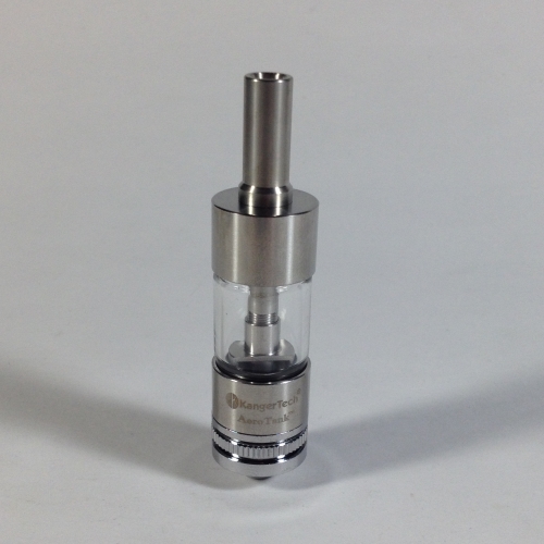

Dampmaskin Posted August 16, 2016 Report Posted August 16, 2016 Remember the first version of the Aerotank, the one that looked like this? If you screwed it too tightly on a 510, the center pin would short out inside the base of the tank. I learned that using a mech mod. Fun times.
