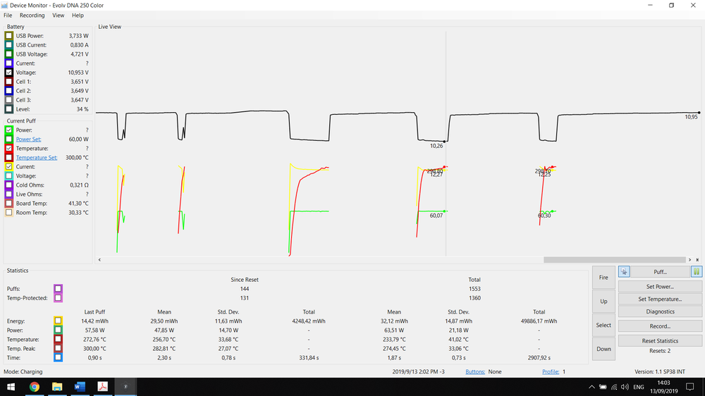

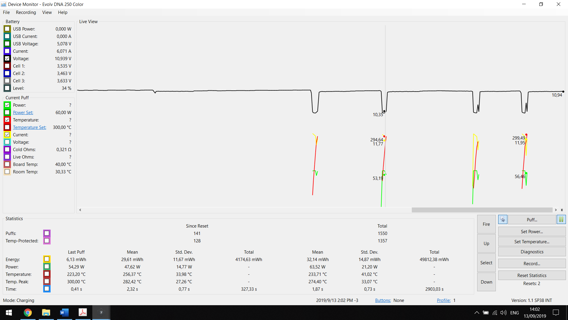

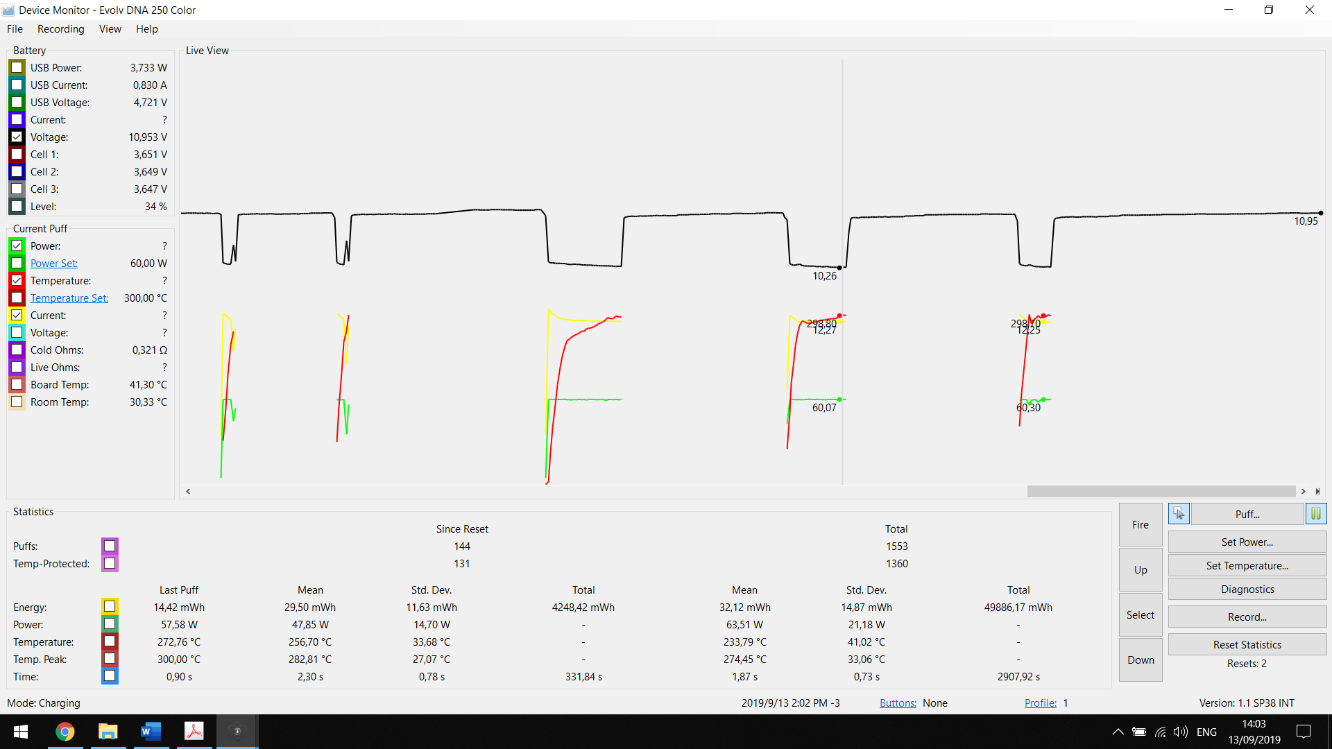

saschacolussi Posted September 13, 2019 Report Posted September 13, 2019 Hi guys, just managed to achieve what i was talking about. The first picture gets me the temp protected warning with little juice. In the second one, i just dripped juice to see if that was the problem, i was able to vape a little longer but got the same warning too. I tought that with replay it would lower the wattage and allow me to keep vaping but it just cuts the power. Any help woud be apreciatted, thanks.

retird Posted September 13, 2019 Report Posted September 13, 2019 What happens if you lower your temperature setting to 250C without changing anything else? What happens when you only increase wattage to 70 watts instead of 60 watts... Did you ever try a single spaced coil? We are trying to help but we need to rule out things along the way to get to your issue. So please try a single spaced coil after you try the two things above.... It was pointed out to me the other day that we don't see where you have used Replay.... In Device Monitor it doesn't show any Replay puffs... Example showing replay puff totals... partial screenshot:

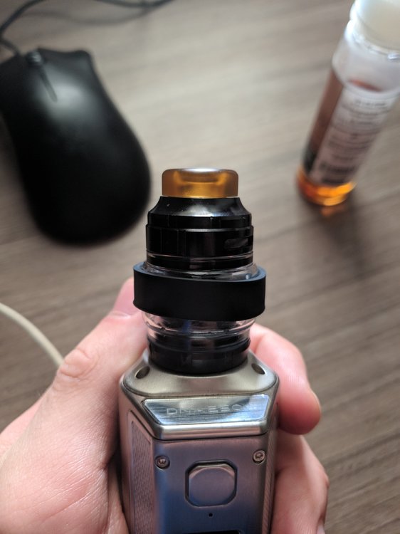

retird Posted September 13, 2019 Report Posted September 13, 2019 What atomizer are you using... show us a picture with the coils in the atomizer too....

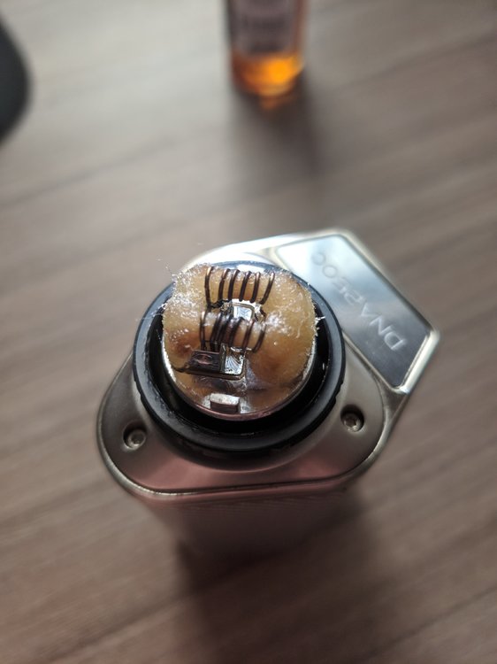

saschacolussi Posted September 14, 2019 Report Posted September 14, 2019 Here are some of my build pictures. Just lowered the power to 50w and preheat to 60w with a punch of 7. It's working now, but why is that? I mean, shouldn't I be able to increase the power, or punch, to reach the desired temperature quicker? Thanks a lot mate.
saschacolussi Posted September 14, 2019 Report Posted September 14, 2019 Forget it, it's doing the same thing now, I've got a few puffs only. Ps: it's a Zeus's x clone
retird Posted September 14, 2019 Report Posted September 14, 2019 Hard to tell from the picture but are both coils fully spaced where no coil wrap is touching another anywhere? It looks like on 1 of the coils 3 wraps have heated up hotter than any other coil wrap in either coil... may indicate a hot spot... Can you try a different atomizer as sometimes certain atty's just won't play well (the Zeus is said to work but don't know about the clone). I guess you don't want to try just 1 spaced coil only.... and you don't want to " increase wattage to 70 watts instead of 60 watts " and see what happens and you don't want to just lower your temperature setting to 250C without changing anything else " Are your dual coils matched as far as ohms go? Time for me to hand this thread off to someone else. Good luck....
