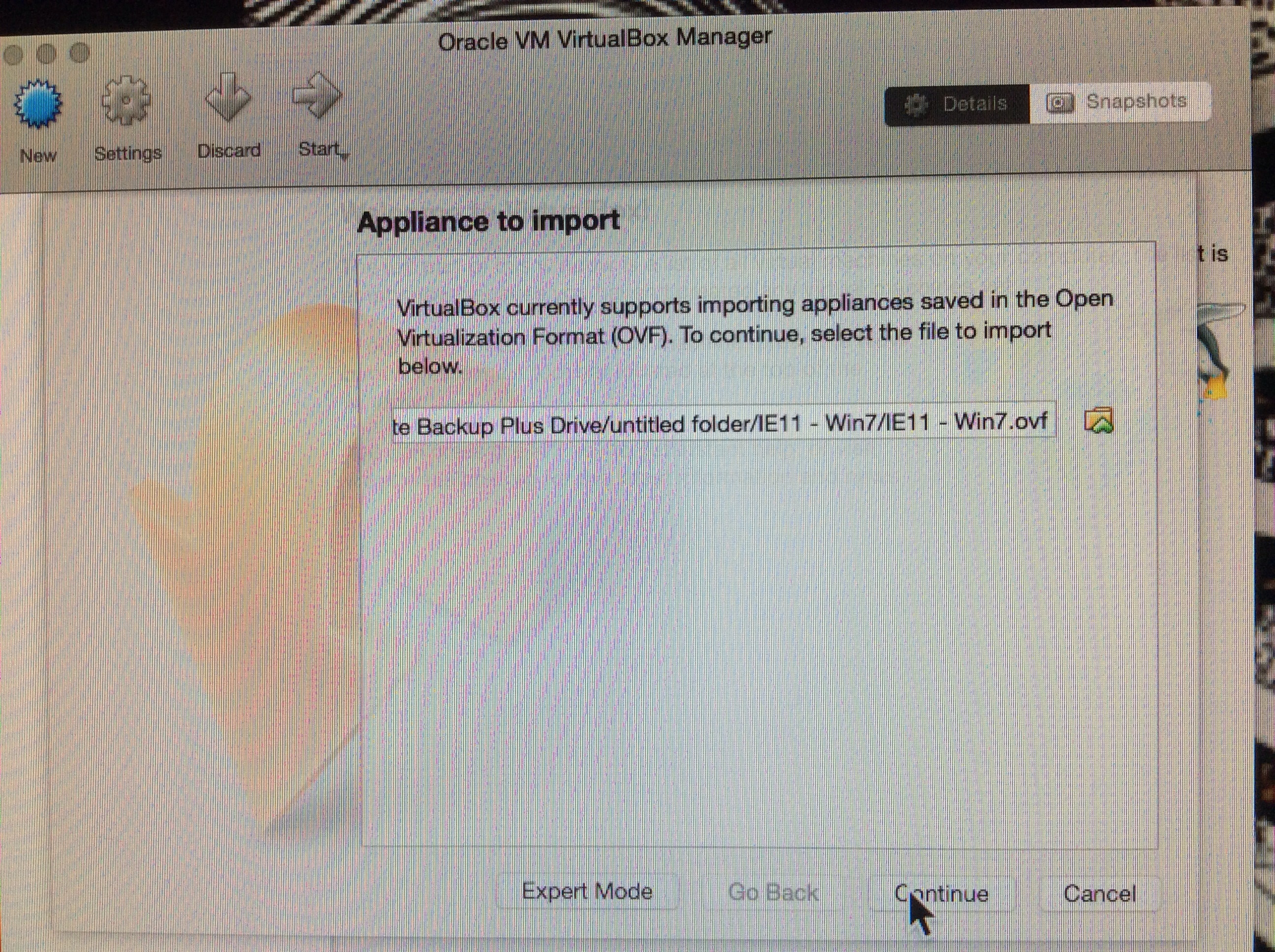

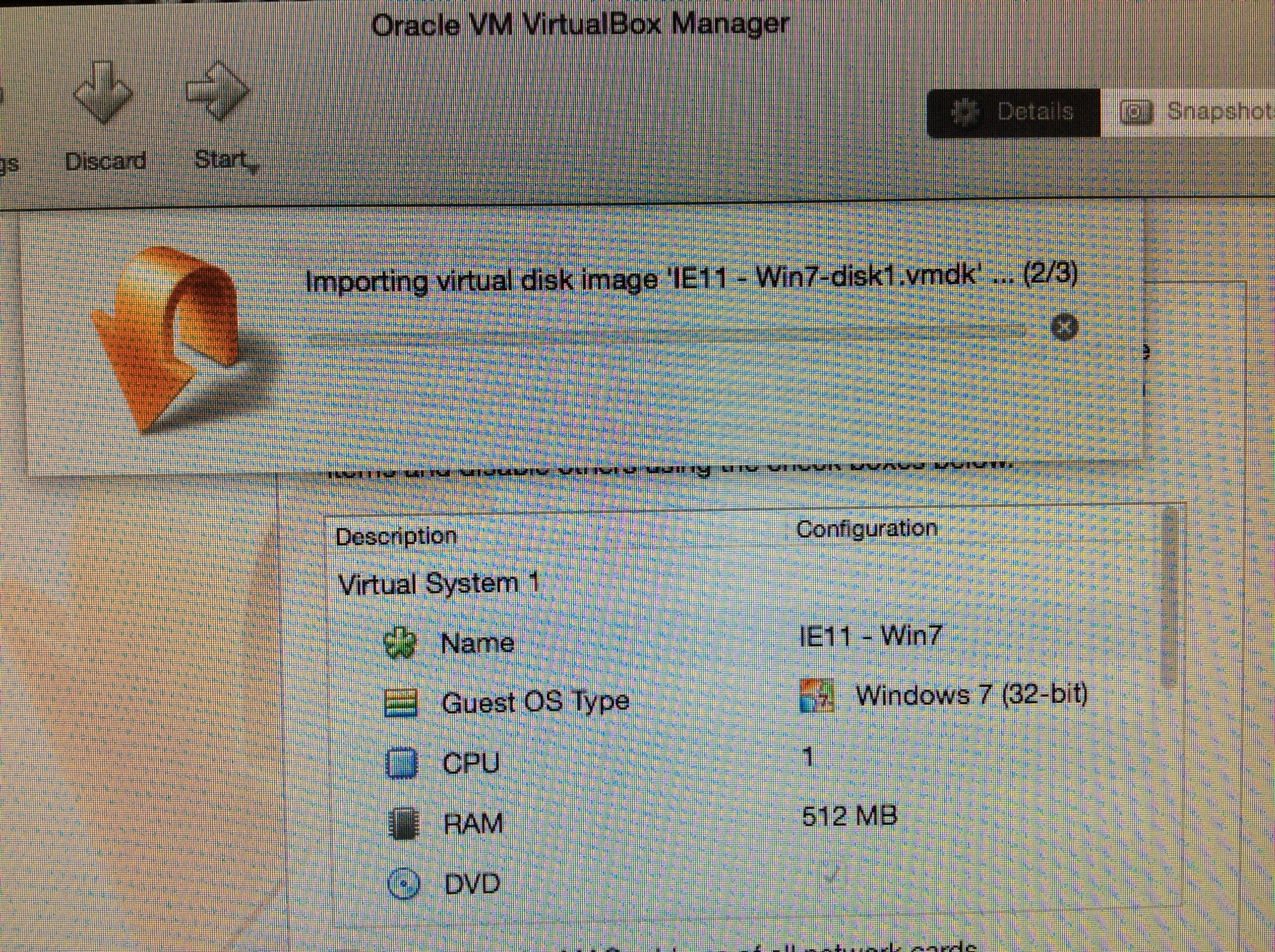

digatel Posted October 13, 2015 Report Posted October 13, 2015 My MAC recognized the DNA 200 and in VB, it gives me the option to add the port, but when I run VB, it says "FATAL: No bootable medium found! system halted." and when I click the USB icon on the bottom the "Dimension Engineering Evolv DNA 200 USB" link is not in dark....I have no idea what I'm doing and it's so frustrating!
zeroflow Posted October 13, 2015 Report Posted October 13, 2015 @digatel: Sounds like you didn't install windows in VB?
hayseed6550 Posted October 14, 2015 Report Posted October 14, 2015 Yes sounds like you forgot to install windows, or if you did a zip download forgot to import the appliance.

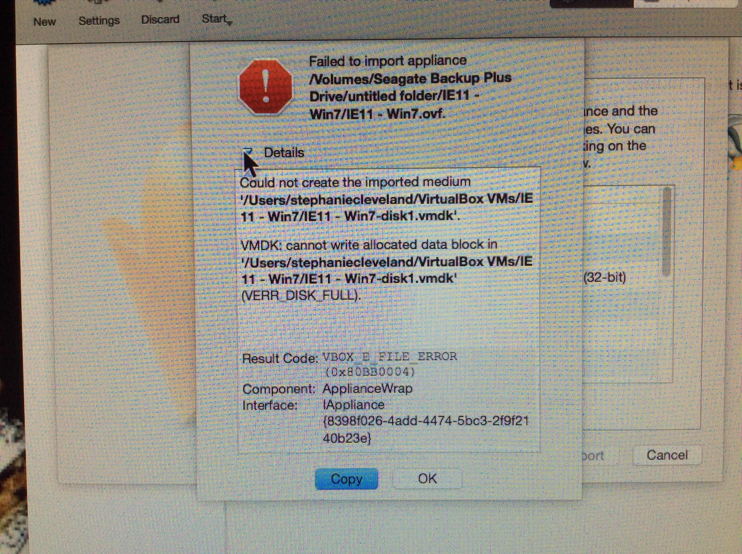

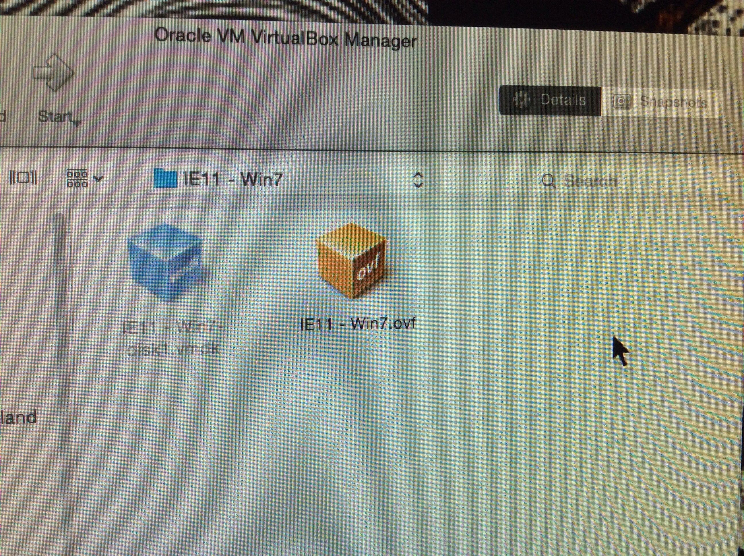

digatel Posted October 14, 2015 Report Posted October 14, 2015 This is exactly what I'm doing...and then the outcome. Sorry for the crap pictures...

blueridgedog Posted October 18, 2015 Author Report Posted October 18, 2015 digatel said:This is exactly what I'm doing...and then the outcome. Sorry for the crap pictures...Are you certain you have the disk space to install the image? It is a disk full error.
