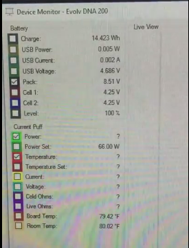

Spector NS5 RD Posted November 16, 2016 Report Posted November 16, 2016 here comes the obvious question, do you have 2 cell operation selected in EScribe AND uploaded to your mod? can you post a screenshot of device monitor?
Spector NS5 RD Posted November 17, 2016 Report Posted November 17, 2016 jtdien said: yes 2s and uploaded. Expand did this mod ever work (did you build it and have not been able to get it working)? is this a custom 3d printed sled? it looks like the the device is being solely powered by the USB. even though it is reading the cell voltages in device monitor, the batt contacts might be barely touching the ends of the batts and when it comes time to actually draw current from them to fire the atty, the sled contacts can be losing connection. post a screenshot of DM while trying to fire an atty. make sure pack and cells 1-2 are ticked. post an entire screenshot, graph included, of the DM window, not just the boxes to left. (are you familiar with the snipping tool to take screenshots?)

jtdien Posted November 23, 2016 Author Report Posted November 23, 2016 Thanks for the replies guys and sorry for the late reply on my side. Still on vacation in HI.this is my 4th 2s build on a p box, i've built a few other 2s boxes as well but this is the first time i ever came across this issue.Yes it is a 3d printed sled from modsledz and i never had an issue with them. maybe this time it is the connections on the sled but wasn't quite sure as escribe did show up proper volts.The chip was from a working reauleaux dna200.I'll take a screen shot of the power graph when i get back home in a couple of daysmuch appreciated in the responses!
