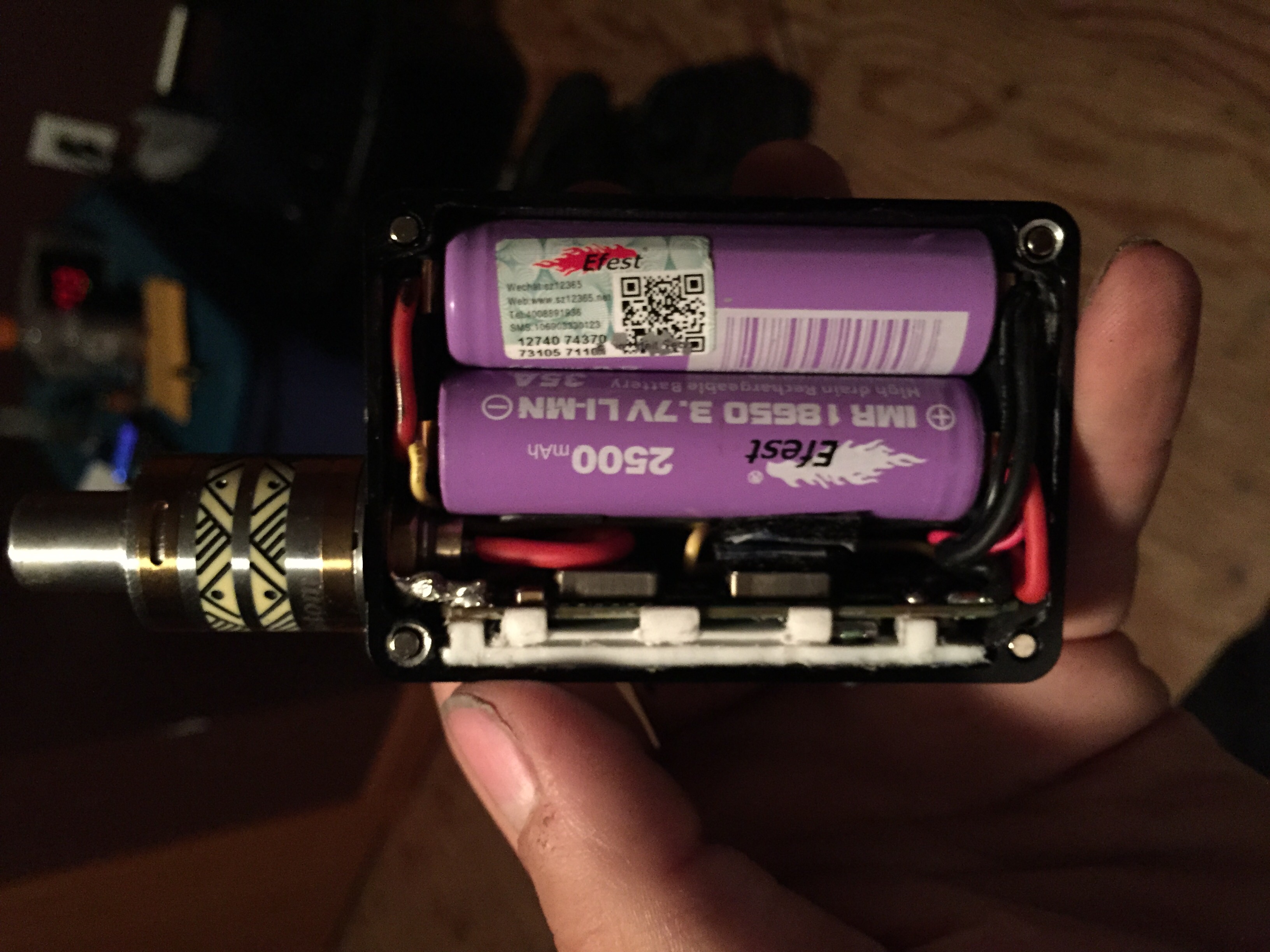

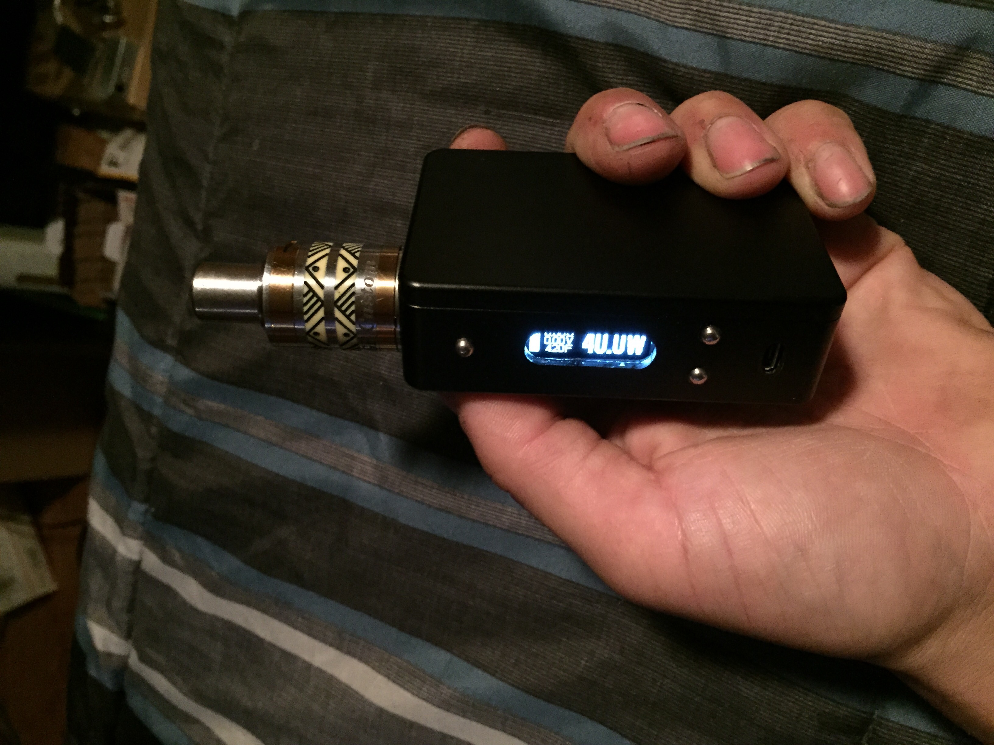

Ryry Posted August 17, 2015 Report Posted August 17, 2015 please help i hook it up right to the best of my knowledge! why is cell reading wrong ?and thank you
scoopy Posted August 17, 2015 Report Posted August 17, 2015 Ahh....do you have the battery fully hooked up or just the balance leads Do you have it set to 2s in escribe
Ryry Posted August 17, 2015 Report Posted August 17, 2015 yes i have it hook it all up and yes on the 2cell on escribe
Tomr1088 Posted August 17, 2015 Report Posted August 17, 2015 Same problem I had when I bridged pins 1 and 2 instead of 2 and 3. Only read 4.2 volts and would only turn on when I held the fire button or plugged it in. Prob an issue with balance connector wiring
Ryry Posted August 17, 2015 Report Posted August 17, 2015 i have pin 3 going to b+ 2 and 1 are bridged and gnd4 going to b-
blueridgedog Posted August 18, 2015 Report Posted August 18, 2015 Post 66 in this thread and those that follow give a correct diagram.
Tomr1088 Posted August 18, 2015 Report Posted August 18, 2015 Ryry said:is this how its supposed to go? Same mistake I made. 2 and three are bridged and go to battery positive. Pin one goes to the side where both batteries connect
