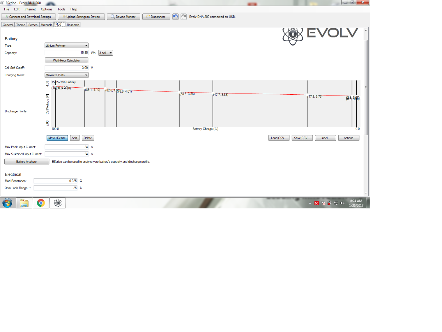

Hey all, just received my first DNA200 a few days ago and it's the Panzer Box by Think Vape.
Being new to the whole DNA200 scene, I started tinkering in escribe and made a few custom screens up, but that's about all I have really done so far.
The battery is supposed to be a 1500mAh 3S LiPo (SDL823562HP - 1500 mAh according to the manufacturer AD brand made by Shida Batteries) and the watt hours set by the manufacturer 15.  Using the calculator, it should be 16.65, but if I change it, my mod tells me that the battery is only 90% charged when each cell is @ 4.20V.  Any suggestions?
Secondly, the soft cut-off is set to 3.59V, this seems a bit high, so I changed it to 3.3V for now.
Thanks for any help available :)

best bet..........read through the threads here in this forum on the proper way to run battery analyzer, then run it at your avg vaping wattage and that'll give you an accurate batt meter and should charge to  100% most, if not all the time. mine charge to 100% after running the analyzer. also run case analyzer and do a mod resistance test (all of these tests are explained in this forum, do some reading, it'll help). all these analyzers are to make your dna board more accurate with the battery and the enclosure it came in.

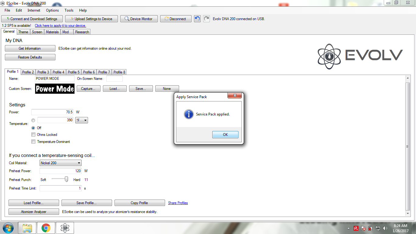

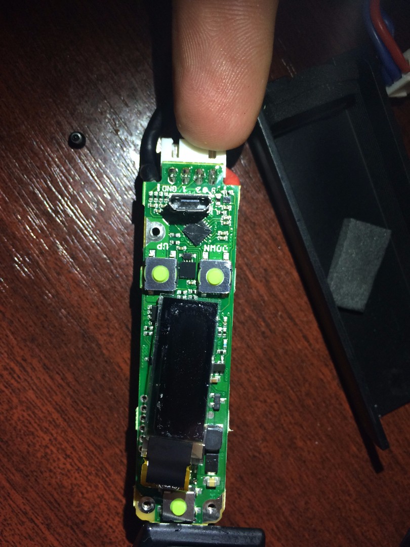

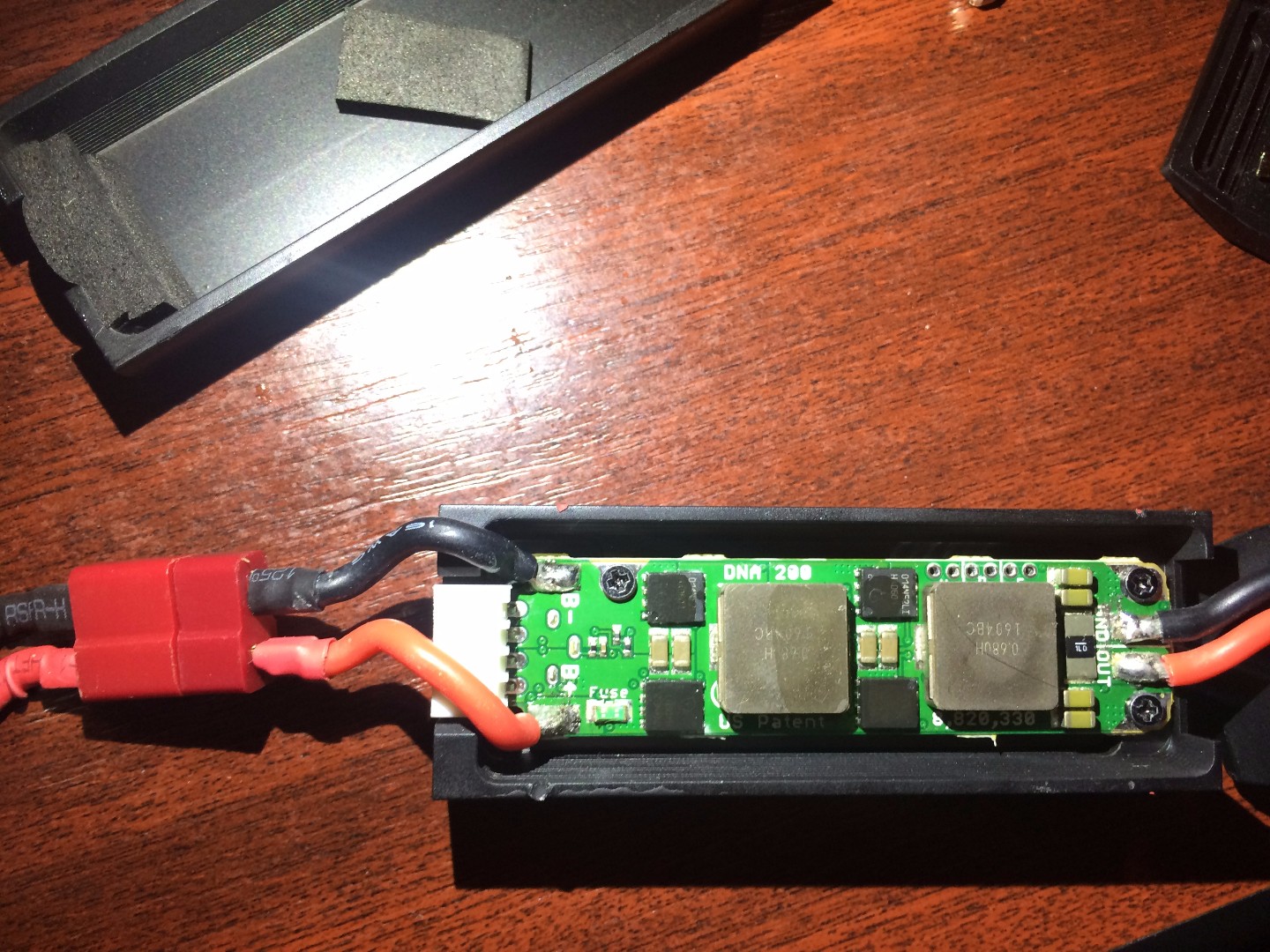

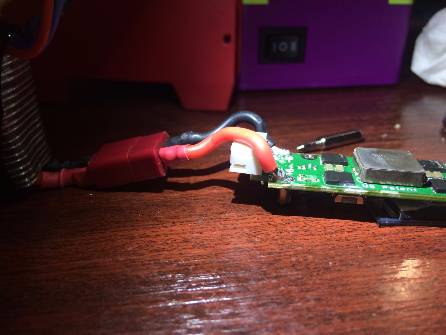

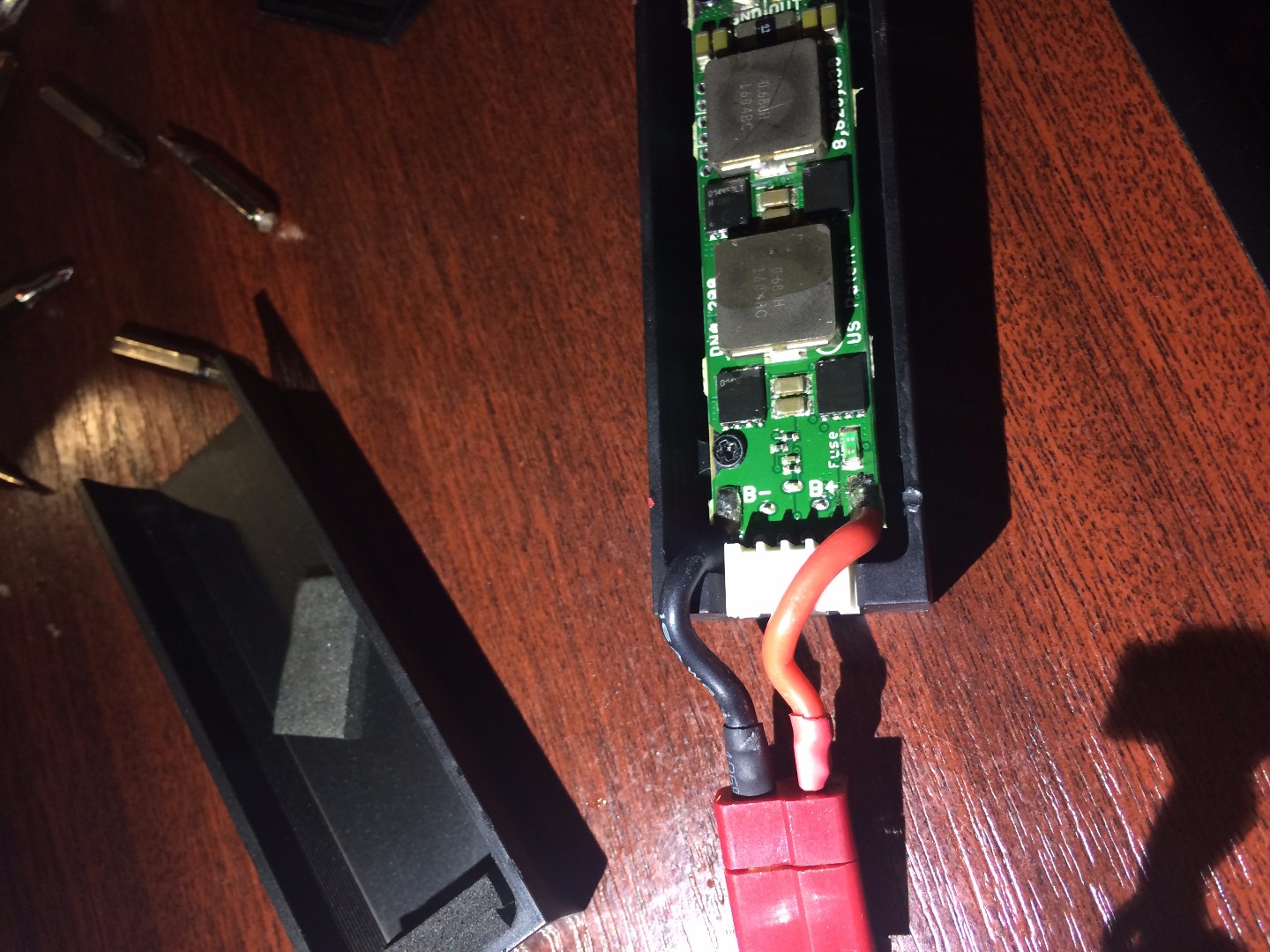

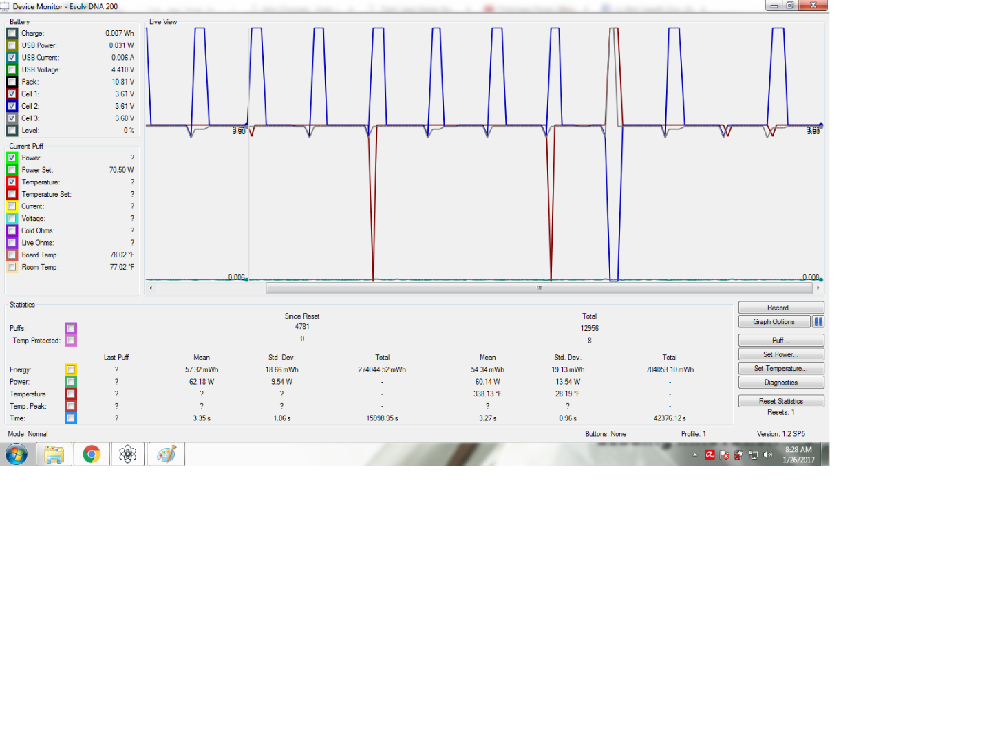

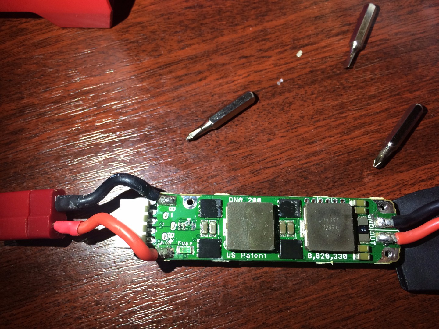

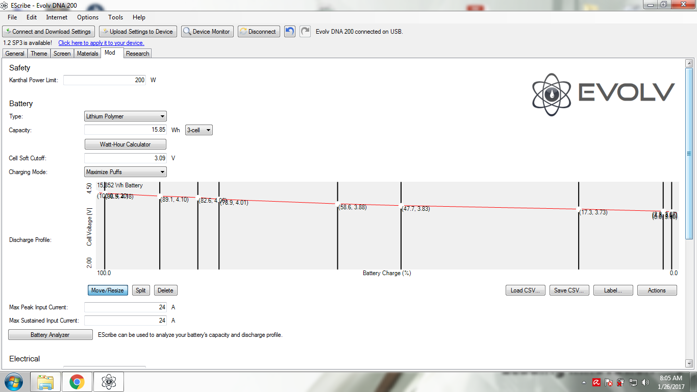

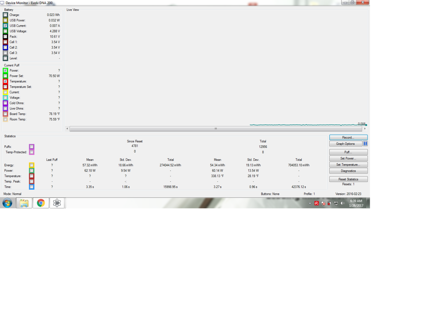

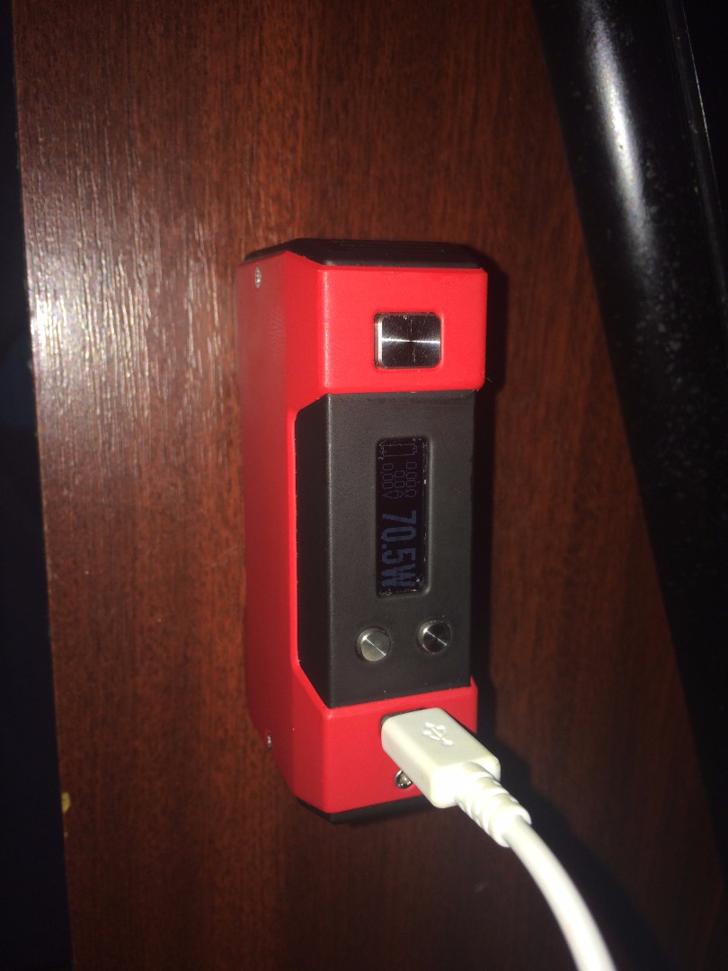

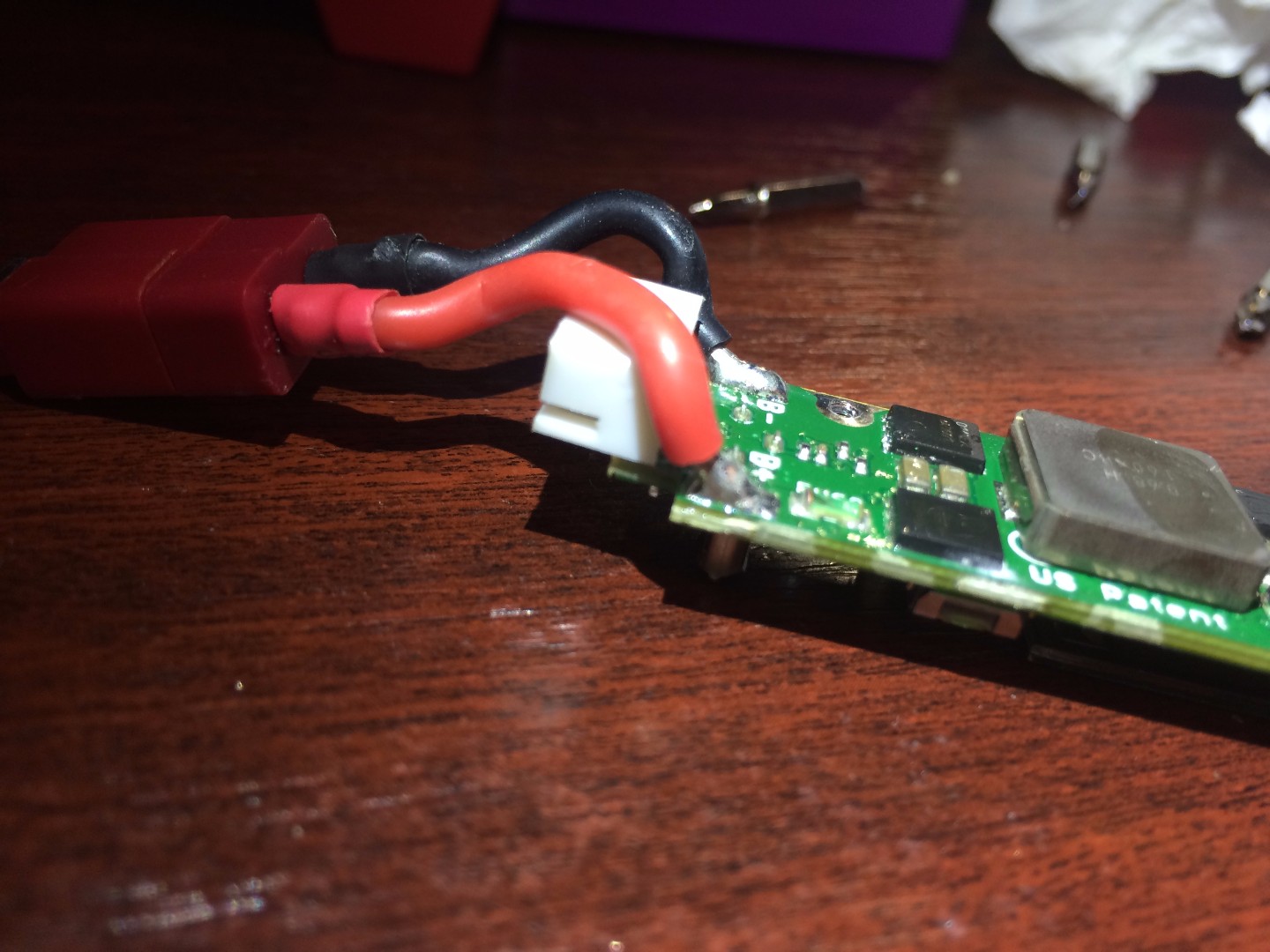

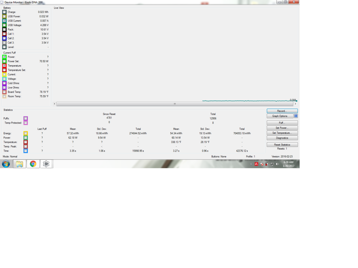

your pack is inline with the 3 cells. they also seem to be balanced. the lipo and fuse seem to be OK. will the device power on, even temporarily, if you HOLD DOWN the fire button (not just press and let go, hold the fire button in) and keep it held in? another thing to try, what happens if you plug in the USB charger and press the fire button? does the device display "check battery"? can you post a screenshot of your battery settings in EScribe?
what's happening is the mod, since it sees no battery, is dragging your laptop's USB voltage way down to the point of drawing too much power from the port when you try to fire the atty. basically it's trying to fire the atty by using the USB voltage instead of the battery. don't do that anymore or at least don't use your laptop as the USB power source.
looks like you're running very old firmware. try updating to EScribe 1.2 SP5. the link is at the bottom of this post, in my signature.

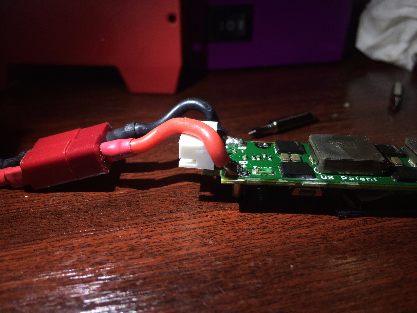

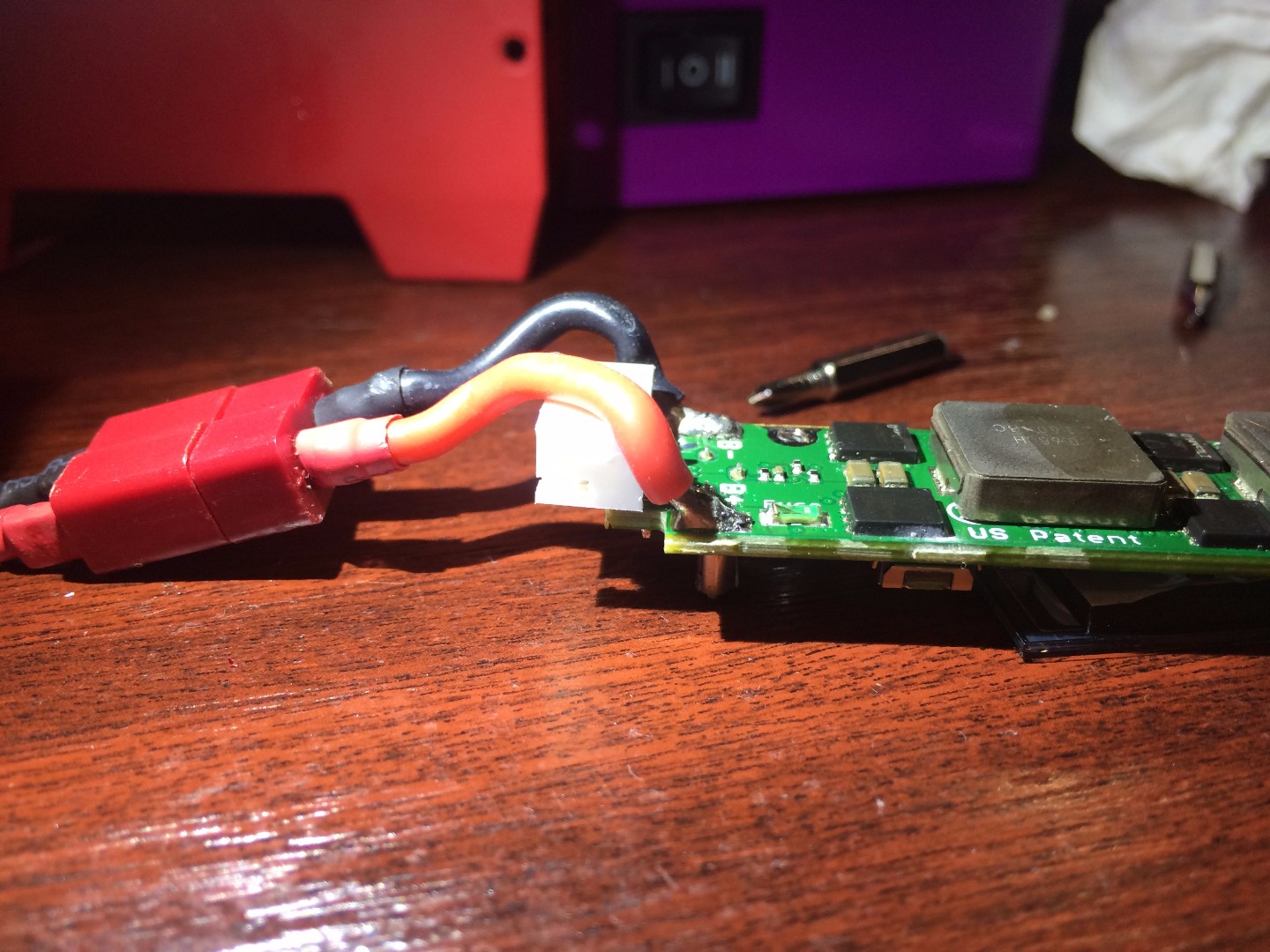

if that doesn't work, it could be the fuse. it's hard to tell from the picture but it does look like there is a little discoloration of the fuse.
in that case i would open a help ticket with evolv. that link is also located in my signature.
