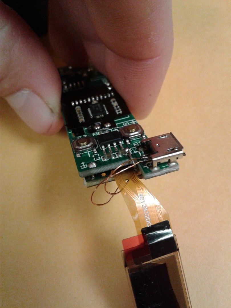

Rain Posted February 3, 2017 Author Report Posted February 3, 2017 This is how charger board in VF looks like. To be honest I don't have a clue where to look for USB pins
Spector NS5 RD Posted February 3, 2017 Report Posted February 3, 2017 Rain said:This is how charger board in VF looks like. To be honest I don't have a clue where to look for USB pins one board has the RBP buzzer and one of the two charging IC's. the other board, on top of that board, has the second charging IC and the battery leads soldered to it. you would need to de-solder these two boards from each other and take a look at the USB pin out. you're going to have to do what i did when i decided to keep my VS DNA 40 daughter board. here's a photo of what i had to do to the USB (your USB socket will look similar to mine, our daughter boards are different but that is irrelevant). i will also personally help you through this if you decide to go this route.
Rain Posted February 4, 2017 Author Report Posted February 4, 2017 thanks for pic, I will give it a go tomorrow
Rain Posted February 4, 2017 Author Report Posted February 4, 2017 ChunkyButt200 said: one board has the RBP buzzer and one of the two charging IC's. the other board, on top of that board, has the second charging IC and the battery leads soldered to it. you would need to de-solder these two boards from each other and take a look at the USB pin out. you're going to have to do what i did when i decided to keep my VS DNA 40 daughter board. here's a photo of what i had to do to the USB (your USB socket will look similar to mine, our daughter boards are different but that is irrelevant). i will also personally help you through this if you decide to go this route. I will manage to do it in the same way that you did.Did you use 10k ohm resistor?
Spector NS5 RD Posted February 5, 2017 Report Posted February 5, 2017 Rain said:I will manage to do it in the same way that you did.Did you use 10k ohm resistor?i did, i routed around my old circuit board collection and found one. they're a fairly common value resistor. the 10k res gets connected from #15 on the DNA 60 to the incoming 5v USB. so anywhere you can find 5v USB on either of your sandwhiched daughter boards.

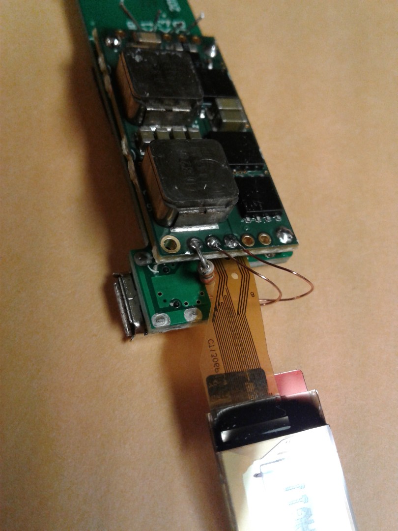

Rain Posted February 14, 2017 Author Report Posted February 14, 2017 and it is alive and working did forget to take pictures of internals, but I did the same as ChunkyButt200, everything else is quite straight forwardone pic of finished product 1
