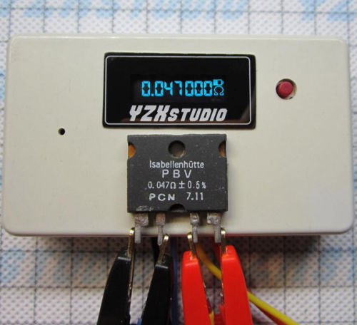

Bill, when I build a mod I am a firm believer that "bigger is better".  I always use the maximum wire sizes from the spec sheet, even though I rarely, if ever, go over 50 watts even with a DNA200.  My theory being that minimizing loss, and lowering impedance at the same time, can't hurt anything and may help.  We're dealing with very low resistances at firly high power/current and every little bit shaved can make a significant difference, at both the supply and output sides.  Just my semi-educmacated, (im)practical experiences anyway.  I just wish I had a meter that resolved down to .0001, or lower, ohms so I could see the fruits of my efforts.
