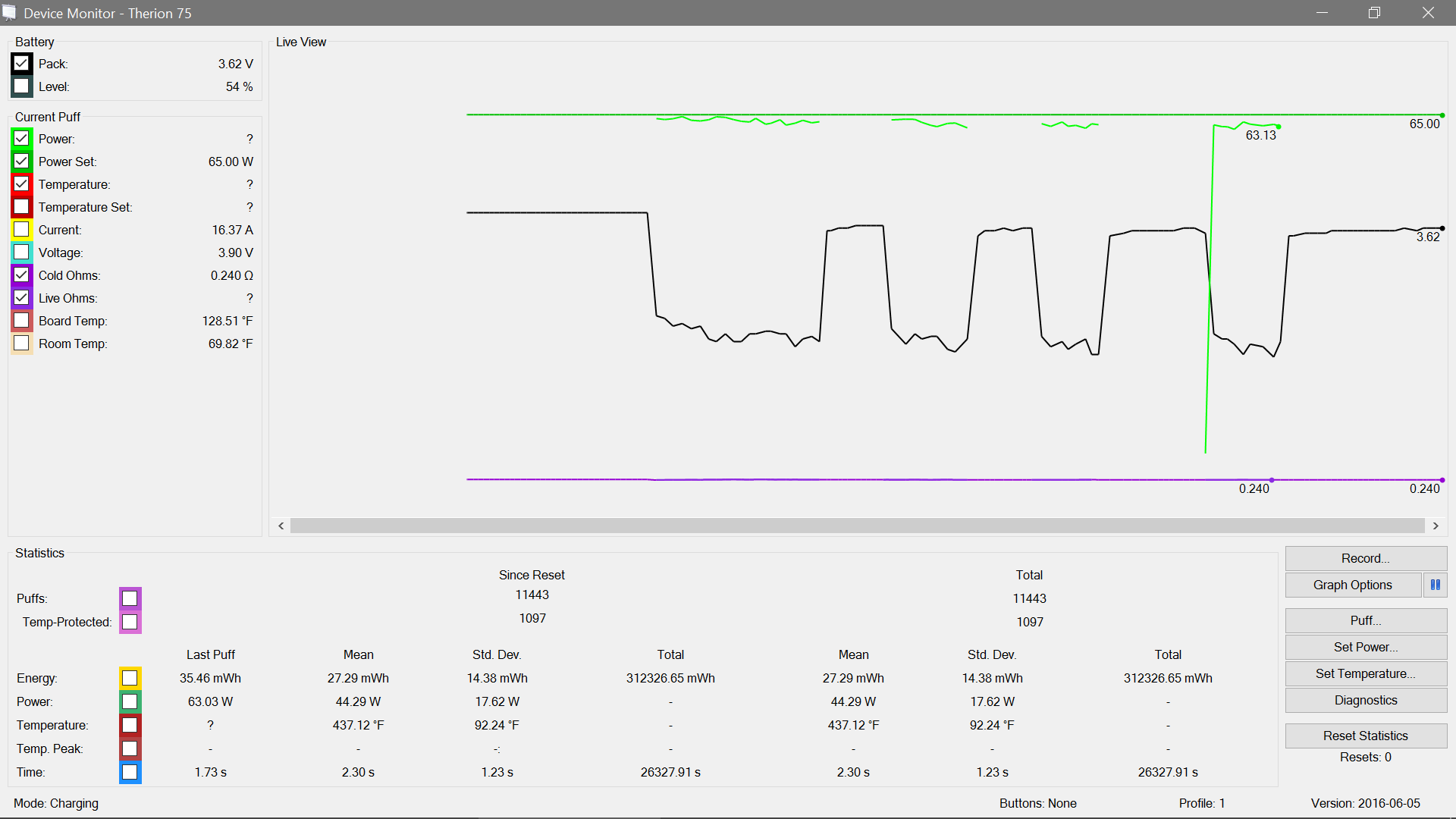

The battery indicator flashing is the 'Check Battery' message...Can you post a screen shot of 'Device Monitor' in Escribe & of the 'Mod' tab?
Edit: Device Monitor screen shot while firing the device...check 'Pack', 'Power' , 'Power Set' , 'Cold Ohms' , 'Live Ohms'
