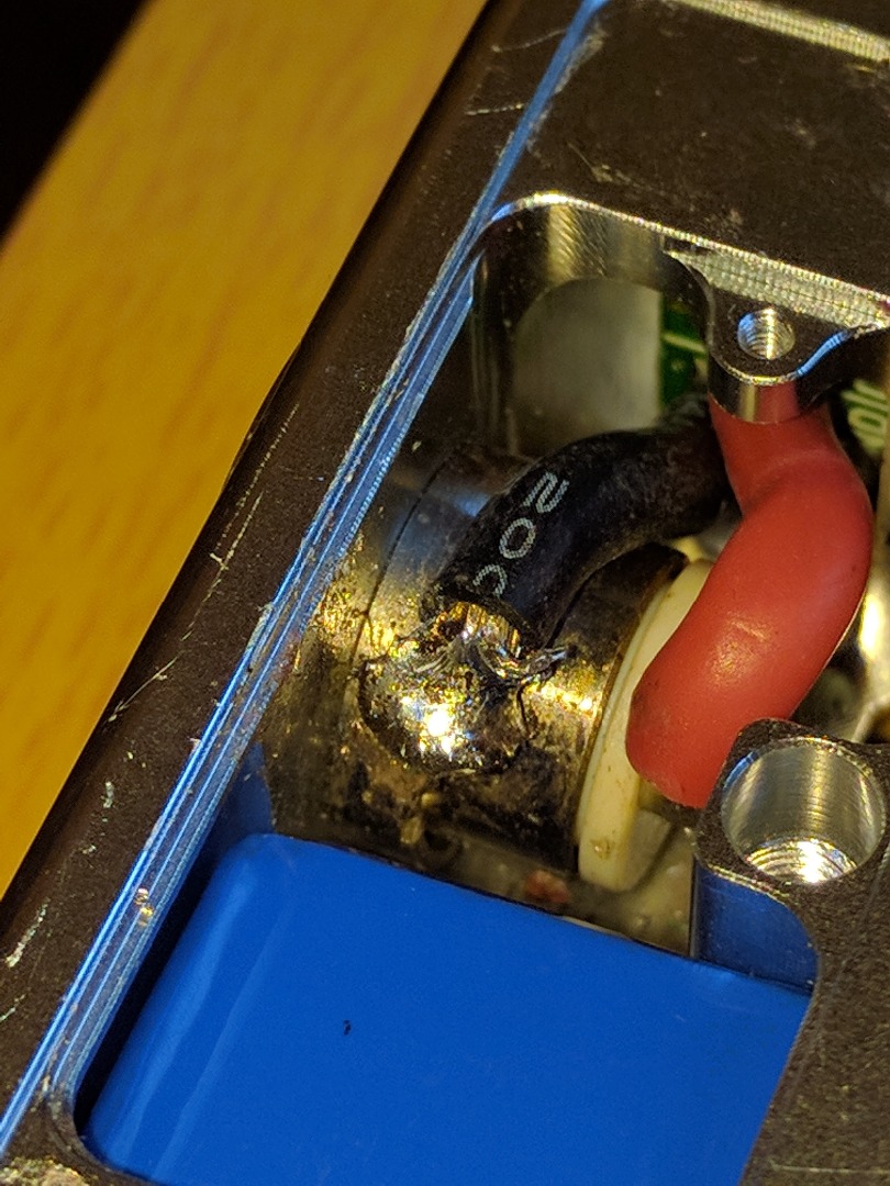

ill attach some pictures ive just got of the board posts and 510.
While im using the SP3 readings are literally jumping from ? to the coil effective resistance, every second i have a different value, like ? .075 .150 ? .298 etc etc
PS: 510 is fine, atty as well, no trace of fabric debris!

retird said:

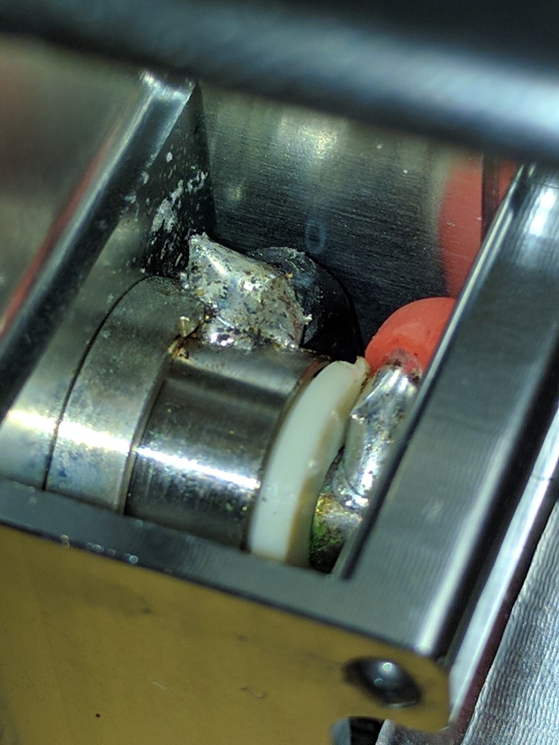

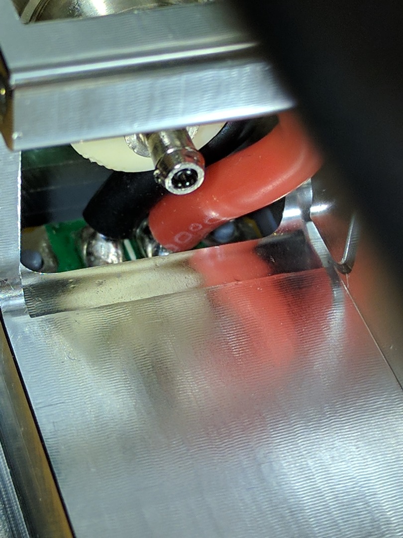

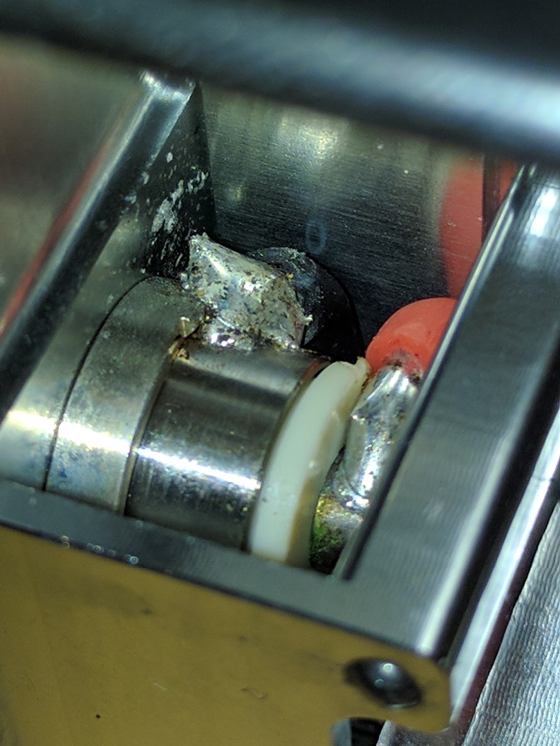

Been following this conversation and from the picture of the 510 it seems there may be a cold solder at the 510 to chassis.  I know pictures may deceive.... firmware seems unlikely to me at this point...
This is what I'm thinking as well, just asked to a guy on fb to send me a picture of his one. I don't have any clue regarding how to disassembly the box and get access to the 510. So I think I won't be able to do that so...
edit: found it, had to remove the carbon fibre and there is a little slot to give access to the 510, soon ill try to solder both.
but still i cant understand how is possible that this firmware is giving problems while the old one is perfectly fine and stable...
Edit2: tested with a multimeter the 510, from the ground post to the outer 510 solder is fine, but the upper ring (chassis part) is not coming out at 0 with the 510. Tomorrow I'll solder it again... Hope is gonna work...
edit3: before re solder the ground i decided to check if that was the problem, put a little wire between the chassis and the ground 510... and... rock stable after 2 hours of idle! tomorrow morning ill get the confirm if that was the problem so i will proceed to re solder it, but ATM im quite sure about this. Thanks @retird for point me out on that!
edit4: no way, found her this morning jumping between ohms as always, ill try to solder it any way...
