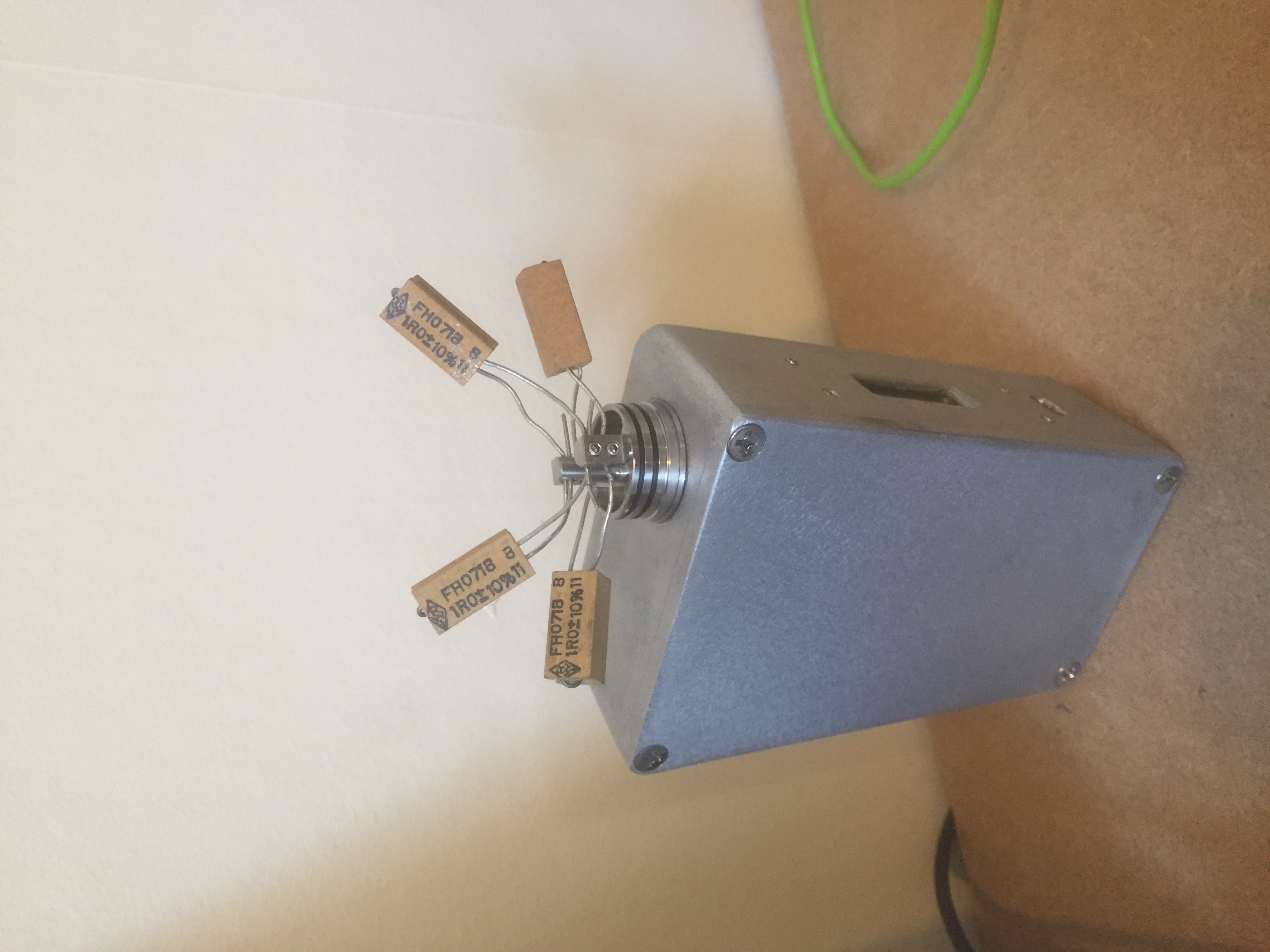

mikepetro Posted October 4, 2015 Report Posted October 4, 2015 How long depends on what wattage. Only running the one resistor I wouldnt go above 40w. I dont have any experience running at that wattage. Testing a 1300mAh at 100w took about an hour all said and done.BTW, are you sure your resistor is 100W? Those big ones in my photos are only 50W.

lewisss Posted October 4, 2015 Report Posted October 4, 2015 This is what I use for the battery analyser. (No "z" in the uk) Got a mixed pack of power resistors from maplin and used 4x 1 ohm into a velocity deck, 2200mah takes over 2 hours at 40w

Rune Posted October 22, 2015 Report Posted October 22, 2015 I have a Lavabox and set mine in Escribe to 9.9 as per the wattage calculator for the battery. I'm not convinced it's correct though as I'm getting weak battery at around 50%. I have a Velocity so if I get 4 wirewound 10W 1 Ohm resistors and put one end in each post hole and tighten in place, and run the test at 40W that should be okay?

bingbling Posted October 22, 2015 Author Report Posted October 22, 2015 Rune said:I have a Lavabox and set mine in Escribe to 9.9 as per the wattage calculator for the battery. I'm not convinced it's correct though as I'm getting weak battery at around 50%. I have a Velocity so if I get 4 wirewound 10W 1 Ohm resistors and put one end in each post hole and tighten in place, and run the test at 40W that should be okay?I am not very eletricity-savvy but to me it sounds like cutting it close. I think you need either resistors that arer made to withstand high effect, or some kind of cooling to take the heat of the resistor. I did it the easy way, just make a giant spaced coil with long leads of 24awg kanthal. I did go overboard on the laps tho haha. So no need to make it as high as I did (3,4 ohm). During the test at 40W the wires barely got warm.
