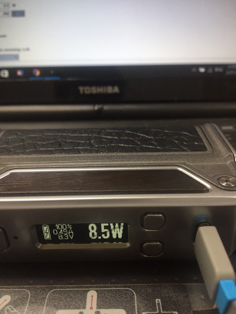

Sovan Posted February 21, 2017 Report Posted February 21, 2017 I would also like to get the .csv file for 2x LG HG2 18650 noting that im using lost vape DNA133. whats the best configuration do you recommend me for batteries i currently changed the watt hour to 22.2, cutoff to 2.8 , charging mode to maximize puffs. Is that correct? Could anyone help and where I should load it on escribe app ? Also, is there a way to connect to escribe without charging? As example to remove the batteries from mod? To not charge and discharge everytime i need to change the settings.
giz_60 Posted February 21, 2017 Report Posted February 21, 2017 Here is the .csv file for 2 LG HG2's.... LG_HG2 (2)_18650_3000 mah_17.43 Wh.csv Settings as such:Wh=17.43CSC=2.8Maximum puffsWhy are you wanting to turn off USB charging?Edit: Download the .csv file & remember where you downloaded it to...Go to 'Mod' tab...Load CSV...choose file you just downloaded... 1
Sovan Posted February 21, 2017 Report Posted February 21, 2017 Thanks alot giz_60! rly appreciate your help! I gonna try your file and back to you if i had any issues about turning off usb charging to not charge and discharge everytime i need to change the settings i believe it would effect on battery life ?
giz_60 Posted February 21, 2017 Report Posted February 21, 2017 USB charging should not effect the battery life, but if you want to disable it...Device Monitor>Diagnostics>Set USB Current Limit...enter a value of '0'...you can always turn it back on again by choosing 'Reset USB Current Limit'
Sovan Posted February 21, 2017 Report Posted February 21, 2017 I just loaded the file and changed the watt hour to 17.43 ( calculator shows 22.2) seems it works great as I noticed the battery percentage shows correctly now! Thanks again mate.
giz_60 Posted February 21, 2017 Report Posted February 21, 2017 I have found that the Wh calculators almost always over calculate the value...can only get the true value by running the battery analyzer...glad it's working better for ya now...

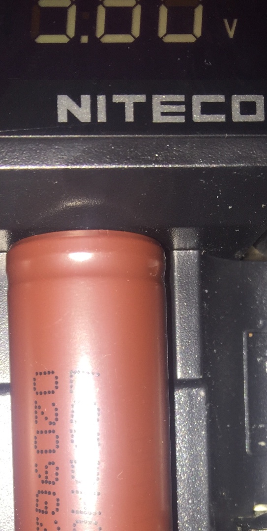

Sovan Posted February 21, 2017 Report Posted February 21, 2017 Is that serial "0209G**** for my HG2 batteries looks normal to you ? as most (not all) of pictures i checked online start with characters but mine start with numbers!
giz_60 Posted February 21, 2017 Report Posted February 21, 2017 Mine starts with an 033...bought mine through IMR Batteries
Sovan Posted February 21, 2017 Report Posted February 21, 2017 Did you try to check the production date of your batteries on batterybro tool ? https://batterybro.com/pages/18650-date-code-lookup-toolafter checking with fourth characters from my serial starting w/ G not the first ones as they asking! mine has an old date 2007.
giz_60 Posted February 21, 2017 Report Posted February 21, 2017 Nov. 2015...that first character should be an 'O' not '0'...
Sovan Posted February 21, 2017 Report Posted February 21, 2017 giz_60 said:Nov. 2015...that first character should be an 'O' not '0'... So mine should start with "o" not zero! Damm that means its w/ July 2015 not 2007 but it looks like a zero! Are you sure?
giz_60 Posted February 21, 2017 Report Posted February 21, 2017 Pretty sure...LG HG2's weren't produced until 2014...it fooled me too until I put on a pair of cheaters to read it better...
Sovan Posted February 21, 2017 Report Posted February 21, 2017 giz_60 said:Pretty sure...LG HG2's weren't produced until 2014...it fooled me too until I put on a pair of cheaters to read it better... So it's not a fake serial I thought that i brought an old batteries and the dealer cheated me :lol was rly disappointed as I bought them from Dubai lol but if you checked my below picture you gonna see no difference between o and zero! This is weird! thanks again dude! You made my day better!
