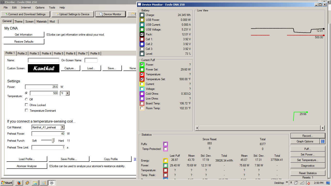

Froggyc Posted February 14, 2017 Report Share Posted February 14, 2017 I have the same problem too, i upload the profile to device, and there was no preheat. I checked it on device monitor, could you help please? Link to comment Share on other sites More sharing options...

giz_60 Posted February 14, 2017 Report Share Posted February 14, 2017 What kind of atomizer are you using? Are you building coils or using pre-built? Link to comment Share on other sites More sharing options...
Froggyc Posted February 14, 2017 Report Share Posted February 14, 2017 giz_60 said:What kind of atomizer are you using? Are you building coils or using pre-built?superclapton coils 0,3 ohm together (0,6 single) in ijoy combo, i want 75w preheat and after 35w Link to comment Share on other sites More sharing options...
Froggyc Posted February 14, 2017 Report Share Posted February 14, 2017 giz_60 said: Your not pre-heating to a wattage, but to a temperature. The Kanthal preheat cheat is not a plug & play method, because Kanthal is NOT a TC wire...hence the cheat. You will have to play around with the settings...cold ohms, temp, etc....to figure out what works with your setup! i locked ohms and it works, thanks. Link to comment Share on other sites More sharing options...
