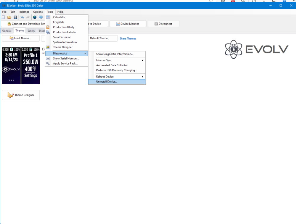

mystery solved itself , after applying the service pack 3 times. gave up hope, took the batteries out ready to have it returned to the shop. I've got up in the middle of the night and had a drink and i thought i will just give this another go and it connected to escribe straight away. I'm wondering if its a funny chip i have because i had to reload the service pack a coupe of days ago when it wouldn't upload a theme. i have 2 mods exactly the same model, one in silver and one in gun metal. the silver one now I've had issue twice and i do exactly the same on the device as i do on the gun metal one regard's to setup and themes. this is where uninstall device is located and thanks for helping much appreciated. -

i didn't have the option reload firmware but apply service pack , so i did the recommend one and it accepted it and loaded it , its still saying device in use after that i tried the previous service pack , accepted it but still device in use message. I've looked in to all the options on the theme and i did notice time out was about 600 minutes. so i brought it down to 1 minutes waited 5 minutes and still no joy. what would uninstalled device do in escribe ? -
