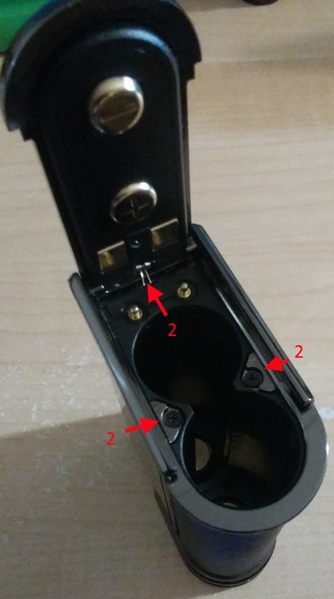

It's in no way as involved as a laptop screen, those things need to be built for rigidity (and I've seen more than one fail because they weren't or worse the hinges were badly thought out.) Worst case there is some double sided tape holding the screen to the frame but IIRC it's just some tape strips down the two side and once you lift those and the screen/glass itself you might even have access to the connector and not even need to get the supporting frame out. I'd have to open it up again myself to be 100% certain as when I've gone in it wasn't to get access to the board at all, but every build I've seen around these screens has been more or less "tape it to a frame" or "put something behind it to hold it into a frame" and in paranormal 250c's case it's definitely resting on top of the frame.
Not much further, the screen is sitting in a tray and you'd probably have to figure out how to get that tray out to get at the connector.

First, take out your batteries. Take out 2 phillips screws by battery door hinge at the bottom front of the mod (marked as 1), remove the battery door. Under the battery door is 1 screw, then 2 more between the batteries (marked as 2, though one of them is under the battery door). Once these 3 screws are out with some gentle pressure the bottom of the mod just pops off directly down. Take out the 3 screws around the 510 connector, and the 2 screws on either side of the frame on the opposite end of the two for the battery door (marked as 3). Once the bottom is off and those other 5 screws are out, you can grab that front panel part down below the usb port (marked as 4) and pop it forward and up. This gives you access to the buttons and piece I was taking photos of previously.
