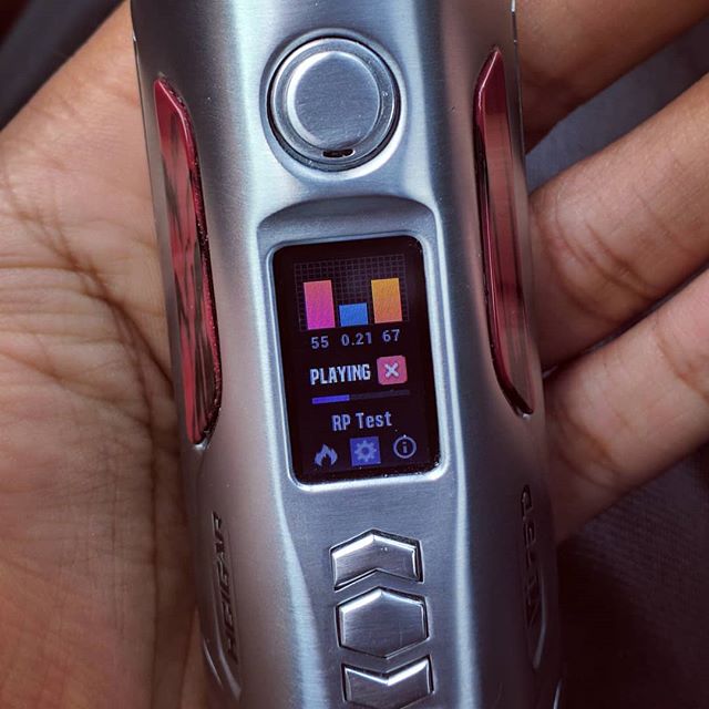

    That's strange. I'm also on 75c. Can you fire and watch the screen instead of taking a puff? It should update.
  4. @BlindBuck That looks great man! May be you can make the play button wider, to take up the empty space? The icons have to be a little horizontally squished otherwise they appear vertically squished on the mod.
