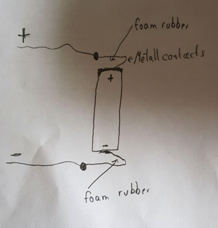

We already did the same (german community) - bend the contacts and filled up the gaps in between the contacts with foam rubber - with great results - But to say it clear - best way would be to exchange the shitty contacts! Mine (boxer DNA133 - self made kit) working pretty fine in TC Mode - down to 3 Percent of batt power!

But not that easy to modify...........i wish they´d used better bat contacts ....... did not find any replacements for the contacts.....
- 29 replies
@EDMKEV I´m pretty sure that every material that gives enough force will work - i´d recommended foam rubber because it works like a spring - i´m sure you´ll find something similar - for security reasons non conductive ;-)
- 29 replies
@EDMKEV Try to attach some foam rubber to the bat contacts - right there where the metal is bended ----- it´s not recommended to bend the contacts more open - putting foam rubber into the bending point gives much more mechanical force
