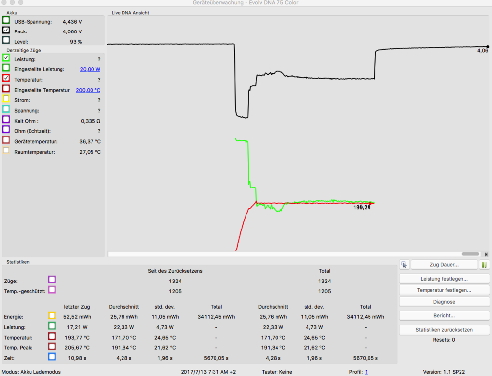

I´m using a Clapton Coil V2A - 0,37 Ohm - on all other DNA´s reading 0,37 cold - working fine on TC on all my DNA´s - to have the same vape experience i´ve to set it to 0.335 Ohm on the DNA75C A bit far from accurate......... Just to show some Numbers! But with manually set to this data TC working like a charm

Yes - sometimes (after felling to sleep) the 75C not working in Temp Mode Workaround 2 or 3 Times pressing firebutton short - TC coming back I can see it in my Theme because i´ve set the Temp reading to live view - If my dest Temp is set to 210°C - firing - Temp digits are going blank (because there´s no temp reading) - after 2 or 3 Times short firing live temp is coming back!
