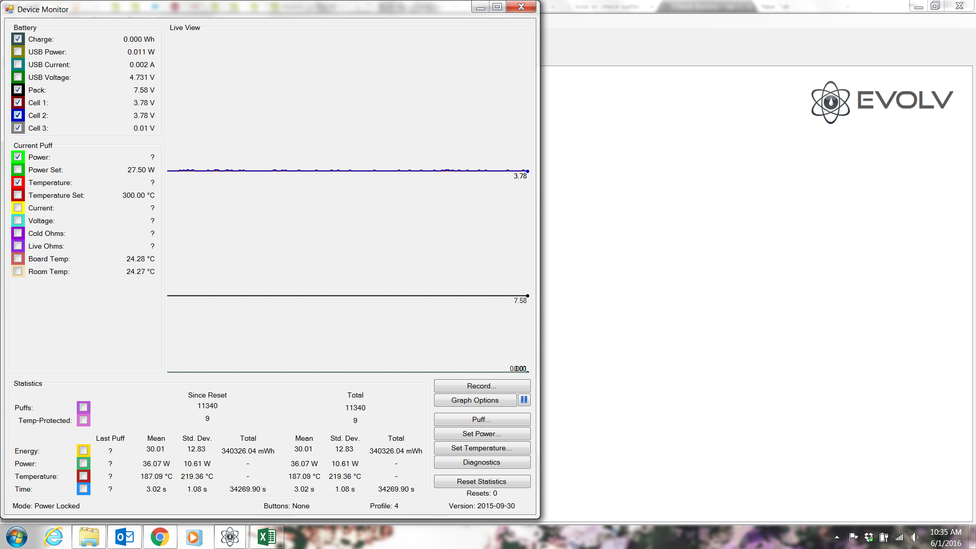

Guys I have encountered a Warranty Service error on not 1 but both my DNA 200 mods (Lavabox & HCigar VT 200) at the same time. Previously it was already indicating but nothing severe. I even connect to Escribe prior to check if it was a firmware issue but it isn't. Now both my mods are not able to charge and it is worrying especially when both uses the 3 cell lipo battery pack. Kindly advise.
Tried a hard reboot but to no avail too.... I believe it could be like what you guys are saying, a bad lipo or joint issue. If anyone has other solutions, I would be glad to try it out too while I resolve this issue with the vendors.
