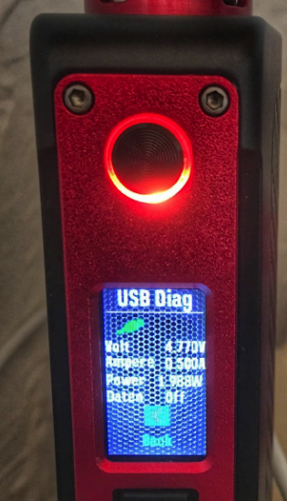

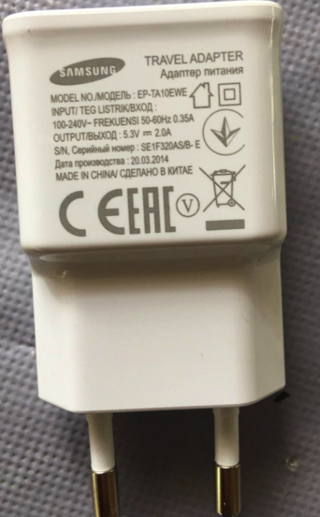

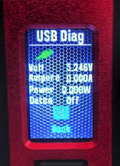

I think i´ve sorted out a possible USB Charging problem The 2Amp charger delivering 5,246 V output current - i have exactly the same charger mine delivering 5,02 V Specification for max USB Voltage is afaik 5,250 V - so i think that you´ve Programmed a max USB voltage somehow?! So as you can see - 2 identical chargers giving 2 different output currents - you´ll never know what you get ;-) But anyway i´ve attached pictures x1 Charging with a 500ma Charger - Charging with the non working charger - the non working charger - all Pictures taken with firmware sp23 - with sp21 Charger is working! Regards Mikel -
