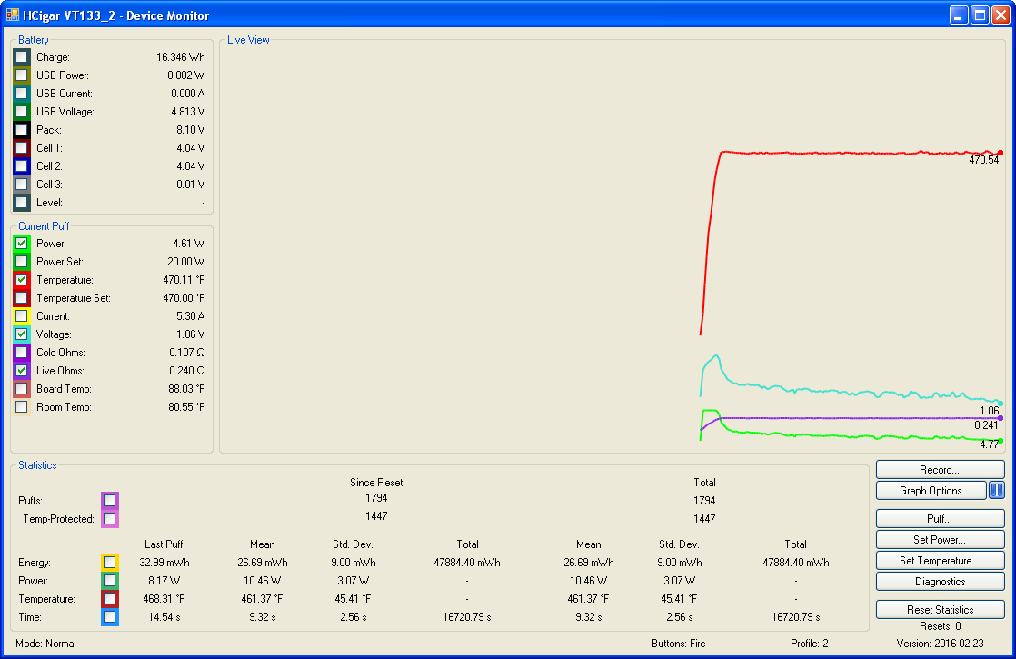

@ChunkyButt200: I really appreciate your reply. Yes I have heard others speak about the RBA not reaching down far enough to make a good connection. So solder sticks to SS? Yes this could be the whole problem for sure. Although I would also expect to see this in the resistance. I do have an odd resistance thing going on that I had seen with the old build too. That is overnight it was sitting for 9 hours and the VT133_3 should see it as 0.11 ohm. But it saw it as 0.17 ohm. And it didn't pulse this time. But the wattage stayed pegged, the volts was higher than it should, and the temperature was struggling to get to 470ºF, which it never got to. Here is the screen shot. It acts like some of the power was going somewhere else, besides the coil. But the resistance is showing it is just higher than normal. But not that bad to explain the voltage, power, and low temperature readings. Oh John said cell 3 should read something with two cells? That is odd since all of the wiring diagrams I have seen shows the balance connection pins 2 and 3 are shorted (only TV133_1 shows some voltage while my others show nil). And that is where cell 3 voltage is read from. @VapingBad: I really appreciate your reply. Yes that is a 0.11 ohm Ni200 coil in the first two. But I was moving it from mod to mod and yes it was warm. Only VT133_1 and VT133_3 did it act up on. Everything else I tried the Black Crown ran flawlessly. As I mentioned to CB above, after sitting all night, my VT133_3 read it as 0.17 ohm which it should be 0.11. It didn't pulse this time, but the voltage went to 2.4v and the wattage pegged and even at those settings and even at 0.17 ohms cold, it should have easily reached 470ºF. I am currently running that same coil (Black Crown) on my VT133_2 which I had never seen it act up at all (or my other mods). Oh I am not seeing it hit the voltage limit at anytime. From all of these shots, 2.4v is the highest it has gone. But when I see it again, I'll record the data and see what it says. @black lace: I really appreciate your reply. Although it is acting very much like sudden resistance increases. Although the Device Monitor shows it very stable. Maybe the sampling rate is just too slow to show it. I have four scopes here. Although to use them I would have to disassemble a mod or atty to get to the connections. Either that or build a 510 breaker box which I have been thinking of for sometime now. And yes, I am using a 0.4mm plastic washer. Tried it without too. @All: I have been running this Crown on my VT133_2 which it never acted up on. I just watching it carefully just to make sure it isn't going to mess up on this one.

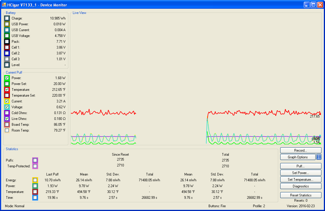

I am trying to figure this one out and I don't get it. I have two Crowns w/RBA and I use 28g Ni200 with them. I haven't checked the other one, but my black Crown I am having problems with HCigar VT133 #1 and #3. My second VT133 is fine as well as my Reuleaux DNA200s with this Crown (as well as other non-DNA mods). I just rebuilt it since I was having the same problem. The first image shows it is working normally on #3 and then starts to pulse (voltage and current). The second image is on #1 and it starts out good again (it isn't shown) and then pulses too, but not as bad as #3. Last image is a totally different tank on #1 and everything is normal. The temperature is purposely set low for first two images because I was moving that hot coil from device to device. Right now it is at room temperature and it is reading 0.1133 ohms. #1 will show cell 3 (VT133 are two cell mods) from 0.5v to 1.2v and kind of floats around. I never found it affect anything so I never investigated why it reads something there. My Profile 2 is my Ni200 Profile on all of my DNAs.
