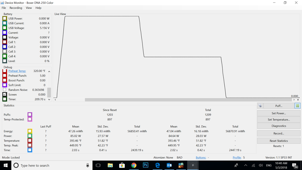

Since my display quit working this morning, I ran Device Monitor in Debugging mode, looking at "Screen" monitor, but I'm not sure what to expect from it. It looks like this. Note: The batteries are removed. It's an old habit of mine. I don't USB charge DNA and I remove batteries when connect to Escribe. I had unfortunate experience in the past with DNA200.
