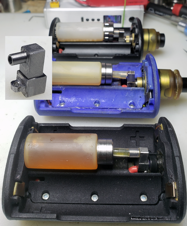

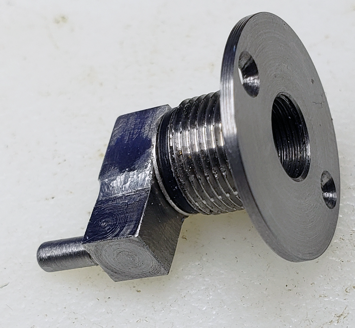

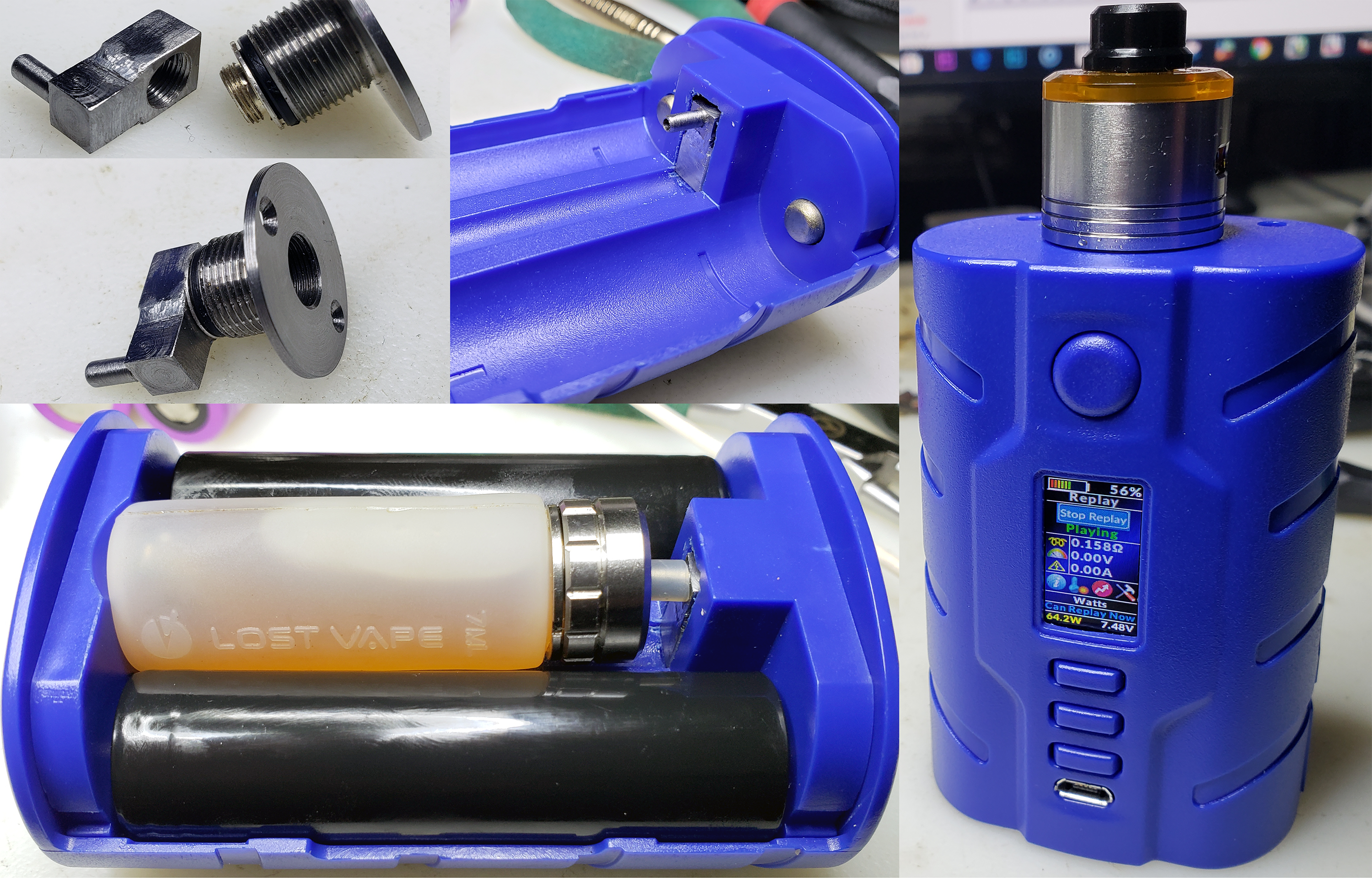

joevapes3@, right. That Chinese connector, in the link above, I advice strongly against. It's more convenient, because it is threaded M10 and it fits perfectly, but it leaks. At least mine does. As far as the length of MM510, that I used, it was perfect. Only diameter of it is 12mm and I had to ream the hole wider, as well as the place where the nut rests, because M12 nut is bigger. How do I make those "Elbow Adapters"? The old faction way, using my lathe and mill. 😀 It consists of two parts, press fit, one into the other. Turned in four jaw chuck. On this one, I went fancy and milled a wire soldering tab. It doesn't look like much, but believe me, it is a lot of work. Made out of 304 Stainless Steel. This one here, it looks like both pieces are welded together. They are not. They are still press fit. But I thought it would look better if I soldered them together to make them smoother looking.

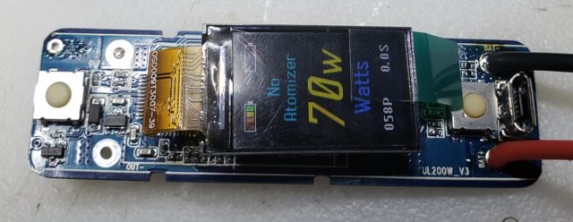

joevapes3@, cool mod, I can see right through it. 1) For the connector: I use MM510, I just don't remember which version though. I think THIS ONE. That Chinese connector, that I used first, started to leak in a couple of weeks. 2) Displays are identical, the one DNA250C and SXK chip. I swapped them out several times, they work. Here is my photo of SXK chip and DNA250C display working together.

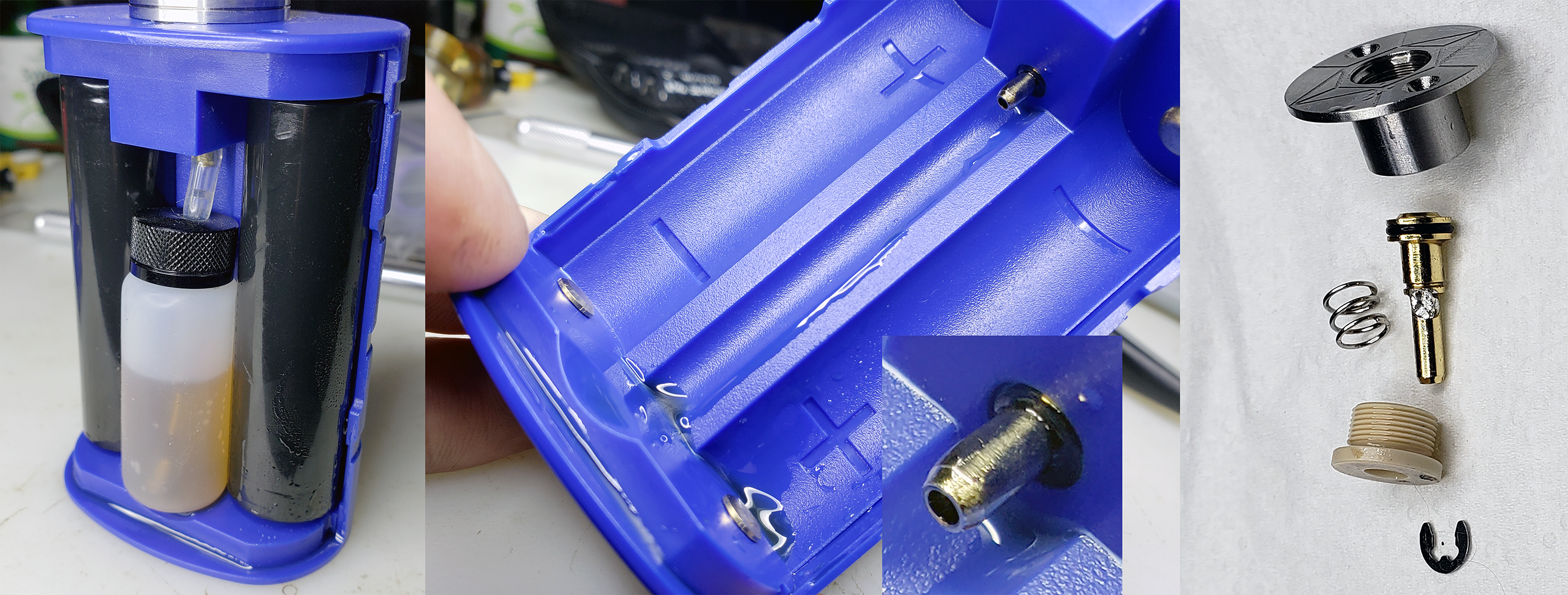

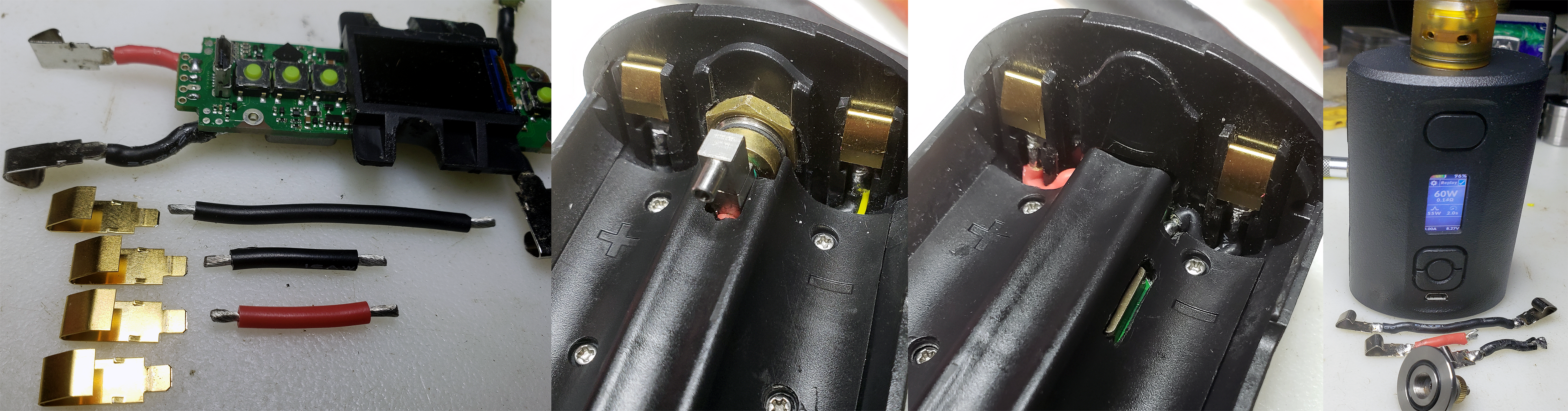

These contacts are very important. For example: SXK Boxer clone, uses similar contacts, but they are made out of nickel plated carbon steel. As the result, every once in a while, the mod refuses to power up. I got tired of it and replaced them with gold plated beryllium copper contacts, that I pulled out of KeyStone 1048 model They are much better. -

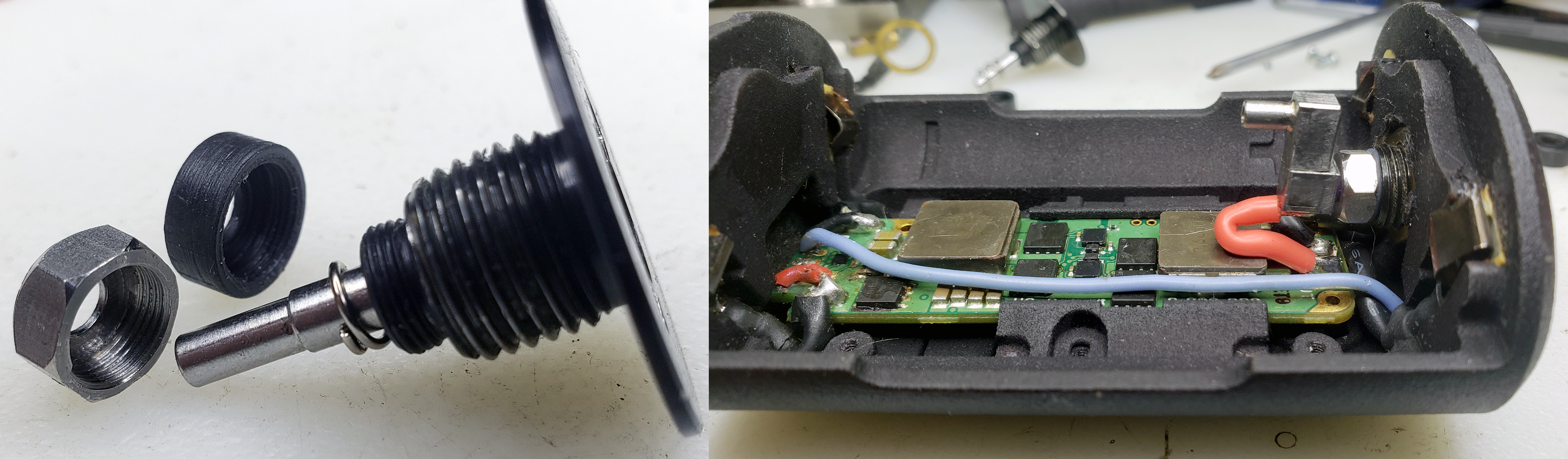

Another dual battery DNA250C squonker from China, called VapeCige VTX200. This one started leaking like a sieve after one week. Because they used very primitive 510 connector. In this one, I had to use an Italian silver plated connector ModDog, I just had to machine it to fit and drill two holes. I also made a stainless steel offset elbow.
joevapes3@gmail.com, Good job! I noticed you are using THIS Chinese connector? I hate to be the one to bring you the bad new. I used this connector in my SXK Boxer clone (with DNA250C) too. It lasted for about a month and started leaking. I replaced O-Rings and bought me yet a couple of weeks, before it started leaking again. It turns out that this connector is the royal piece of you know what. I ended up replacing it with my trusty English MM510 connector. No more leaks. Also, the battery contacts, of SXK Boxer, are made out of nickel plated carbon steel and loose contact with batteries every once in a while. I cleaned them, brushed them, bent them out and still, every once in a wile, the unit refused to power up. I got tired of it and replaced them with gold plated beryllium copper contacts, that I pulled from KeyStone battery holder. So far - so good. I suggest you do the same.

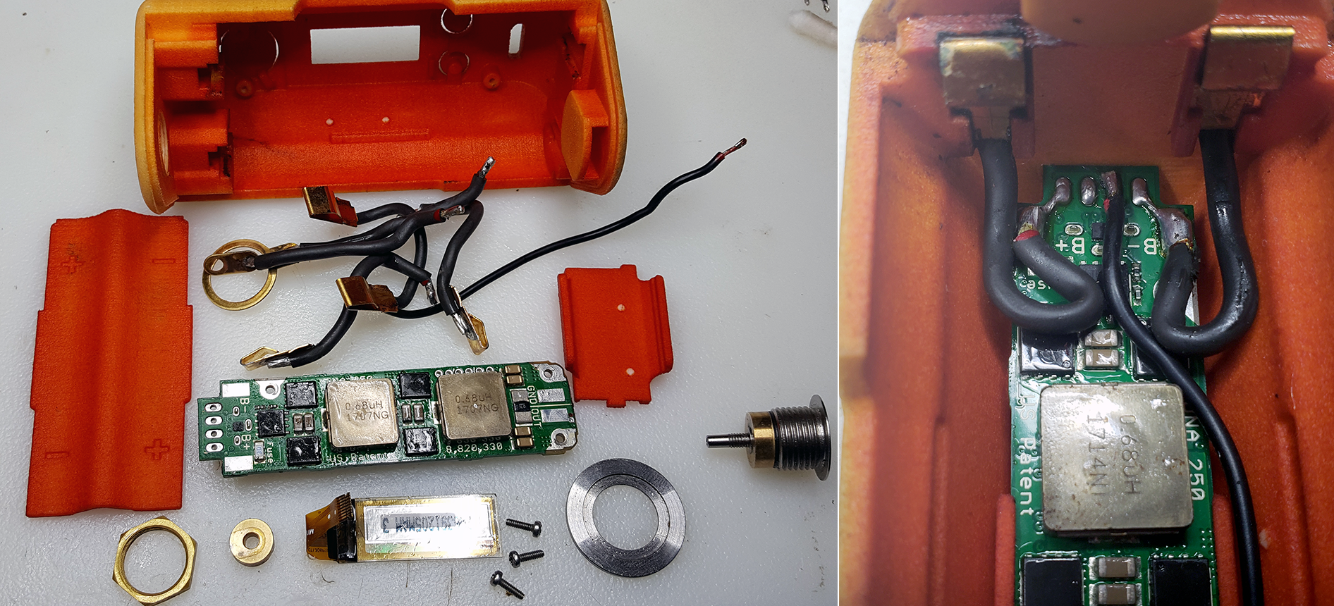

This one ( in the picture above) is the original Ginger Vaper Boxer. You could tell by how matte the finish looks, because it is 3-D printed. I just made and installed a stainless steel offset elbow adapter, just like the one in SXK Boxer clone, only not chromed brass, like they used. It is much better that way, no need to bend the hose (tube). I have an SXK Boxer clone too, that I replaced the board with DNA250C, it's working fine. And Vape Cige VTX250C, that was leaking like a sieve. This time, I replaced the leaky connector with Italian ModDog silver plated connector, that I machined and drilled to fit, also made an offset elbow as well. What can I say? I like my offset elbows. 😀

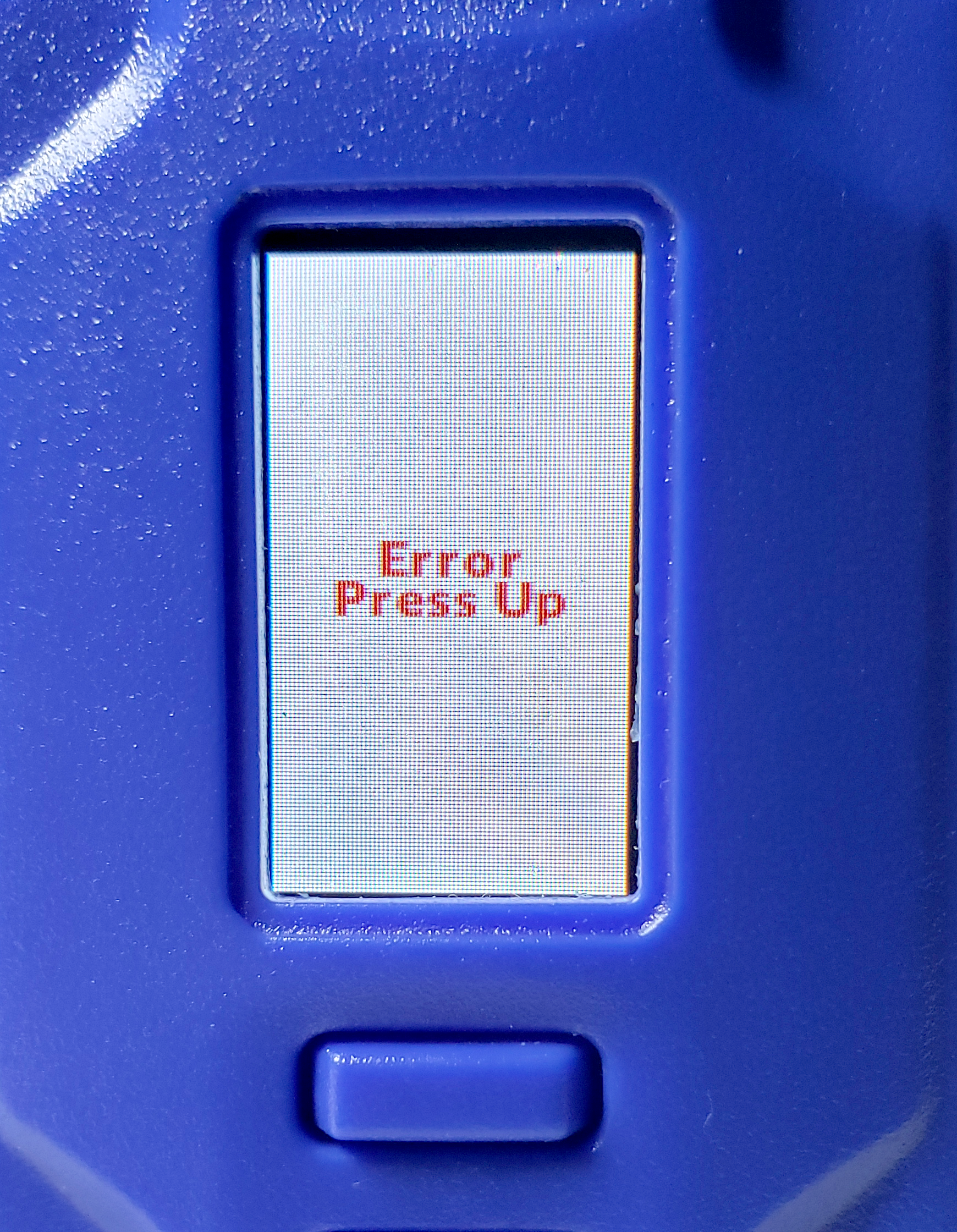

I don't know if it matters, but three of my other DNA250C boards, have Version 1.1 SP35 INT. Only this one, with the "Error Press UP" problem, had Version 1.1 SP35 US, loaded in it. I changed the Service Pack, on it, to the international version, hoping it might help. I know at least one more person with the same problem on his DNA250C. He is in Russia. If we could get to the bottom of this, I will try to help him too. I speak Russian. P. S: When I was finishing reloading international Service Pack 35, the "Error Press UP" popped up on the screen again. I guess, it didn't help.
Sorry to barge in on your conversation, but I too started getting ERROR PRESS UP. It happens almost every day after DNA250C has been sleeping for a while, I press FIRE button and see this error message. It doesn't bother me too much, because it resumes working properly, just as soon as I press the UP button. Mod: Vape Cige VTX200W, brand-new. I just loaded the latest service pack.
I don't really make anything for sale. But I suppose, if you make it worth my while... Just keep in mind, in order to be able to install my "Offset Elbow Adapter", you will need to cut a piece of stainless still tube, from the end of your connector and cut threads M3.0 -0.5mm. For my friend, I also made a new "Back Nut", out of Stainless Steel, because the Delrin one, was too weak.

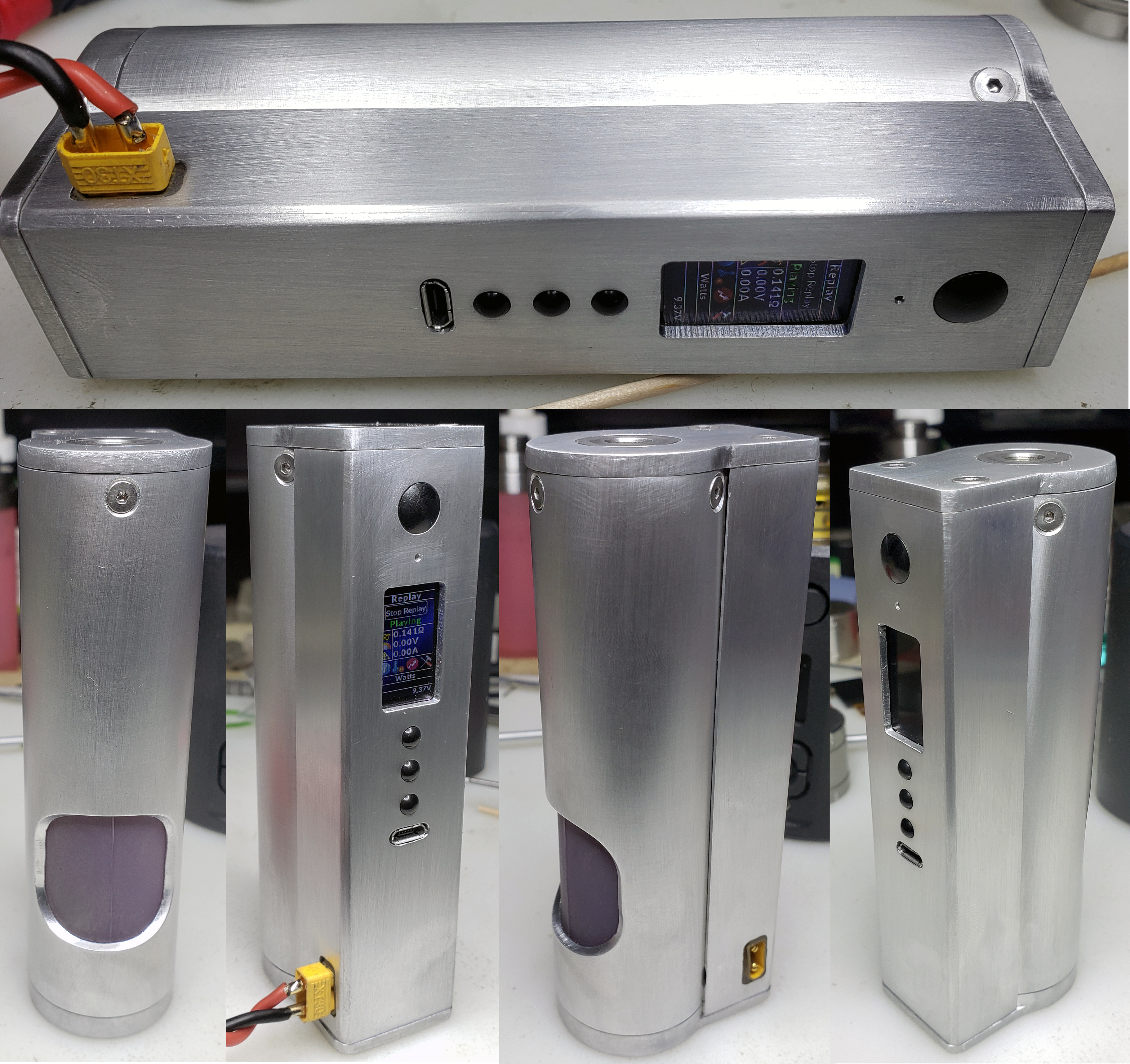

I'm thinking of anodizing it in the future, but I'm not selling it. I made it for myself. Well, having a wire is not this mod's the most convenient feature. But having an unlimited power source and 30ml squonk bottle, defiantly makes it bearable.

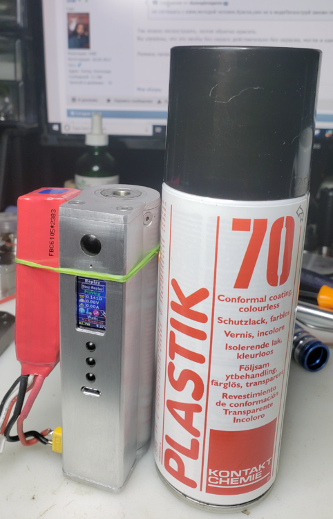

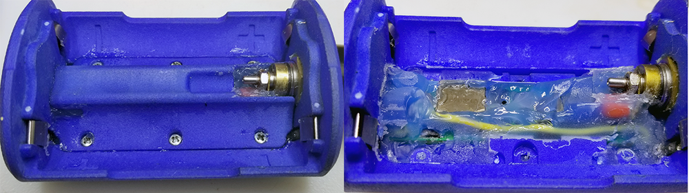

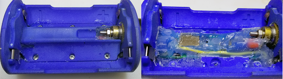

Yes they are, but only one of them, is mine. It's the blue one. I've had it from the day one of release and in had several modifications to it. Including an RTV Silicon sealing of the board, at one time. What looks to you as a PVC glue, is actually what's left of that silicon. But my leaking issues have gone away, since I installed an offset elbow adapter and I don't use silicon anymore. It's a pain in the A to remove. 😀 What I do now is I spray it with a product out of Germany, it's called Plastik-70, it specifically formulated to protect PCB from moisture. -

It's a little off topic, but I was getting tired of the Boxer's leaking issue due to the position of the bottle offset. I made my own Elbow Adopters and converted several mods of my friends. They are now dry as Sahara. -
