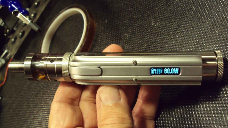

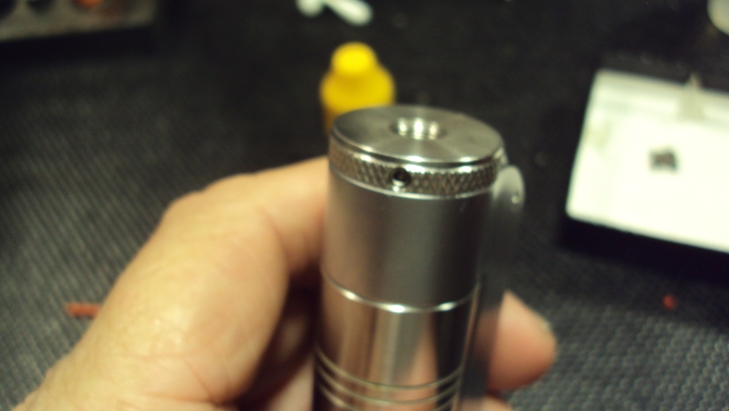

How about a ZNA 60! Took a new old stock ZNA clone, installed the 60, drilled a hole in the bottom for a USB post, wired it up for Escribe access w/o charging. I also upgraded that darn crappy screw adjustable 510 by drilling out the top cap so I can drop the 510 in and lock it down with a set screw from the side, I used one of the VariTube V1 510's, they have always worked well for me. I have three more of these new old stock ZNA clones on my bench but I don't know if I want to build any more of them. I also put a 60 with the data/charge board in one of the Hana V4 mods. Don't have any pics of mine which is the same blue as John la's above, these pics are just some I grabbed off the net to give you and idea what the V4 looks like. I have one more of these waiting on my bench for another 60 build. Bought a pair of them that were new old stock, there was a fellow (zbbmods) on ebay who was selling left over stock from Hana after they closed their doors. I really like this tiny and light V4, and it really works well.

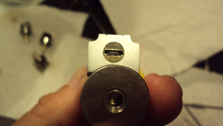

Yes that is the correct answer thanks to member ChunkButt200 who posted it here with pics. https://forum.evolvapor.com/topic/65550-dna-60/?do=findComment&comment=916132 I finally got around to finishing my ZNA 60 and this worked perfectly. I finally got around to finishing my ZNA 60 project and this worked perfectly. I drilled a hole in the base for the 510 then filled the gaps with some hot glue, trimmed the excess with a new x-acto blade and good to go. I also came up with a way to get rid of the crappy screw adjustable 510 and install a VariTube V1 510, not the mod is perfect.

Dual 18650's, nice! Looks good! I put one in a ZNA mod, I love those ZNA's, they feel good in my hand and make for a nice pocket mod when working around the house. It's still a work in progress mod, I replaced the crappy adjustable 510 with a VariTube V1 spring loaded 510, need to get some pics showing that. I've also got to do something different with the patch cable I made for connecting to the charge board so I can use escribe, I've started a thread looking for some answers on that in the modders section --> https://forum.evolvapor.com/topic/68792-can-i-bypass-the-charge-board-wire-a-usb-port-directly-to-board-for-escribe-no-charging-needed/ I'm very happy with the 60 so far, I'm getting just as good a vape as I do with my 75's and 200's.

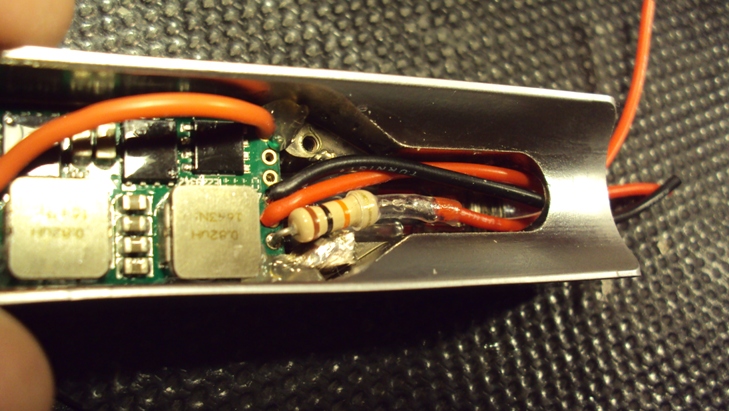

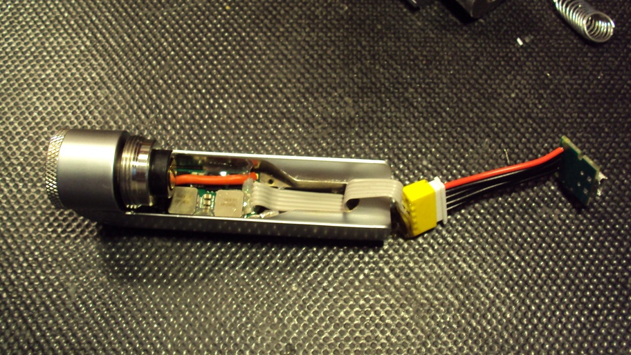

I put a 60 board in a ZNA mod, there is not enough room in the mod for the charge board. I'm not looking to charge battery's in the mod, just want to be able to use escribe. Is it possible to wire a USB port directly to the 60 board for using escribe? For now I made a patch cable from a piece of an old IDE cable and JST balance connectors as found on lipo's, I can tuck it inside the mod when I don't need it. When I need to use escribe I can remove the battery tube, pull the patch cable out, re-install the battery and tube and use escribe. I was planning on making a better and permanent patch cable but I got thinking, if I can wire a USB port to the board I can make a slot for it and then be able to plug a USB cable directly to the mod. Here's some pics of what I have now.
retird, Here's what I came up with, it will get me by until I come up with a better, permanent patch cable. I used a piece of an old IDE cable and the JST battery connectors, it just fits in that void above the screen you pointed out. I can pull it out, put the battery tube back on and run the mod with a 18650 while monitoring in escribe. Now I need to know, is there a way to shut charging off in escribe with the 60? I don't see it under Device Monitor, then under the Diagnostics button like you would with a 200 connected

Ah damn it, so my 3 AM math was off, looks like .020 difference. I may still have a chance at making it work, bending the pins to align with the holes in the board isn't a problem, what may be a issue, the body of the JST won't sit flush with the board. I may have to go with another connector, well only one way to find out!
retired, I think I found a solution, if my 3 AM math is correct a 4S lipo battery balance (JST XH) connector will solder right to the 60 board in holes 11-15. https://www.digikey.com/product-detail/en/jst-sales-america-inc/B5B-XH-A(LF)(SN)/455-2270-ND/1530483 The pins on the JST are .010 closer together then the holes on the board but that's so minor I can bend them a tad so they will align. The body of the connector will fit in the Z and I'm pretty sure it will be low enough to clear the battery tube, if not I can trim it down, heck I could remove the body and just have the pins sticking out of the board. I ordered a cable from amazon that has both the male and female connectors, male to solder to the charge and female for the board. https://www.amazon.com/gp/product/B01N1GQ8KC
