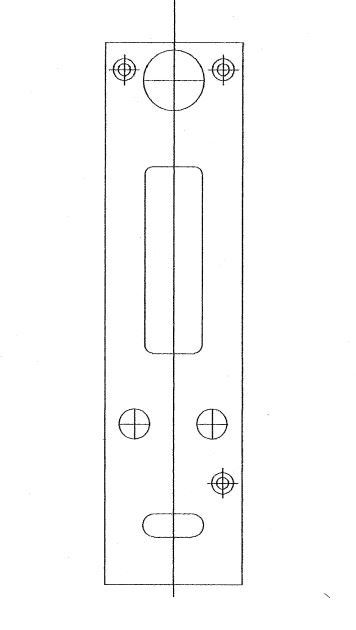

  3. I replied over there, I appreciate the link to that one http://www.modmaker.co.uk/DNA75C-DNA250C-Cutout-Guide but it won't print to scale.
  4. Anyone know of a template I can download and print for the 75C's and the 200C's? Like the one that was made for the 200 some time ago.

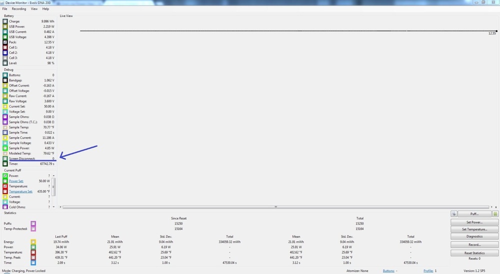

  6. Your screen shot shows the screen disconnected 163 times, likely the power button has pinched the flat screen cable. Below is a screen shot of one of mine, I used the windows "paint" program to point out the screen disconnect.

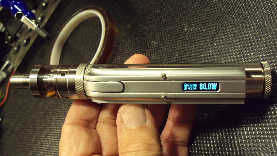

  11. Yes that is the correct answer thanks to member ChunkButt200 who posted it here with pics. https://forum.evolvapor.com/topic/65550-dna-60/?do=findComment&comment=916132 I finally got around to finishing my ZNA 60 and this worked perfectly. I finally got around to finishing my ZNA 60 project and this worked perfectly. I drilled a hole in the base for the 510 then filled the gaps with some hot glue, trimmed the excess with a new x-acto blade and good to go. I also came up with a way to get rid of the crappy screw adjustable 510 and install a VariTube V1 510, not the mod is perfect.

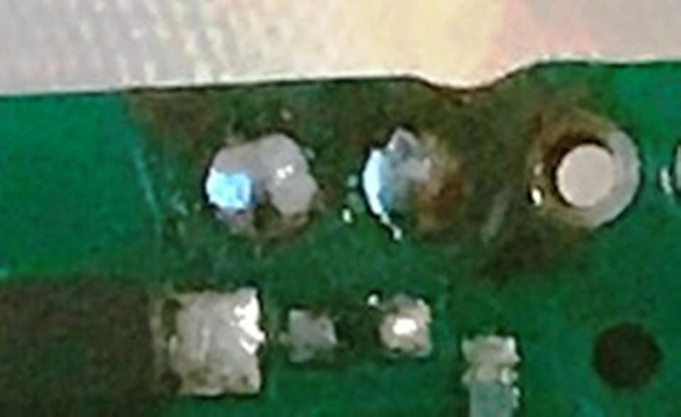

  15. dberry, I enlarged and enhanced one of your pics showing where you solder wires for the remote fire switch. I'd try to carefully clean this area between these two holes with some IPA and q-tips, make sure it isn't making a connection there. What did you use for soldering flux? Not soldering paste found in the plumbing dept at someplace like Lowes was it?

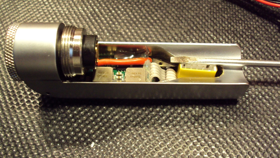

  18. I put a 60 board in a ZNA mod, there is not enough room in the mod for the charge board. I'm not looking to charge battery's in the mod, just want to be able to use escribe. Is it possible to wire a USB port directly to the 60 board for using escribe? For now I made a patch cable from a piece of an old IDE cable and JST balance connectors as found on lipo's, I can tuck it inside the mod when I don't need it. When I need to use escribe I can remove the battery tube, pull the patch cable out, re-install the battery and tube and use escribe. I was planning on making a better and permanent patch cable but I got thinking, if I can wire a USB port to the board I can make a slot for it and then be able to plug a USB cable directly to the mod. Here's some pics of what I have now.
  19. retird, Here's what I came up with, it will get me by until I come up with a better, permanent patch cable. I used a piece of an old IDE cable and the JST battery connectors, it just fits in that void above the screen you pointed out. I can pull it out, put the battery tube back on and run the mod with a 18650 while monitoring in escribe. Now I need to know, is there a way to shut charging off in escribe with the 60? I don't see it under Device Monitor, then under the Diagnostics button like you would with a 200 connected
