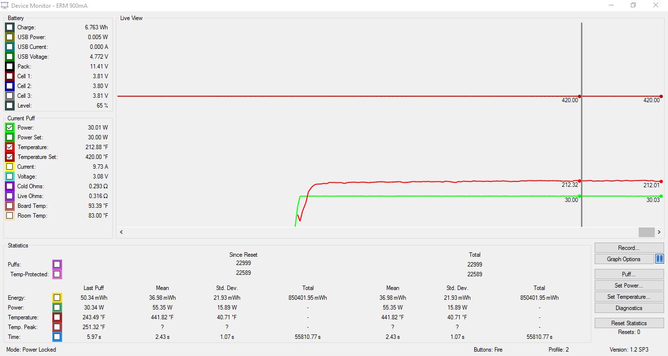

Not temp limiting because you can't heat water past 212° F. You can increase the power to a point that the water doesn't keep the coil cool, but then you will see the temp keep rising until it hits your limit. So yes, it is effectively running in power mode, but look at the temp it is running at. I just wanted to show that the Temco wire with the Evolv profile was pretty accurate. If I had a nice straight line at lets say 260F, then you would know that either the cold resistance was wrong or the tfr curve was wrong. -

Did a water test tonight. Single coil 24awg Temco ss316l, Vaporshark dna200, kayfun5 deck, Evolv default ss316 wire profile. After mating atomizer, I let it sit unplugged for 20 minutes for refinement. -
