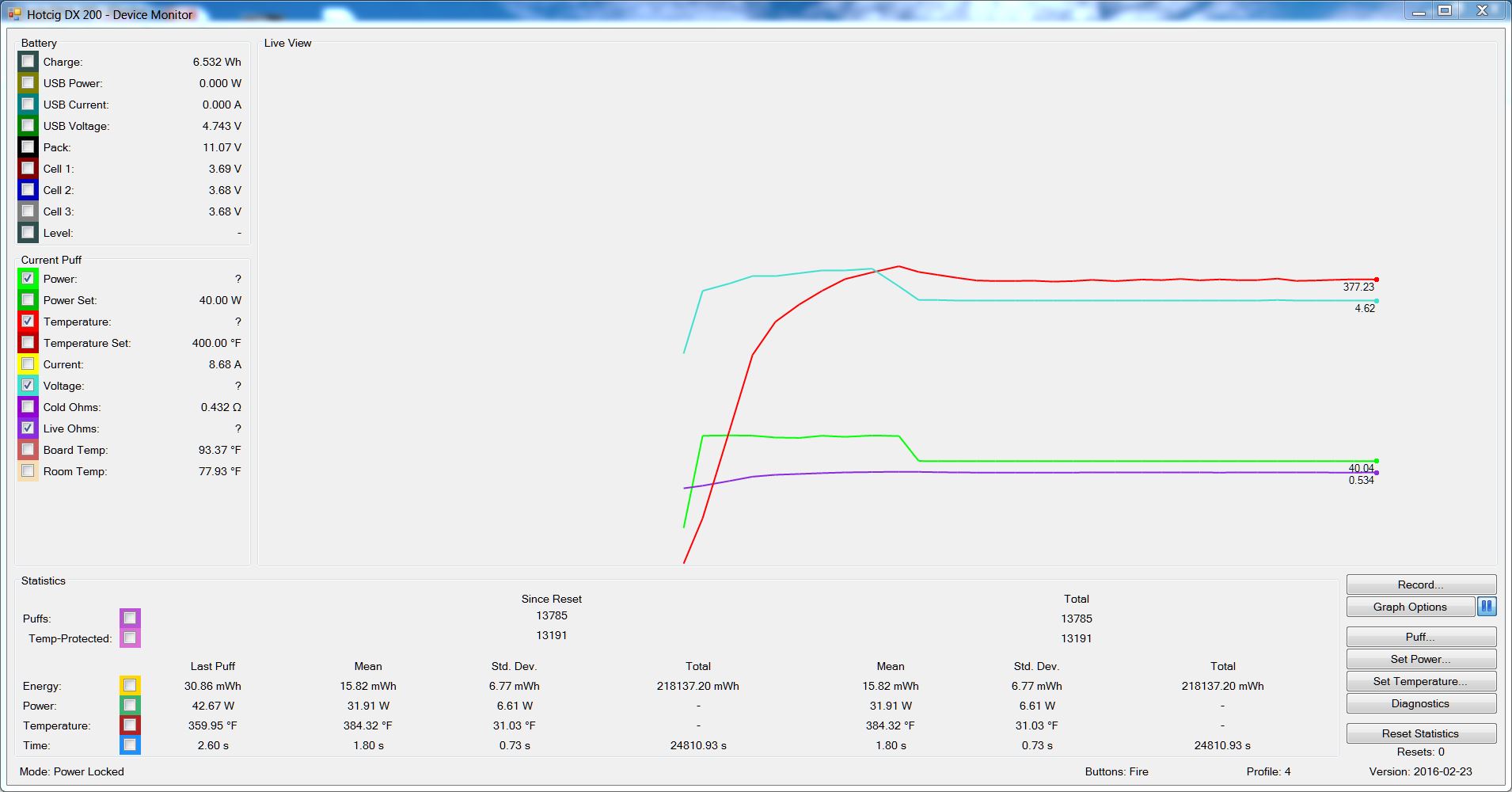

  7. First off the voltage being displayed in device monitor is what you need look at as what is on the display may not be accurate. Is the situation with needing jump started with the usb even after charging stops?

  12. I'll answer my own question as well as the poster's. Here's what I did, I removed the battery from my DX 200 and plugged it into EScribe. No cell voltage, no pack voltage listed in EScribe. Next I plugged just the balance connector from a loose balanced lipo into the DX 200 It read pack as well as cell voltages in EScribe but appeared unbalanced.. BTW it showed charging which I really didn't expect. The loose lipo was checked for balance with a meter. So with a blown fuse pack voltage will still be shown in EScribe. @WTVapes it appears that your fuse is gone.

  15. The Lion Power battery while labeled 1800 mah is closer to 1250 - 1300 mah. Use 1400 - 14.43 watt hours for the setting. As far as the changing numbers, I don't know.
