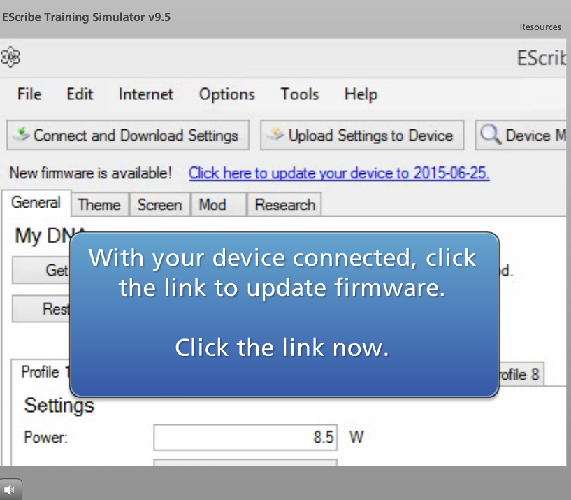

I don't think it will auto-update your firmware but will place a notification in EScribe that there is an update available. Here is a link to an early tutorial that is helpful. A lot has been updated since this video but you can get a lot of "how to use EScribe" from it if you want to view it. https://downloads.evolvapor.com/escribe/guide/story.html Here is a users manual that is a bit dated also and a lot has changed but may be helpful: https://downloads.evolvapor.com/escribe/EScribeManual.pdf -
