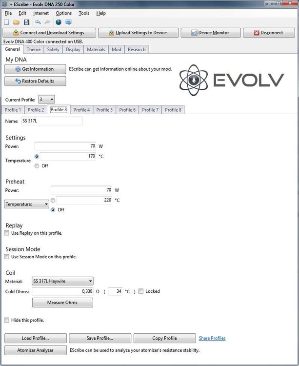

Here are two graphs from device monitor, one when cold (was working until seconds ago, just refilled e-juice), and one after I "persuaded" it to work by raising the temp to 230 C. Both graphs are at 170 C, didn't include the temp set and many other parameters for clarity. Interestingly, I can't see the temperature on the graph, not sure what is happening here, I think I saw it earlier. Maybe it really doesn't detect the coil as temp sensing? Just in case, I am also attaching the profile settings. Mod resistance is 0,0065 ohms. Cold.csv Warm.csv As a side note, not connected (only) to this case, I notice that the room temperature as reported by all my DNA devices is always around 6 to 8 degrees Celsius higher than actual. I have performed thermal calibration on all of them and after that they work better in temperature mode, so that tells me that I am not doing something terribly wrong. -

I think this firmware (1_1_SP55_1_INT.sw-service) broke "Temp Sensing Detect" for me, previously was working fine. Device: DNA 400 Color, Hammer Of God. Now, when I refill the atomizer with liquid (I guess it cools it down), it doesn't start heating at the set temperature, at which was working fine up to that moment. I need to raise temperature for around 30 deg. C or more for the device to start heating. Then after few puffs the vapor becomes too hot and I need to return to the original temperature. Nothing was changed except for the firmware upgrade, the atomizer was never removed from the device and even it has the same coil (sometimes dry burned and changed cotton, of course). The material is 317L Haywire from steam-engine.org, which I repeat, was working fine before. Preheat on or off, it doesn't matter. On the graph the first few puffs look like normal, like the temperature is rising and maintaning, but in reality the coil isn't heated and I draw only cool air. If I don't raise the temperature, I never get any vapor, no matter how hard I draw. To my amateur untrained eye it looks like it doesn't update the coil resistance. But on the other hand, when I click on "measure ohms", although there is a difference of 0,03 ohms or more, that doesn't change the behavior. Neither locking ohms does. I am sure the device is set up properly, Mod Resistance was measured with a copper tool, also Case Analyzer was done, but most importantly, it was working fine before the firmware upgrade. I upgraded it just recently, around ten days ago. Edit: Yes, the coil is tight. In fact, when it started acting up, that was the first thing I thought of, so I tightened the coil with a longer screwdriver, nearly to the point of breaking the threads, but it changed nothing. -
