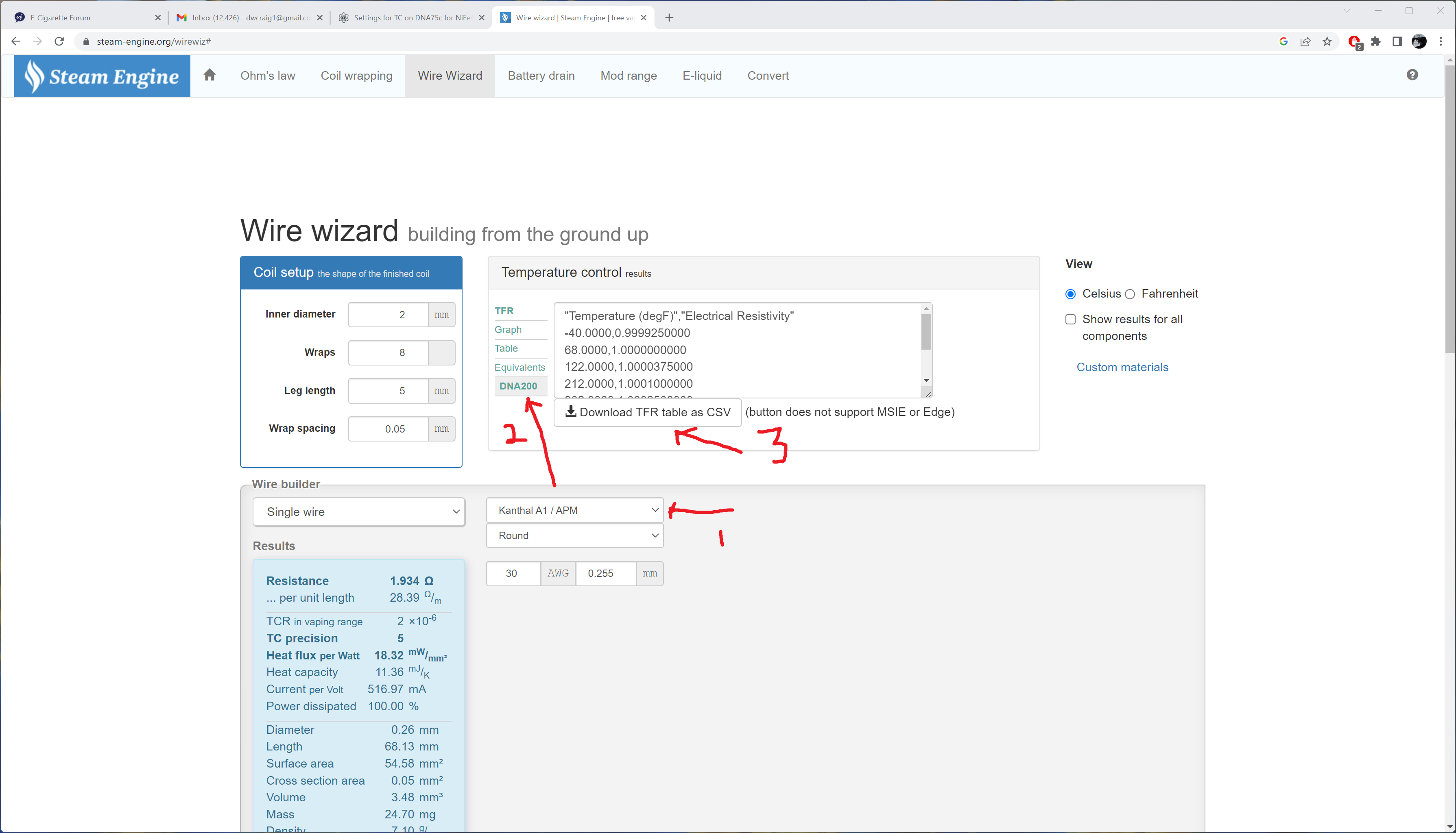

Wayneo Posted February 26, 2023 Report Posted February 26, 2023 1 hour ago, Yol said: There are three types of wire: SS316L (Temco, 28GA), NiFe48 (Zivipf, 28GA), SS304L (INOWIRE, 28ga). I want to try TC on these wires without involving Replay. Why do you say that? TC without Replay is the normal way. TC with Replay is a hybrid only few should ever use and brings complexity. Replay with no material curve is the normal way. Do you own those wires right now? 1 hour ago, Yol said: What should I do next? Download the proper material curves into your mod, and use them in your profiles. 1. You can simulate a build in steam-engine. There is nothing special OR a spaced build the span of the connectors OR build to an ohm range. 2. None whatsoever. A thicker wire (lower awg) might be easier to coil. A thinner wire will heat up quicker. 3. Absolutely yes. Low power to burn off oils and make sure it's heating from the center out. Plus you get to see if it's got hot legs. 4. Snug through the coil. 5. No. Internally some things are different. The temp on any DNA should be the same. 6. Out of your 3, the NiFe so long as you use the proper TFR/TCR. Are you a new vaper? Are you new to DNA mods? 1
Yol Posted February 26, 2023 Author Report Posted February 26, 2023 (edited) 15 минут назад, Wayneo сказал: Do you own those wires right now? Hello! Yes, i have those wires. 15 минут назад, Wayneo сказал: 1. You can simulate a build in steam-engine. There is nothing special OR a spaced build the span of the connectors OR build to an ohm range. I dont know how, because i see only one wire, what i have right now - ss316L. Nife and 304L are not on the list on website 15 минут назад, Wayneo сказал: 3. Absolutely yes. Low power to burn off oils and make sure it's heating from the center out. Plus you get to see if it's got hot legs. good, but some people write that the space coil from SS or Nife cannot be burned after installation, because something changes there, This is not true? 15 минут назад, Wayneo сказал: Are you a new vaper? Are you new to DNA mods? I am not a new vaper (i use only vw). And yes, i can say, i am a new to DNA mods Edited February 26, 2023 by Yol
Wayneo Posted February 26, 2023 Report Posted February 26, 2023 11 minutes ago, Yol said: I dont know how, because i see only one wire, what i have right now - ss316L. Nife and 304L are not on the list on website There is already SS316 on your mod. That is fine. Your NiFe48 from zivipf should say what the TCR value is. I have a post about NiFe here to match/help with the zivipf value https://forum.evolvapor.com/files/file/1570-6-nife-material-files-and-tcr-list-for-all-dna-mods/ Use that to create a custom TCR file for your mod. There is also an Inowire profile from someone else. I have no clue about authenticity or correctness. 19 minutes ago, Yol said: but some people write that the space coil from SS or Nife cannot be burned after installation, because something changes there, This is not true? NOT TRUE at vaping temperatures. Notice I said low power. Whenever you see shit like that ask what temperature that occurs. May I ask why you are so against Replay? It's a much simpler way to get dry burn protection. MOST people don't even use TC the way it was intentioned. It has always been 'Temperature Protection', a limit your coil should not exceed. MOST think their coil should rise rapidly to the set temp and stay there. 1
