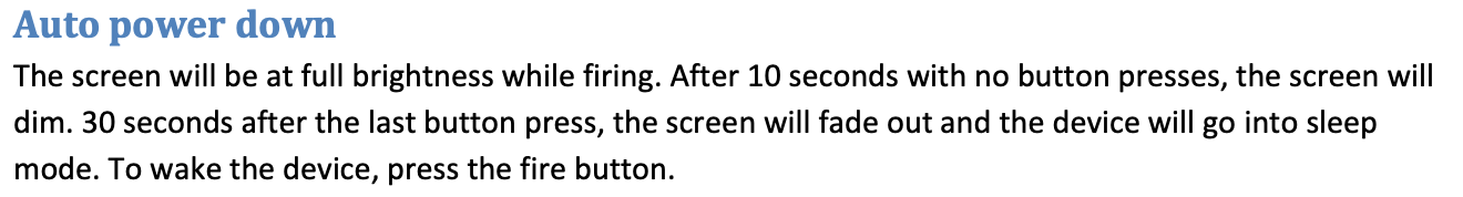

On 8/27/2022 at 6:19 AM, BillW50 said:
Wow! You're right. I just checked one of mine. The only setting that works (set to) is off while firing. Otherwise it is at max brightness. It must be a firmware bug.
This one is running SP6.1 INT (Device Manager).
Thanks Bill. I just set it to off while firing. Best solution for sure.

It doesn't make any sense to have a slider in EScribe when all you can have is full brightness or off. Why not replace the slider with a switch instead? And why not have it adjustable like expected? This way it has a cheap Chinese engineered feel to it.
I also tried SP3 (an older firmware version) to see if that one does the same full brightness or off and it does.
