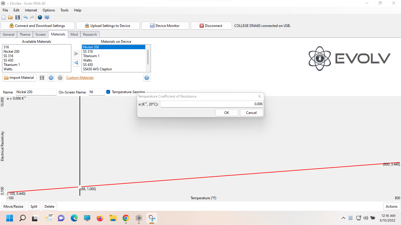

image.thumb.png.8af42a8ea73225bbc3e2e3bfbaef32a1.pngthe
I believe that you are wanting to change TCR directly on the mod but it can be changed for various wire type in EScribe under the Materials/Action tab.
(Just incase that you weren't aware of it)
I did already know how to change it through escribe.
Thanks in any case for the time you took to answer ;)

You don’t need to reset to defaults. just start escribe with no mod attached, choose new 250c, when it opens go to material, select nife30 in the right hand window and move out to the left hand window. Now it’s available for all your moods just move it to their right hand window
Thanks, i'll go through it.
