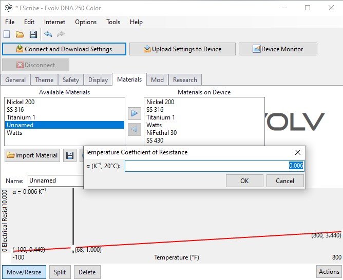

BillW50 Posted September 11, 2021 Report Posted September 11, 2021 You can create a material from a TCR from EScribe from the materials tab. Select add and then select the new material and click on the Actions button.
Peter_Silie Posted September 11, 2021 Author Report Posted September 11, 2021 @BillW50 thank you for your agreement . And yes, as I just said: I'm aware of this workaround, that results to just another fixed wire profile with a linear relation, then.

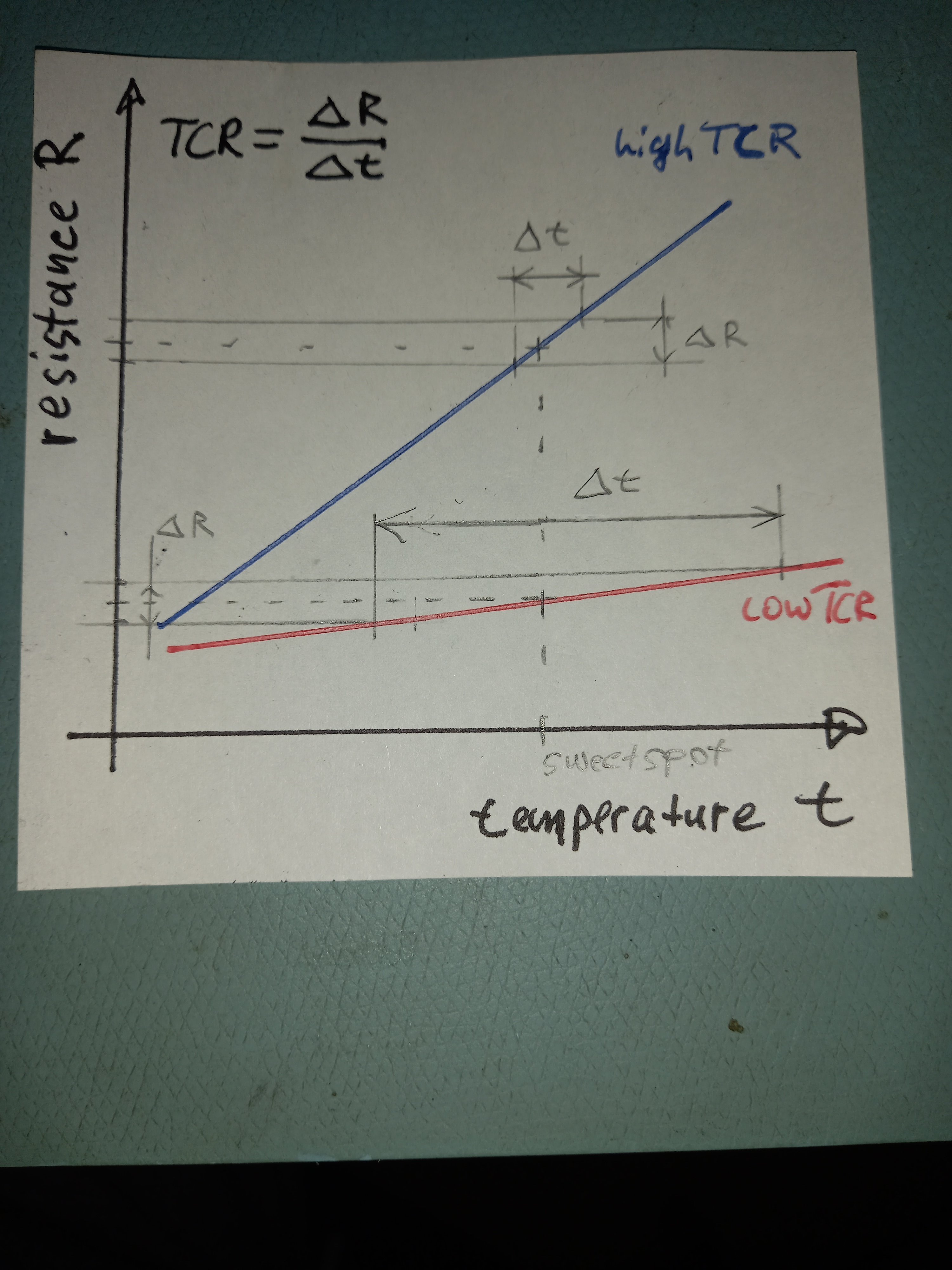

Peter_Silie Posted September 12, 2021 Author Report Posted September 12, 2021 @gwyarThank you for your answer. Let's take a closer look. vor 11 Stunden schrieb gwyar: The temperature coefficient of a material changes as soon as it is processed into a coil Sorry but that is not true. The TCR is a constant that depents on the material, and decribes how much the resistance of the material changes when it is heated. That does NOT depend on the shape of the material neither on the location. It is always the the same under a maple or beneeth an oak and even on mars. As wayneo said: steam-engine 'wire wizard' gives a good overview, any physicist table book will give the same information. Your expectations on using TC are exacly the same as mine. The problems that you achive are the same as mine, too. The reason for that is, that we don't have the right material for a proper TC setup. We should have more wire material like titanium. The reason for most problems that we have with TC is, that we don't have much choices on the material. In most cases we use SSL316 or similar, right? I try to explain: SSL has a TCR about 80, very low. Even though the DNA has a very presice measuring circuit, the resolution of that is NOT infinite. When looking to your cold resistance adjustment, you see that the smallest value, you can set is 0,001Ohm. That's the border of the resolution. (simplified) I made the picture to show what happens when you apply the same resolution (deltaR) to different TCR. You can see, that on low TCR, the deltaT value increases, that means when the controller calculates the value, a huge range of temperatures match to the same resistance (simplified again) The red graph represents materials like SLL316, the blue graph is for something like titanium or nickel. It is schematic and not symmetic, but you will get the idea...

Peter_Silie Posted September 12, 2021 Author Report Posted September 12, 2021 vor 2 Stunden schrieb gwyar: this is dishonest sorry, why do you feel that? I just tried to explain where most problems come from. A good working TC would be so important for new users because it prevent them from vaping too hot or too cold and to aviod dry hits as well. There are several reasons why we want to have good TC and should have it set up right. We need good coil materials that lets you make your coil like "10 wraps on 3,5mm, TCR400, 220degC, ready" and that leads to the same result all over the world. Under the Maple tree with a light breeze from west as good as during winter time. Before we lean back and state: " I don't care, I use Replay..." , we should ask why they sell us that poor SSL stuff only.
