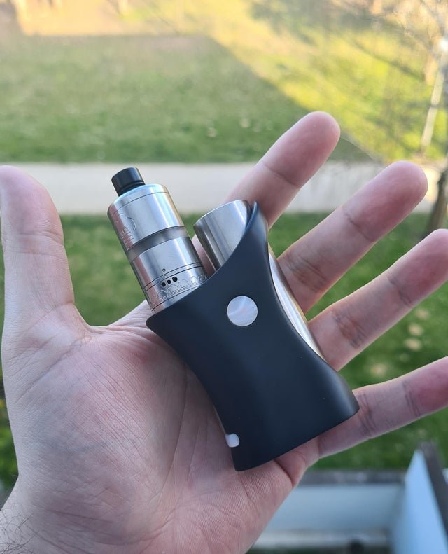

Dragan Čelebić Posted September 4, 2021 Report Posted September 4, 2021 (edited) NYMFA DNA60 BY VISIONARY MODS, no usb port. How can I adjust the brightness of the screen? Today, during normal use, the screen is completely darkened. The mode works, but there is no light on the screen. Is there any help? video-1630780460.mp4 Edited September 4, 2021 by Dragan Čelebić correction

Dragan Čelebić Posted September 4, 2021 Author Report Posted September 4, 2021 (edited) 6 minutes ago, retird said: If the screen gets crcked it can go black. Any signs of a crack? well no, I watched in the bright light. Nothing is noticed, there are no cracks. everything was working normally, only, at one point when I looked below, at the screen, I noticed it wasn't working. and, I'm just sad. Edited September 4, 2021 by Dragan Čelebić correction

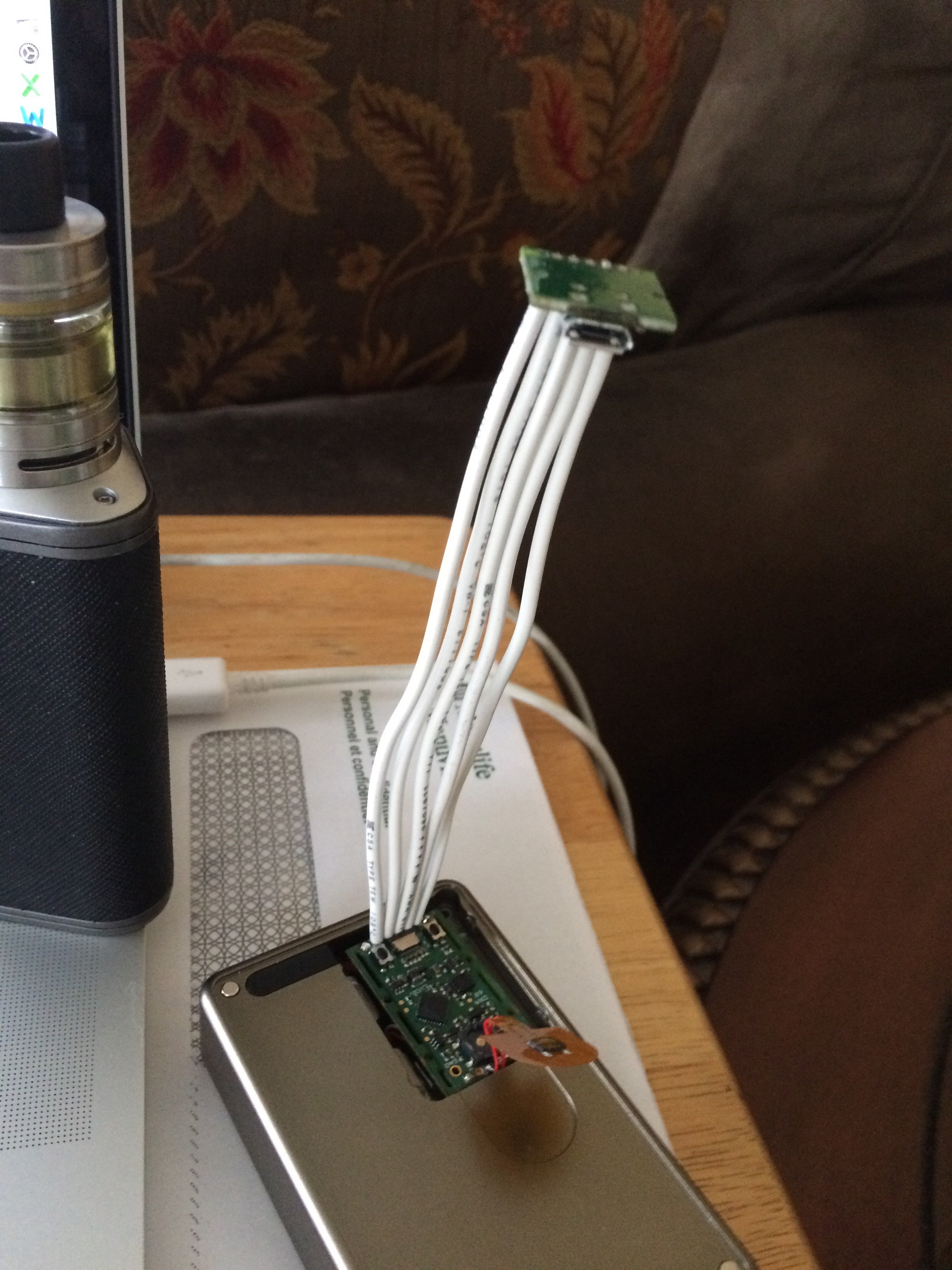

Wayneo Posted September 4, 2021 Report Posted September 4, 2021 Hopefully it is still under warranty from where you purchased it. I think you should either contact them or the builder himself. Failing that, you could open it up and look around the screen connector itself. If neither of those 2 options seem reasonable, you could open an RMA with Evolv. I imagine the screen is very close to the board, and you might want to purchase a data/charging board for future use, such as setting the board up to your liking. Checking the firmware level, etc. Those board pins are at the bottom of the board near the screen ZIF connector. I made this cable that is removable just for the above changes. After all that I posted a cheat sheet for these non color boards.https://forum.evolvapor.com/topic/71559-cheat-sheet-key-combos-for-non-color-mods/ 1
