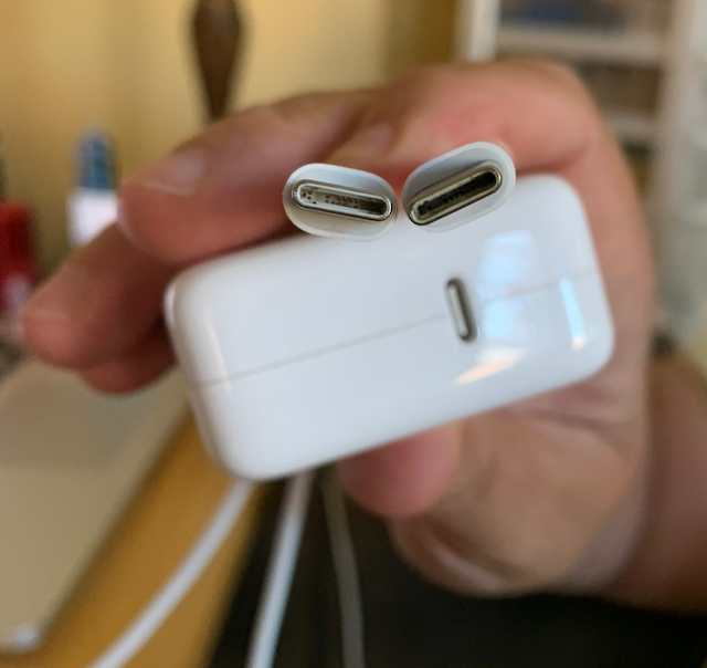

Me -> Mine would charge in 3A mode as seen on the mod screen, while plugged into an external charger with a USB C-to-C cable.

but i tested charging with a USB-C adapter (the adapter is 3A) and a USB-C / USB-C cable and there is no change in current. Now I fully discharge a battery to see if the current will not rise. Usually the adapters with USB-C are type PD, I do not have one with USB-C type QC, if that matters.  What model of adapter do you use?
Thank you for the information! Strange, very strange and the cable in the mod set is USB-A to USB-C. One adapter I have supports the power supply of Mac Book, but the current is still 1.5A. The power supplies for MacBook are according to the PD standard. Not to mention that there is no PDF for this board. Now I will try another adapter with USB-C ... Thank you again!
