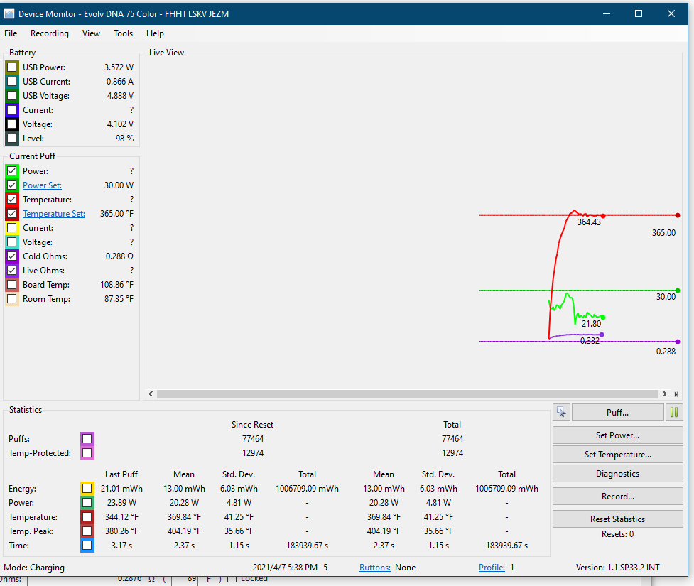

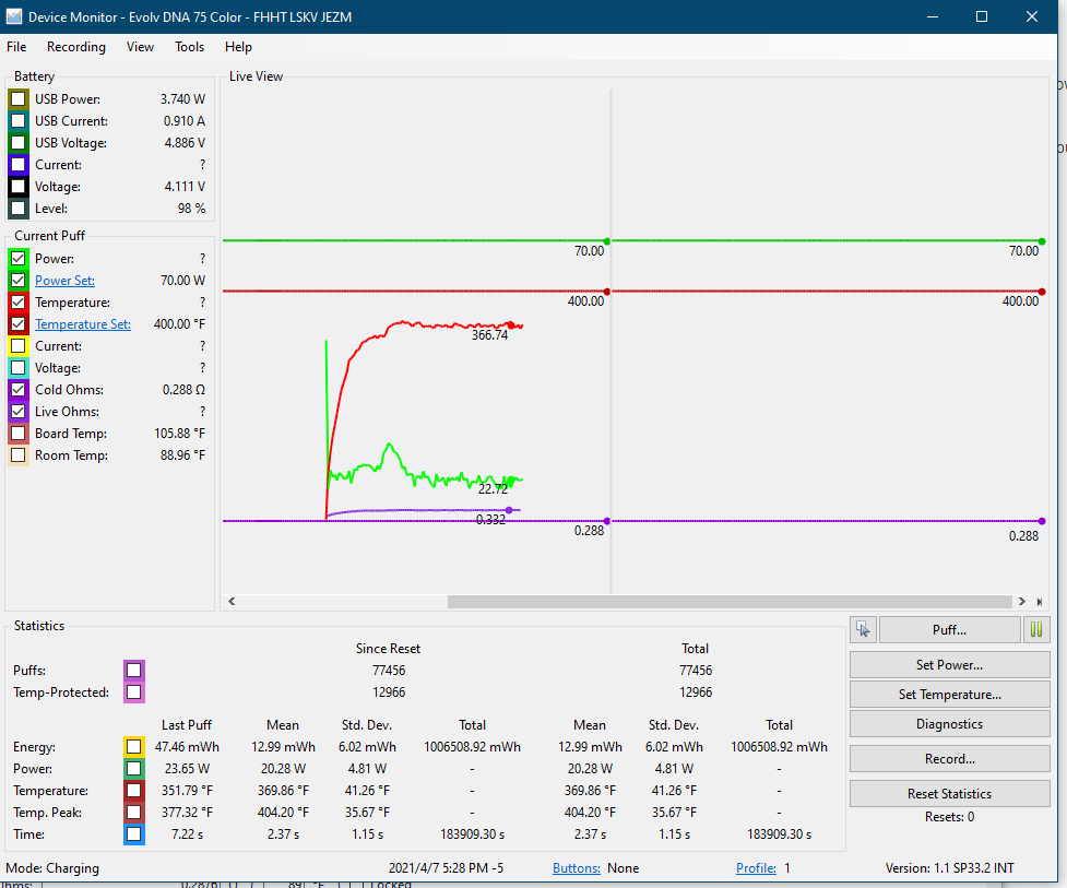

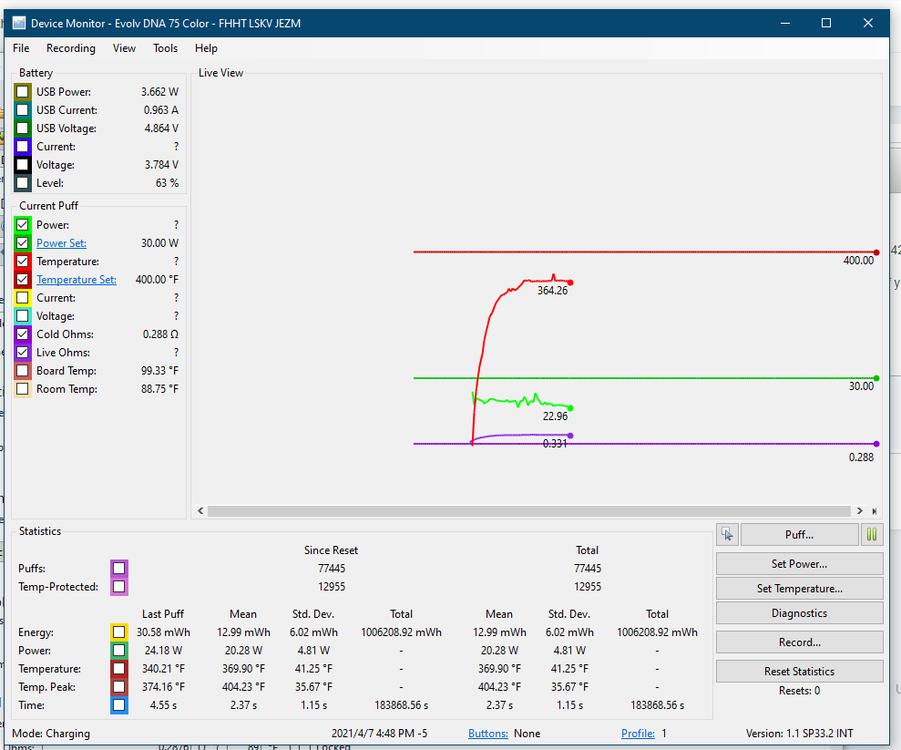

retird Posted April 7, 2021 Report Posted April 7, 2021 Try this: In power mode set to maximum if you accidently turn off Replay what happens?? Say you set TC to 400F when you get the best vape at about 365F. Your first vape is not what you want but the second one is so you set Replay. Device Monitor shows your Replay Temp is running at 365F. Max TC is still 400F so what happens if you accidentally turn off Replay? And, again @James said: TC with Replay is fine. I didn't expect people would combine the two, but the features are (mostly) orthogonal, so there is no reason it shouldn't work if you really want to do it. If it tastes better I am glad. Screenshot: Replay in TC mode Screenshot: TC mode with power set to 70 watts using Replay. Screenshot: TC Mode with Replay. TC set to 30 watts and 365F:
CMK Posted April 8, 2021 Report Posted April 8, 2021 vor 8 Stunden schrieb retird: In power mode set to maximum if you accidently turn off Replay what happens?? The same thing happens when you have set the temperature and power to maximum in TC mode and accidentally turnoff replay!! Sorry, but I think we both have different ideas / demands on the replay function. In my opinion, Replay shouldn't reproduce a chance hit, but the basic settings should already be correct - this also includes a power setting in TC mode that enables the set desired temperature to be reached so that the chipset can regulate via the specified resistance value. Then replay in TC mode makes no sense at all. What strikes me in your graphics is that you apparently did not reach the preset temperature BEFORE activating Replay, although the performance should actually be sufficient; the chipset adjusted back before - unfortunately you did not include a graphic WITHOUT replay. Does your resistance curve actually match the coil you are using? Personally, I see the point of replay in the elimination of external variables in the case of unknown resistance curves - the TC mode actually does nothing else if the resistance curve is known. Basically. Even in TC mode, the default power of the DNA chipset should match the target temperature (resistance); If the power is set too low, you will not reach the temperature and if it is significantly too high, you can clearly see an unclean, clocked control. Apart from that, the result is the same as in the replay mode: the power is adapted to the external variables in order to achieve a preset resistance. I see two paths here that lead to the same goal. 1
