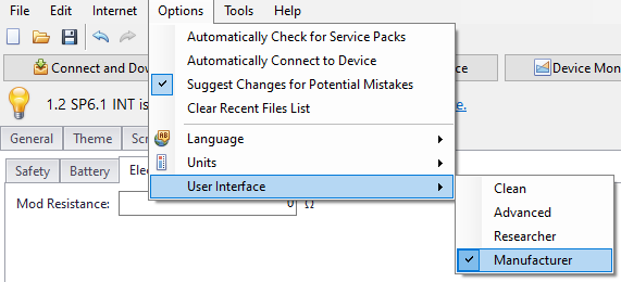

retird Posted December 24, 2020 Report Posted December 24, 2020 Link to DNA60 Datasheet in case you don't have it: https://downloads.evolvapor.com/dna60.pdf I don't own a DNA60 device so others around here will be of more help but what does EScribe show as the ohm value under the Mod/Electrical tab? 2
TechnoMania Posted December 24, 2020 Author Report Posted December 24, 2020 42 minutes ago, retird said: Link to DNA60 Datasheet in case you don't have it: https://downloads.evolvapor.com/dna60.pdf I don't own a DNA60 device so others around here will be of more help but what does EScribe show as the ohm value under the Mod/Electrical tab? Thanks...It is set to '0'. It doesn't appear that the manufacturer contributed any info, but I would imagine there would be at least a few other complaints out there if it caused this type of issue. I would like to wrap my head around why it seems to be functioning great in TC despite the incorrect ohm reading.
BillW50 Posted December 24, 2020 Report Posted December 24, 2020 (edited) You can short the 510 on the mod and read the resistance from the Atomizer Analyzer (don't fire it and it isn't necessary - a spark is normal [0.5v]). And the value it says you need in put in EScribe's mod resistance. And the resistance being off by 0.06Ω shouldn't affect the TC working as long as the connection is solid. Although the temperature setting may not be accurate and maybe off a dozen or so degrees. Edited December 24, 2020 by BillW50 2
Wayneo Posted December 24, 2020 Report Posted December 24, 2020 That '0' value IF changed (raised) will lower the measured resistance of your coil. The evolv default for their other boards is 0.004Ω You should start with that. .We're talking milliohms here. Mine, measured accurately, range from 0.002 to 0.008Ω but I have heard of other mods much higher. "From the output of the board, there are several resistances in series that make up the load. First you have the wires running to the connector. Then you have the connector body itself. Then you have the interface between the connector and the atomizer. Then you have the atomizer body, then the connection between the atomizer and the coil. Then and only then do you actually get to the coil. All these elements have some resistance, and resistances in series add up" I have never fudged a coil resistance more than a few milliohms one way or the other. As far as your other mods and ohm reader, they're all probably in the ballpark, it all comes down to precision. Remember a .67Ω coil could be anywhere from .666 to .674 and will all display .67 on your mod 3
TechnoMania Posted December 24, 2020 Author Report Posted December 24, 2020 (edited) 7 hours ago, BillW50 said: You can short the 510 on the mod and read the resistance from the Atomizer Analyzer (don't fire it and it isn't necessary - a spark is normal [0.5v]). And the value it says you need in put in EScribe's mod resistance. And the resistance being off by 0.06Ω shouldn't affect the TC working as long as the connection is solid. Although the temperature setting may not be accurate and maybe off a dozen or so degrees. Thanks! I'll give that a try. Hopefully, it will help some, but the manufacturer more than likely set all of these up the same way, and I'm the only one complaining about a blatant issue when Googled. OTOH, I may just be that unlucky one out there who received one with issues.. I was actually able to pass a cotton burn / singe test set at 420F with SS316L... When I set it at 380F, it feels like 380F on my other devices, 420F feels like 420F in comparison etc.. I do strive for tight connections in TC when assembling / building my attys, so I'm sure that's helping. I'm just hoping that I can get this straightened-out. It just bugs the hell out of me. Why would TC cease functioning and immediately go into protection when fired after locking the actual cold resistance value in EScribe? My USA-made ohm meter reads resistance showing the fluctuations (for example 61.2 ohms, with the .2 fluctuating slightly, sometimes back to 60.9). Shouldn't that work well as the actual value when say, 0.61 ohms is forced and locked in?... Edited December 24, 2020 by TechnoMania
Wayneo Posted December 24, 2020 Report Posted December 24, 2020 19 minutes ago, TechnoMania said: but the manufacturer more than likely set all of these up the same way, and I'm the only one complaining about a blatant issue when Googled. OTOH, I may just be that unlucky one out there who received one with issues.. The manufacturer ONLY left the evolv standards alone. Changed nothing. Zip, zero zilch. You're the only one that noticed. To repeat myself, you just need to measure and set the internal mod resistance. Your ohm reader fluctuates because it's applying power to the coil. There is no great mystery
