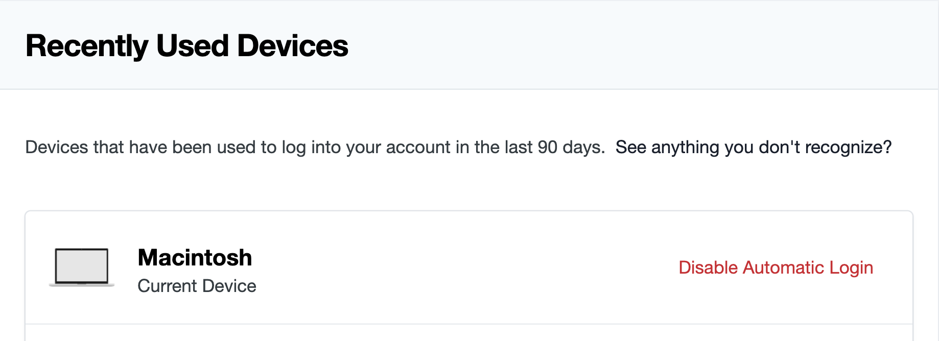

Wayneo Posted September 22, 2020 Report Posted September 22, 2020 On 2/5/2020 at 2:56 PM, Mr.Bottomfeeder said: Btw. Do you fly out of the logged-in state after a few minutes if you don't write anything in this forum and have to log in again? With yesterdays forum update, if you go to Recently used devices, there's now a toggle to keep you logged in. I'm going on more than 12 hours, no logout. Using Chrome browser btw. Tab open while using other tabs, closing tab and coming back later, still not logged out. A happy day is here. Oh yeah, better desktop emoji's to match the mobile. 🙂

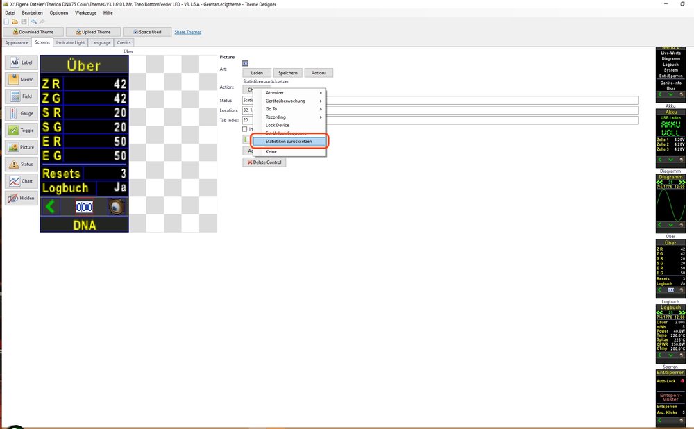

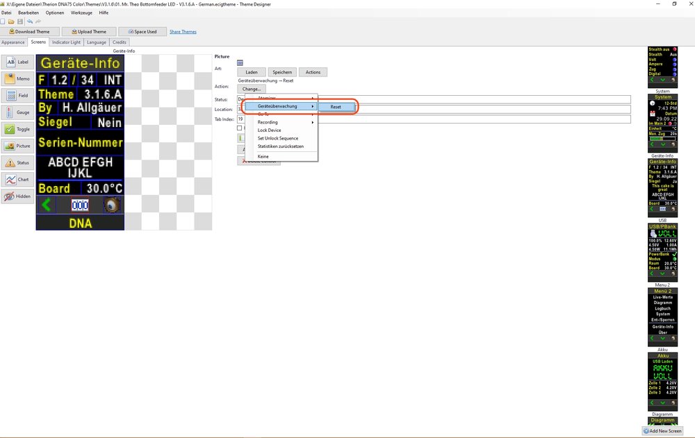

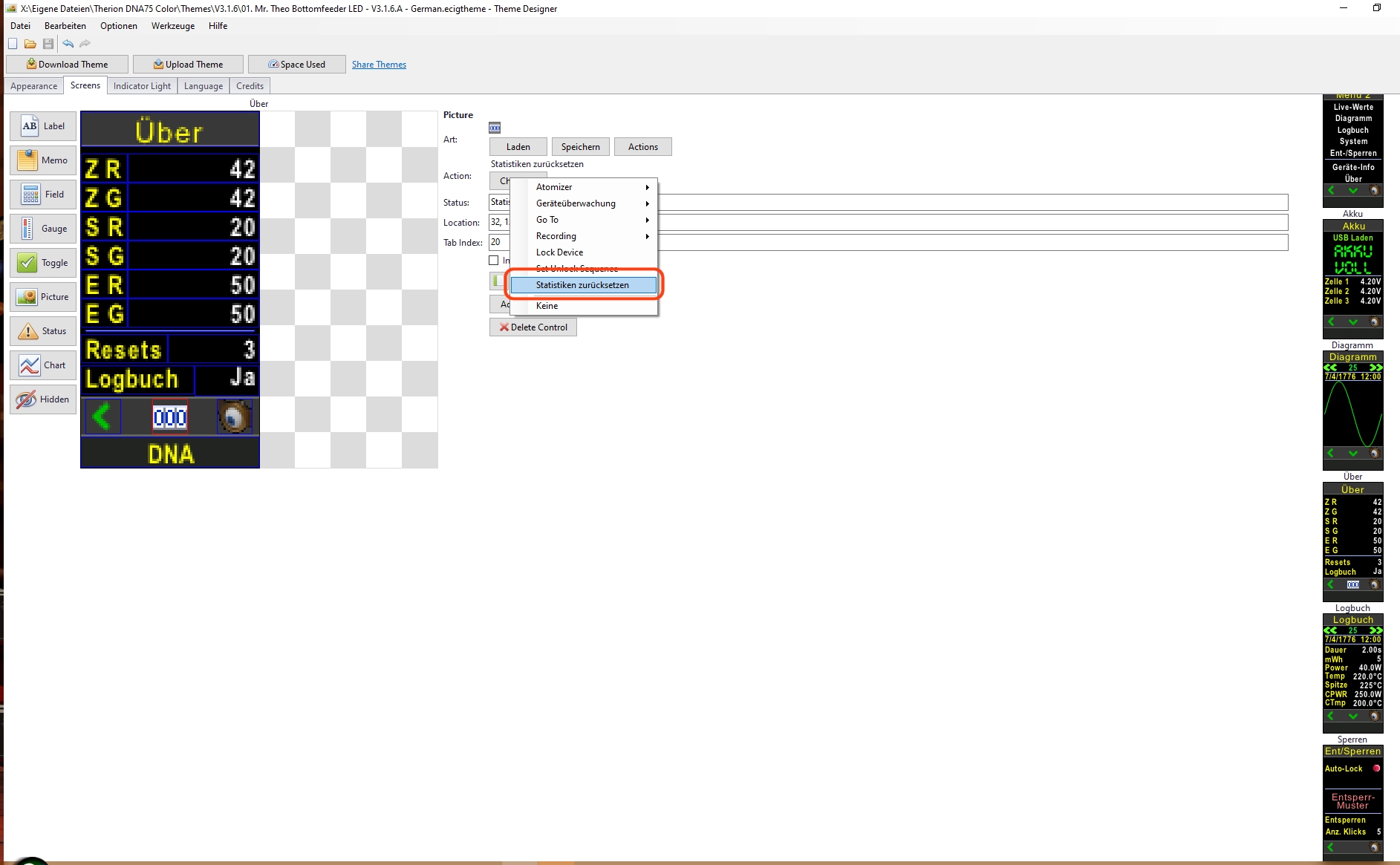

Mr.Bottomfeeder Posted September 29, 2022 Author Report Posted September 29, 2022 vor 18 Stunden schrieb Magigamix: Do you mean the "Device Monitor" Reset Action? (it was the only option I found on "Theme Designer" related to "Reset Device". Hi my friend, I found two kinds of possible resets in the Theme Designer First: "Action" - "Geräteüberwachung" -> "Reset" (means "Action" - "Device-Control" -> "Reset" or some like similar in english) This is the one, I have talked about and what seems to me is doing nothing when using this function. The second is the "Action" - "Statistic-Reset" - that works and sets visible the Statistic-Counter back to zero. 1
Mr.Bottomfeeder Posted September 29, 2022 Author Report Posted September 29, 2022 vor 14 Stunden schrieb Magigamix: Update: - With the latest Firmware Version: 1.1 SP45.2 INT: TSD doesn't work as expected. I noticed that as well. I have come to terms with it and have not exchanged No-TC and TC coils or RDAs with such between the devices since then. This is how I avoid this problem. I generally only downgrade if nothing works anymore. This issue is too minor for me to downgrade because of it. I hope that your info to EScribe is successful and they will release a fixed update soon. Much luck! Kind regards Hubert 1
Mr.Bottomfeeder Posted September 29, 2022 Author Report Posted September 29, 2022 Here the location of the two Reset-Functions 1
