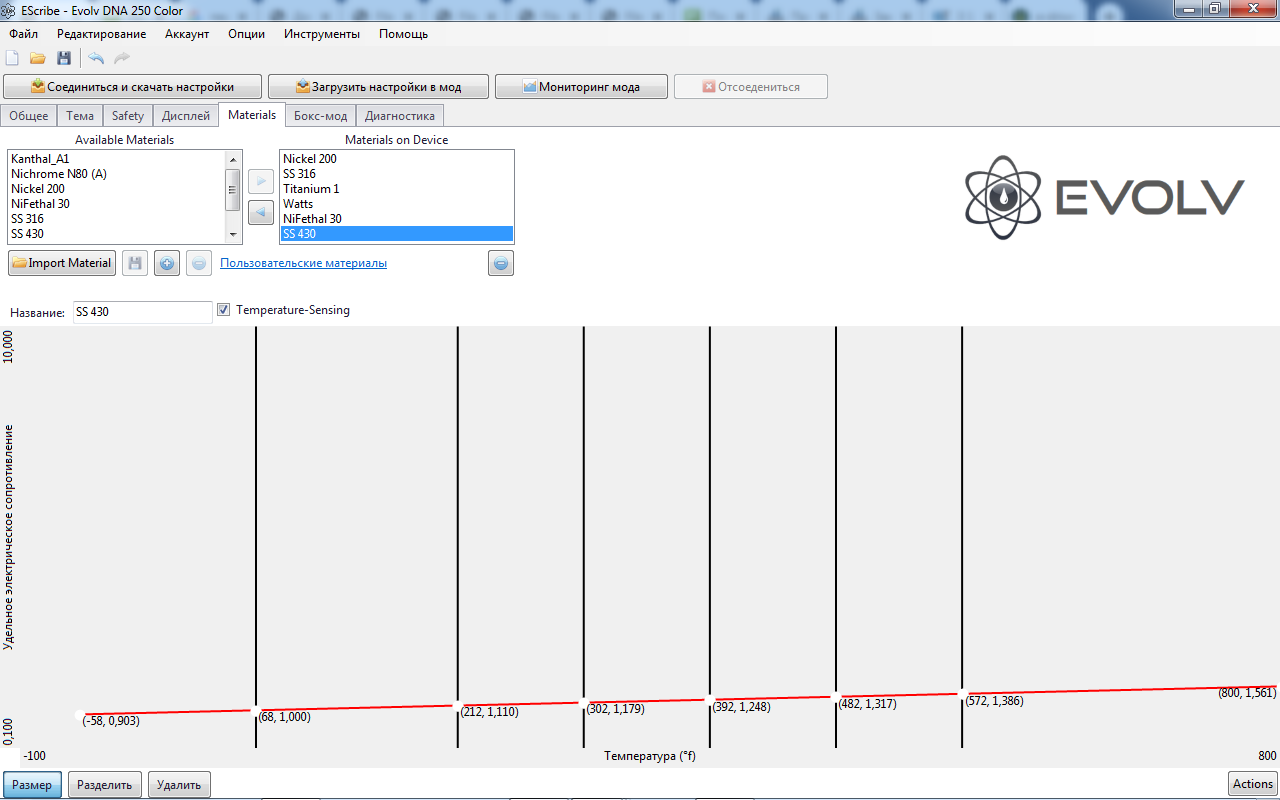

Mr.Bottomfeeder Posted February 7, 2020 Author Report Posted February 7, 2020 (edited) vor 7 Stunden schrieb zark: "TDS" определяет состояние "False" или "True" по наличию TCR для материала катушки в Escribe, при выборе материала пользователь знает состояние "TDS" (это материал который поддерживает температурный контроль или нет). К тому же очень просто использовать условие при котором мод автоматически переходит в режим Watts при "TDS"=> "False" Прошу прошения, я наверняка не совсем правильно понимаю нюансы диалога, но мне кажется, что вы пытаетесь решить проблему шаманскими методами, в то время, как решение должно быть на уровне настроек автоматизации в Ваших темах. Еще раз прошу прощения, я никого не хочу обидеть! Hello zark, thanks for your information an help to find a solution. Unfortunately I am not able with reading cyrilic-writings. So I translated it with a translator, what says: "TDS" determines the state of "False" or "True" by the presence of TCR for the coil material in Escribe, when choosing a material, the user knows the state of "TDS" (this is material that supports temperature control or not). In addition, it is very simple to use the condition under which the mode automatically switches to Watts mode with "TDS" => "False" I apologize, I probably do not quite understand the nuances of the dialogue, but it seems to me that you are trying to solve the problem using shamanistic methods, while the solution should be at the level of automation settings in your themes. I apologize again, I do not want to offend anyone! " But unfortunately I can't understand the content of that you've written, nevertheless. "TDS" means "TSD"(Temp Sense Detect)? Is that correct? What is "TCR"? Will it means "TempCoil-Resistance"? I believe, you mean "TSM" (Temp Sense Material)-flag, what is set by the system as well, with the content you've written - could that be? My problem is, TSD swaps while using the mod (puffing) from "True"-State from one moment to another into "False" without changing anything in settings and/or Coil. And if it is switched to false by the system, I only have Wattage-Mode until I perform the hint by Gwyar (increase up the coil resistance by hand - for provucating the message "New Coil") to bring the state of the Flag "TSD" to "True" again and getting TempControl-functionality back. The TSD- and TSM-Flags are only readable but not writeable - means, it can't be switched by the user. Perhaps you will write your message in english again, if possible - would be glad to understand, what you've written. Kind regards Edited February 7, 2020 by Mr.Bottomfeeder

zark Posted February 8, 2020 Report Posted February 8, 2020 16 часов назад, Mr.Bottomfeeder сказал: What is "TCR"? Will it means "TempCoil-Resistance"? I believe, you mean "TSM" (Temp Sense Material)-flag, what is set by the system as well, with the content you've written - could that be?
zark Posted February 8, 2020 Report Posted February 8, 2020 16 часов назад, Mr.Bottomfeeder сказал: And if it is switched to false by the system, I only have Wattage-Mode until I perform the hint by Gwyar (increase up the coil resistance by hand - for provucating the message "New Coil") to bring the state of the Flag "TSD" to "True" again and getting TempControl-functionality back. По моим наблюдениям подобная проблема возникает при использовании катушек в которых реальный TCR отличается от табличных значений Evolv ( сложные катушки или катушки состоящие из разных материалов, сетчатые испарители) @gwyar совершенно прав, изменение сопротивления вручную часто исправляет эту проблему, но не обязательно заставлять мод выдавать сообщение про замену катушки, можно перейти в меню сопротивления и изменять сопротивление с шагом примерно 0,0005 Ом, пока не будет достигнута корректная работа катушки. P.S. This forum has a built-in translation function. You need to right-click on a blank spot on the screen and select "Translate to ..." 1

zark Posted February 8, 2020 Report Posted February 8, 2020 16 минут назад, gwyar сказал: Это, конечно, правда, но речь шла о том, чтобы заставить ОС сбросить флаг TSD. Скорее всего это невозможно прямыми методами, алгоритм Evolv построен так, чтобы свести к минимуму ошибки при TC. По этому производители защищают свою репутацию таким образом: гораздо проще перевести мод в режим Watts чем усложнять алгоритм работы устройства, что бы справиться со сложной ситуацией в TC.
Mr.Bottomfeeder Posted February 9, 2020 Author Report Posted February 9, 2020 (edited) Hallo @Zark, vielen Dank für Deine Hilfe. Leider verstehe ich immer noch nicht, was Du mit TCR bezeichnest. Ich vermute, dass dies ggf. eine Übersetzung von einem Wert ist, welchen wir unter einem anderen Kürzel kennen. Meine Hauptfragen sind: 1. Wenn TSD = "False", arbeitet der DNA dann nur noch im Power-Mode - solange, bis TSD = "True" ? 2. Wenn TSM = "False", arbeitet der DNA dann nur noch im Power-Mode - solange, bis TSD = "True" ? 3. Wenn 1 = Ja und 2 = Ja, dann frage ich mich, warum dann der "Temp-Protect"-Switch und der "Can Preheat"-Switch nicht vom DNA auf "False" und "Can Boost" nicht auf "True" gesetzt werden, wenn TSD = "False" | TSM = "False". Das sind für die Erstellung von Themes und deren korrekte Funktion immens wichtige Fragen. Wobei mir leider immer noch nicht aus Deinen Beschreibungen heraus ersichtlich ist, wie der DNA funktioniert, um das "TSD"-Flag zu setzen bzw. zu löschen. Hallo @Gwyar, mein Browser kann auch nur dank eines Addons Webseiten und markierte Textblöcke übersetzen. Aber damit kann man ja leben. 🙂 Leider geht manchmal der Sinn von etwas geschriebenem durch die Übersetzung verloren und der Leser bleibt ratlos. Ja, wie ich an Zork geschrieben habe, muss ich wohl die komplette Steuerung meines Themes nochmal überarbeiten. Je nachdem, wie der DNA dann tatsächlich arbeitet, wenn TSD und/oder TSM = "False" sind. Ich vermute, dass dann der DNA im reinen Power-Modus arbeitet - und so sollte dann in einem solchen Fall auch das Display aussehen und die Steuerung entsprechend angepasst werden. Meine Vermutung zu dem "Menu Error" habe ich hier: in meinem Kommentar vom 25.November 2018 geschrieben. Daher wundert es mich, dass Du mit "Goto Child-Screen"-Aufrufen (welche ja m.E. wie Gosub-Befehle arbeiten), weniger Probleme zu haben scheinst, als mit "Goto Another Screen", die m.E. am ehesten den "Goto"-Befehlen entsprechen und im Gegensatz zum Child-Aufruf keinen Return-Stack befüllen, welcher u.U. beim "Goto Parent Screen" überlaufen oder in falscher Reihenfolge ausgelesen werden kann, wenn z.B. nach einem "Goto Child-Screen", dieses aufgerufene Screen mit einem "Goto Another Screen" verlassen wird, anstelle mit einem "Goto Parent Screen". Zumal - wie ich vermute - mit "Goto Another Screen" wild zwischen den Screens hin und her gesprungen werden kann. Ich hätte und habe genau das Gegenteil erwartet und wollte daher den "Goto Another Screen"-Aufrufen den Vorzug zu geben. Soweit meine Logik Jo, am DNA und dem Theme-Builder gäbe es m.E. schon noch einige Arbeit, um die richtig brauchbar zu machen. 🙂 Aber das liegt ja leider nicht in unseren Händen. Wünsche Euch einen ruhigen Sonntag Beste Grüsse Hello @Zark, Thank you for your help. Unfortunately I still don't understand what you mean by TCR. I suspect that this may be a translation of a value that we know by another acronym. My main questions are: 1. If TSD = "False", does the DNA only work in power mode then - until TSD = "True"? 2. If TSM = "False", does the DNA only work in power mode then - until TSD = "True"? 3. If 1 = Yes and 2 = Yes, I wonder why the "Temp-Protect" switch and the "Can Preheat" switch do not change from DNA to "False" and "Can Boost" not to "True" "are set if that conditions becomes an "False"-State, if TSD = "False" | TSM = "False". These are immensely important questions for the creation of themes and their correct functioning. However, unfortunately I still cannot recognize from your descriptions how the DNA works to set or clear the "TSD" flag. Hello @Gwyar, my browser can also only translate websites and selected text blocks thanks to an third-party add-on. But we can live with that. 🙂 Unfortunately, sometimes the meaning of something written is going lost through the translation - and the reader remains helpless. Yes, as I wrote to Zork, I probably have to revise the complete control of my theme again. Depending on how the DNA actually works if TSD and / or TSM = "False" in fact. I suspect that the DNA then works in pure Power mode if one of ther conditionsTSD or TSM is "False" - and that is what content the display should show and the control-screens should be adjustable accordingly. I have my assumption about the "Menu Error" written in the link of my upper german part of this message in my comment of November 25, 2018. Therefore, I am surprised that you seem to have fewer problems with "Goto Child-Screen" calls (which in my opinion works like "Gosub" commands) than with "Goto Another Screen", what in my opinion most closely correspond to the "Goto" commands and allows to jump free across the screens. Since in contrast to the "Goto-Child-Screen" call, the "Goto Parent Screen" has not to fill a return-address stack, which may overflow or can be read out in the wrong order when try to jump back. For example, if using a "Goto another Screen" instead of "Goto Parent Screen" while being in a Screen, that was called by a "Goto Child Screen". As far my logic. So, I would have expected the opposite and therefore wanted to give preference to the "Goto Another Screen" calls. Uh yes, in my opinion the DNA and the Theme Builder really could need some more work and improvements to make them really usable . 🙂 But unfortunately that is not in our hands. Wish you a quiet Sunday Best regards Edited February 9, 2020 by Mr.Bottomfeeder

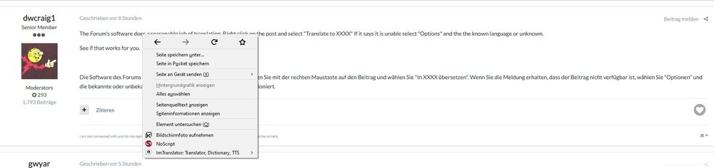

dwcraig1 Posted February 9, 2020 Report Posted February 9, 2020 The Forum's software does a reasonable job of translating. Right click on the post and select "Translate to XXXX" If it says it is unable select "Options" and the the known language or unknown. See if that works for you. Die Software des Forums leistet angemessene Übersetzungsarbeit. Klicken Sie mit der rechten Maustaste auf den Beitrag und wählen Sie "In XXXX übersetzen". Wenn Sie die Meldung erhalten, dass der Beitrag nicht verfügbar ist, wählen Sie "Optionen" und die bekannte oder unbekannte Sprache. Sehen Sie, ob das bei Ihnen funktioniert.

Mr.Bottomfeeder Posted February 9, 2020 Author Report Posted February 9, 2020 vor 8 Stunden schrieb dwcraig1: The Forum's software does a reasonable job of translating. Right click on the post and select "Translate to XXXX" If it says it is unable select "Options" and the the known language or unknown. See if that works for you. Die Software des Forums leistet angemessene Übersetzungsarbeit. Klicken Sie mit der rechten Maustaste auf den Beitrag und wählen Sie "In XXXX übersetzen". Wenn Sie die Meldung erhalten, dass der Beitrag nicht verfügbar ist, wählen Sie "Optionen" und die bekannte oder unbekannte Sprache. Sehen Sie, ob das bei Ihnen funktioniert. Hello dwcraig1, I find no such translating-option by this forum in my browser visible, if clicking with right mousebutton onto a posting. In the right-mousebutton-popup-menu only my third-party translating tool appears. Using Firefox in it's standard-edition. kind regards
