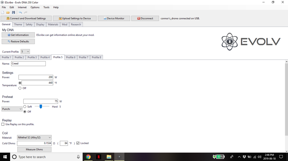

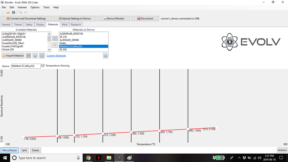

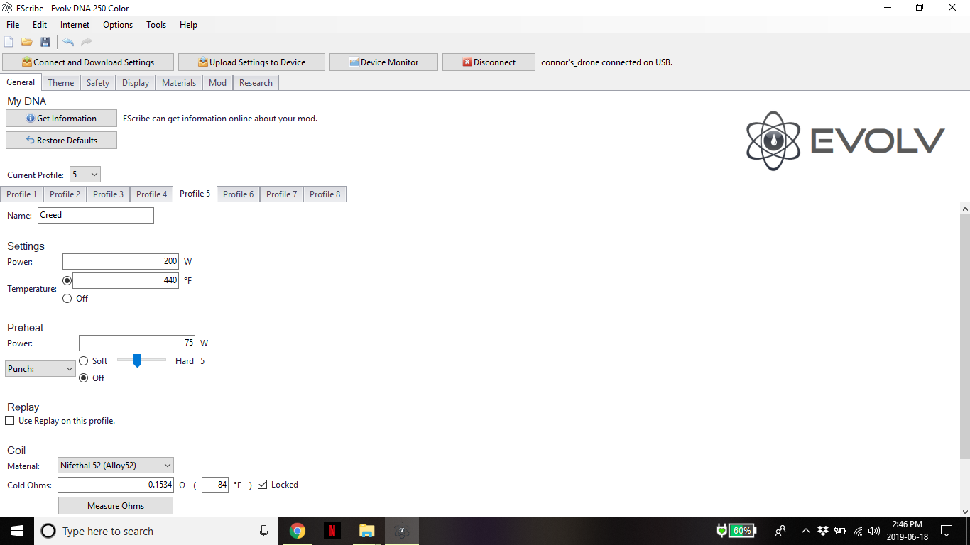

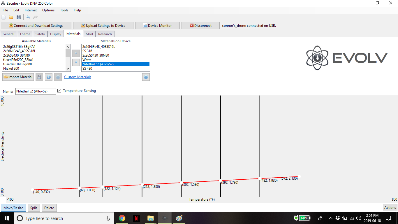

Drughugs Posted June 18, 2019 Author Report Posted June 18, 2019 any idea where I could find good information about claptons and TC? I generated a custom .csv for the aforementioned nife48/ss316l clapton, but looking now, the values seem to be identical to the plain jane, exclusively nife .csv. *sigh* even after three months of perusing this forum and others, im still coming up with more questions than answers. Here are screen shots. I appreciate your help.

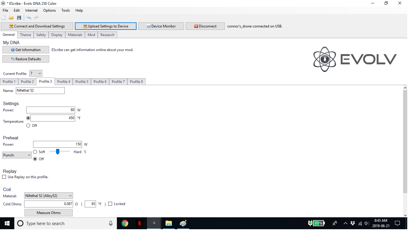

Wayneo Posted June 18, 2019 Report Posted June 18, 2019 Thanks greatly for those. 1 hour ago, Drughugs said: any idea where I could find good information about claptons and TC? I generated a custom .csv for the aforementioned nife48/ss316l clapton, but looking now, the values seem to be identical to the plain jane, exclusively nife .csv. You can't find anything, because there's nothing really to find. TC (or material type) doesn't care about coil ID, or number of wraps. Just the material. The numbers are identical because the wraps are pretty much just along 'for the ride'. The material file (values) looks fine. Your profile numbers are all backwards. Quick answer: Swap the 75 and 200 watts. Upload to device. Longer answer: 'Settings -> Power is the HARD MAXIMUM you want the mod to use, Ever. So if your TC is wonky, or not the right something, you won't get 136 watts blasting your lips. 'Preheat -> Power is the maximum you want the mod to use while it is getting your coil up to the temp you've set. Punch says how close to the set temp it gets before ENDING the Preheat values. The higher the value for Punch (max 11) the closer it goes to your set value. SO, you should always set your preheat value higher than the power value. BTW, I hope you can vape that atty at 75 watts comfortably. If you now post a Printscreen from Device Monitor while taking a puff, we can try to decipher more. (Tick/check the cold ohm/live ohm (2) and power boxes (2). 2

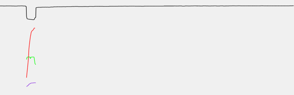

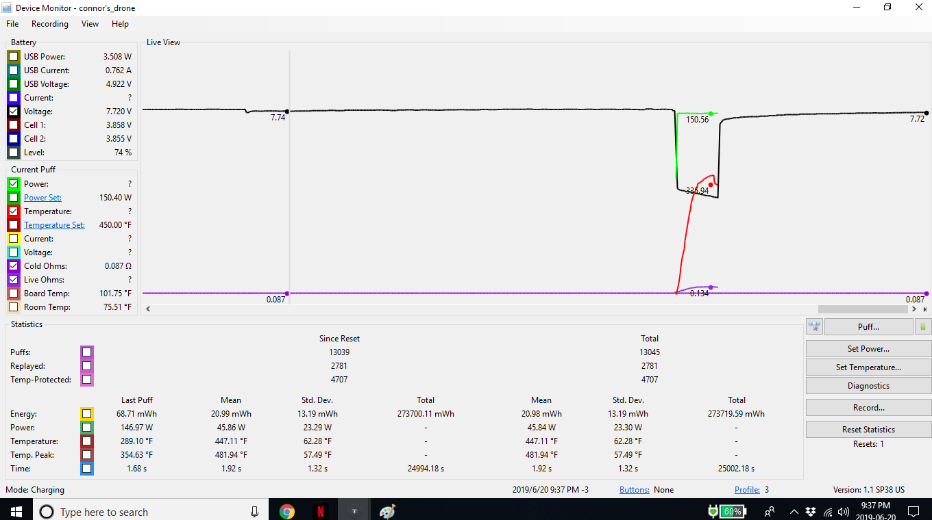

Drughugs Posted June 19, 2019 Author Report Posted June 19, 2019 Im getting good results with ss430, fwiw. The following device monitor grabs are from aforementioned nifethal claptons, after adjusting the preheat and power as you suggested.
Wayneo Posted June 19, 2019 Report Posted June 19, 2019 @Drughugs Without the details of the whole Printscreen, I can't tell whats up.

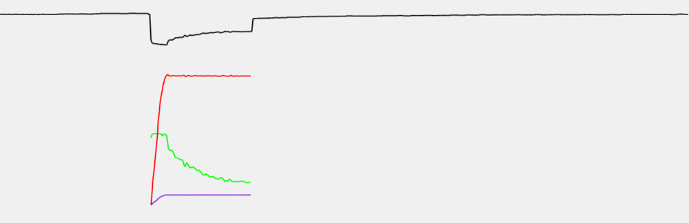

Drughugs Posted June 21, 2019 Author Report Posted June 21, 2019 (edited) I fail at paint, lol Edited June 21, 2019 by Drughugs

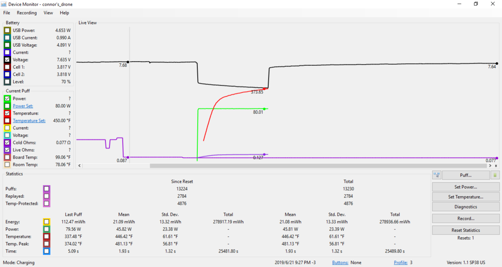

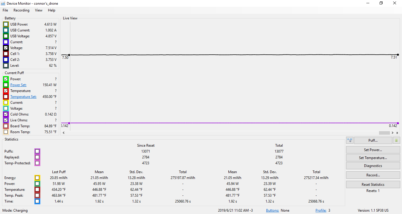

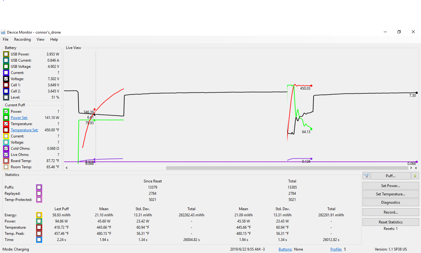

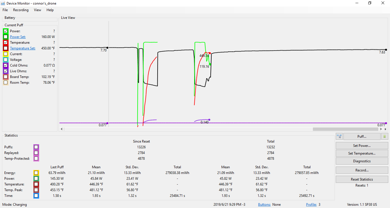

Drughugs Posted June 21, 2019 Author Report Posted June 21, 2019 There, I figured out paint. Totally forgot about the snipping tool. You can see from the device monitor that it gives me max wattage regardless of what its set to.
Drughugs Posted June 21, 2019 Author Report Posted June 21, 2019 heres the same profile with a single coil instead of dual.

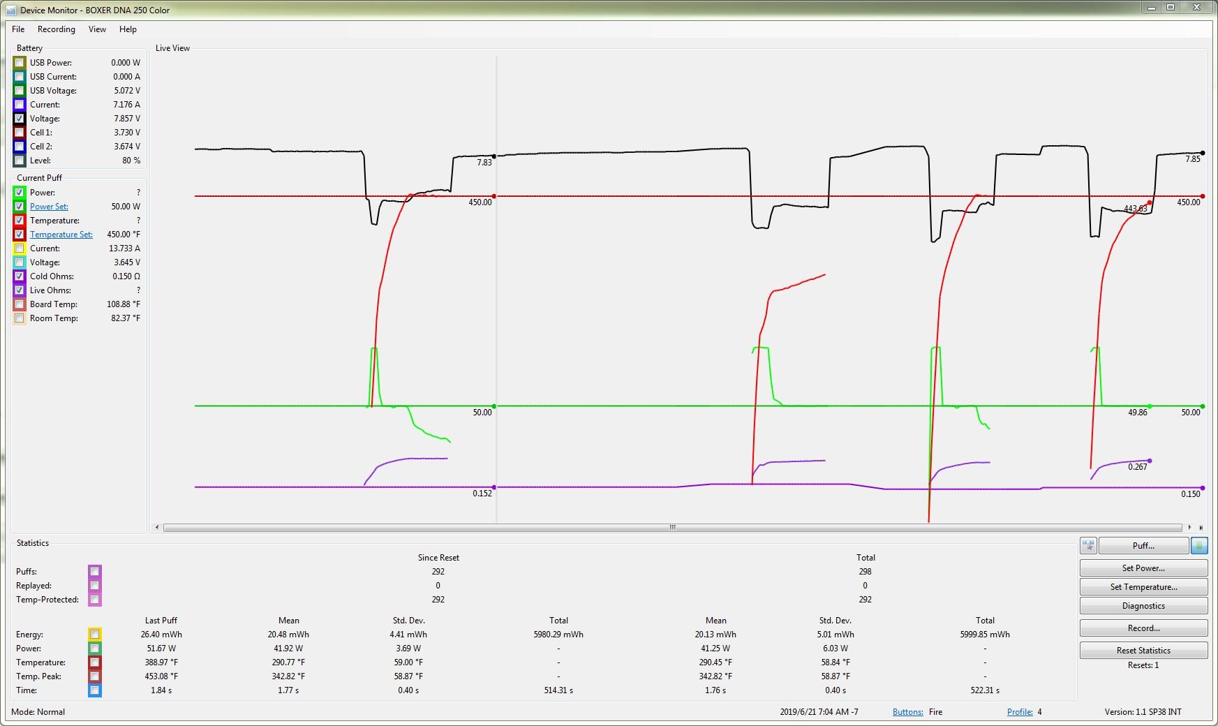

dwcraig1 Posted June 21, 2019 Report Posted June 21, 2019 I was hoping Wayne would show up this morning. I put a coil of Zivipf NiFe48 in a RBA, it's 2 strands of tightly twisted 26 gauge. Included here is the correct CSV for temp coefficient of NiFe48. 48 and 52 are close but not the same. The snip is of using setting for both 48 and 52, 48 is on the far left and far right, forget the center ones. What I was wanting to see was the increase in resistance when heated, note it darn near doubles. Preheat is set to 75 watts. NiFe48.csv
Drughugs Posted June 21, 2019 Author Report Posted June 21, 2019 The material that i'm using is listed as nife48 on zivipf.de, but as I understand it, I should be using the Alloy 52 csv because it is actually Sandvik's Nifethal 52. I think some of my problems come from being too low in resistance. I made a framed staple entirely of zivipf nife48, it was something lik 0.065ohm, and i had the same problem. Is the graph using only the csv you attached?
dwcraig1 Posted June 21, 2019 Report Posted June 21, 2019 The 2nd fire is using SteamEngine's Alloy 52, other 3 are for NiFe 48 Zivipf NiFe is 400 (or 0.004) Alloy 52 is 403.6 (or 0.00436)
dwcraig1 Posted June 21, 2019 Report Posted June 21, 2019 This is the one pertaining to your settings. 0.065 ohms should be no problem
Wayneo Posted June 21, 2019 Report Posted June 21, 2019 @Drughugs Can you describe the coil that's in there now, and If you use Atomizer Analyzer (bottom of the profile page), is the resistance value relatively stable. One last thing, you might want to move the Punch value up to 11 and retry if it all looks good. Like @dwcraig1 mentioned, your coil resistance should almost be double the cold ohm value. No, I don't think the build is too low.
Drughugs Posted June 22, 2019 Author Report Posted June 22, 2019 the coils in this snip are 2*26 gauge core with 38g cladding, all zivipf nife48. dual coils.
Drughugs Posted June 22, 2019 Author Report Posted June 22, 2019 Just did the atomizer analyzer, it varies by about 0.03.

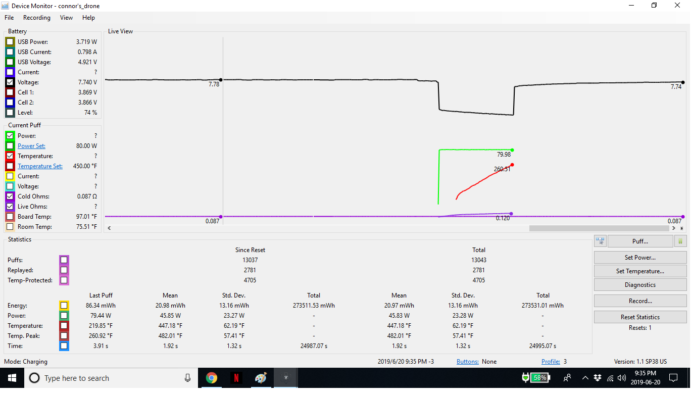

Wayneo Posted June 22, 2019 Report Posted June 22, 2019 So, just checking. You're saying your cold/ambient coil which reads 0.077 ohms, fluctuates +/- 0.03, which would put it at .107 ohms high in AA, just sitting there? On the other hand, that second puff in the second pic actually hit temp, but it was a brief puff. Did it seem too hot? Now that you're back to dual coils with more mass, you do need more watts, but something just feels off to me. How many watts can you use without TC with that coil (safely that you like) <- You can just leave the temp as is and turn down preheat to say your 80, and slowly just increase the Power (watts) while staying in this profile.
Drughugs Posted June 22, 2019 Author Report Posted June 22, 2019 The resistance changed while unscrewing the atomizer, i kinda just did what the window said. I can use it comfortably at 80 watts for a couple seconds. Im wondering if it could have anything to do with room temp, my environment varies quite a bit througout the day
Drughugs Posted June 22, 2019 Author Report Posted June 22, 2019 (edited) Shoot, didnt notice your reply regarding the difference between 52 and 48. Ill try the csv you uploaded. Does it matter that it only has three points? Which material would I use on wire wizard? PS Just tried your .csv, seems to be working! Any tips on why my ss430 alien build isnt working? Similar problem; although maybe I should post in another thread. Thanks a bunch! Y'all are wizards. Edited June 22, 2019 by Drughugs post script
dwcraig1 Posted June 22, 2019 Report Posted June 22, 2019 It's not a curve but should work just as well as the curve is almost linear anyway. It may make a slight difference, might not, use the one that seems to work best.
