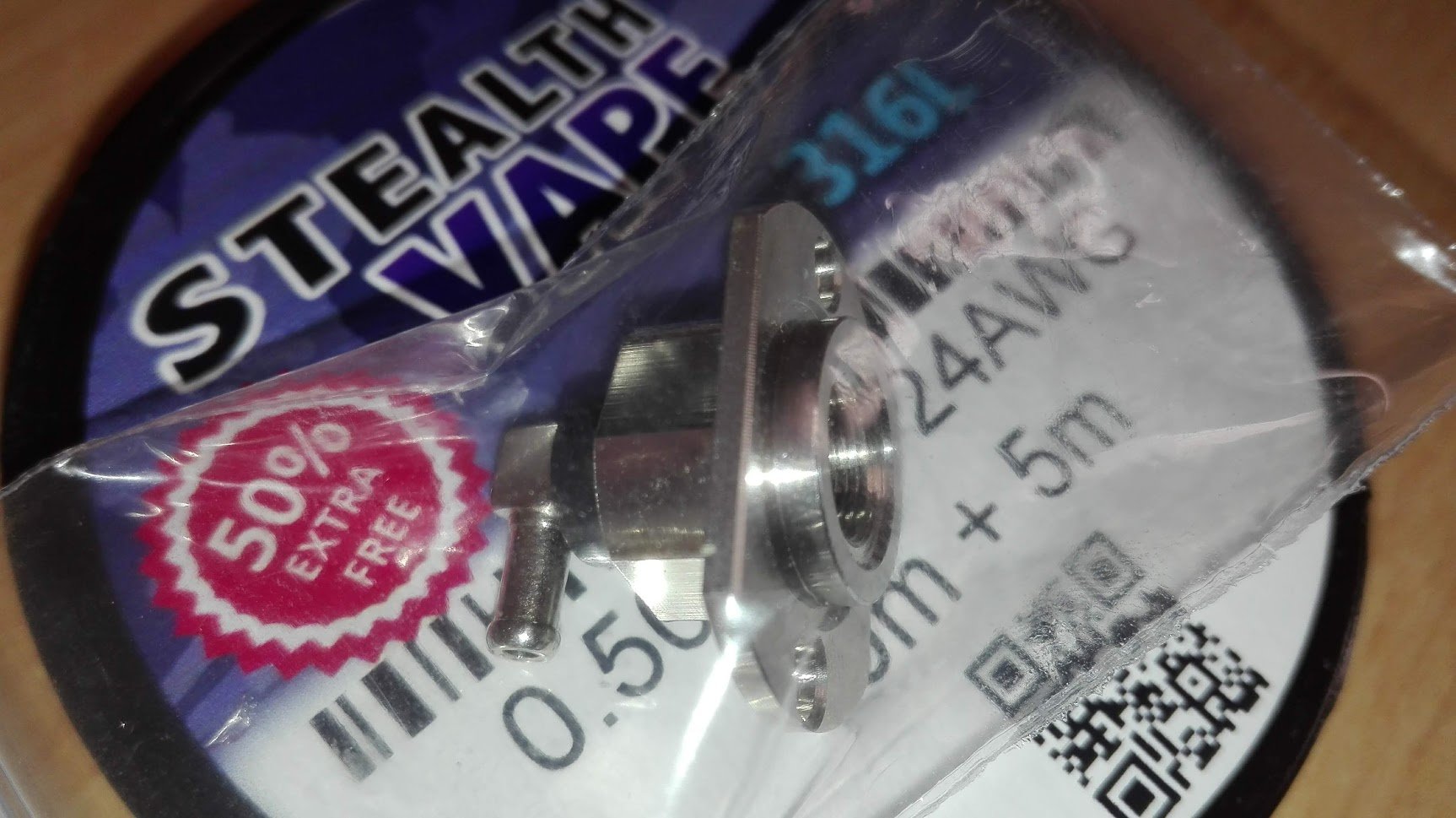

LowCol Posted July 4, 2019 Report Posted July 4, 2019 En 29/5/2019 at 1:48 , Robbybob dijo: At the moment I'm trying out tightening up the square nut on the underside of the 510. It doesn't seem like it will tighten up but using a 510 tightening tool and a 12mm spanner you can get an extra half turn. With some success. The whole 510 is completely reliant on one rubber washer to seal. If the nut is tight and the 510 pin which has the potential for lateral movement moves straight up and down there "should" be no leaks. It's really frustrating @Robbybob I have the same leak problem in my Drone. It filters liquid through the squonk pin when I connect an RDA and the pin moves down. You could solve the problem definitely by turning the nut half a turn? you know another way to solve the problem of leaks in the Drone? I share reference image of the Smoking-maniac channel on youtube. in the image you can see where my drone drips liquid. En 9/5/2019 at 4:45 , etab75 dijo: Hopefully this will be my final update! Contacted Rob at Stealthvape (Evolv/Lost Vape servicing here in the UK) and he has supplied me with a brand new leak free 510, so everything is good 👍 Rejoice leak free drone! @etab75 When did you change the connector 510 stopped the leakage of your drone? Is there any difference between the damaged 510 connector of your drone and the new one that was sent to you from EVOLV? Do you have any advice to fix my Drone and not have more leaks?

gsmit1 Posted April 22, 2020 Report Posted April 22, 2020 On 5/9/2019 at 5:45 AM, etab75 said: Hopefully this will be my final update! Contacted Rob at Stealthvape (Evolv/Lost Vape servicing here in the UK) and he has supplied me with a brand new leak free 510, so everything is good 👍 Rejoice leak free drone! What was involved in installing this 510 piece please. As far as soldering and stuff like that? Thanks for the help.

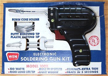

dwcraig1 Posted April 22, 2020 Report Posted April 22, 2020 Care must be taken to protect the parts that can melt, preferable to disassemble. I use a high watt gun and use silver solder and flux as with plumbing for the ground connection if it attaches to the 510 body. I am by no means an expert about this, just my 2 cents. 2
gsmit1 Posted April 22, 2020 Report Posted April 22, 2020 1 hour ago, dwcraig1 said: Care must be taken to protect the parts that can melt, preferable to disassemble. I use a high watt gun and use silver solder and flux as with plumbing for the ground connection if it attaches to the 510 body. I am by no means an expert about this, just my 2 cents. I have an 18 watt Weller iron and a 100 watt Weller gun. i got one of the ones that doesn't leak. That makes me feel bad when somebody I know got one of the leakers. I was actually asking for him. I'm not the world's greatest soldering ninja either and he sounds like he has less confidence than me. Which is fine. It's better to recognize that. I suggested he maybe try to find some outfit in his area that would do it. Probably while he waits if he has it all apart when he takes it there. A competent guy could de-solder the old one and put the new one in in probably 10 or 15 minutes. for a few bucks.
