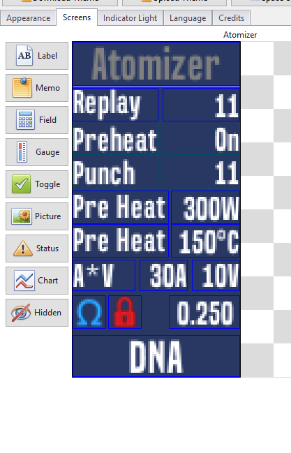

Vapors Tongue Posted April 4, 2019 Report Share Posted April 4, 2019 i've done a theme and added preheat power and pre heat temp they are both set in the theme to be changed and not read only , yet the pre heat power option will only allow me to read and the preheat temp is fine , is there something im not doing ? in another setting that will allows the preheat power to become changeable Link to comment Share on other sites More sharing options...
Vapors Tongue Posted April 4, 2019 Author Report Share Posted April 4, 2019 (edited) right the pre heat power is only available in temp control , so now i'm wondering what is actually changeable in replay mode , as in boost , replay warmth and punch Edited April 4, 2019 by formula 1 Link to comment Share on other sites More sharing options...
Wayneo Posted April 4, 2019 Report Share Posted April 4, 2019 You can only pre heat in a TC profile You can only boost punch when your material is not identified as a TC material in a profile (there's a whole lot said there in a few words) Link to comment Share on other sites More sharing options...
Vapors Tongue Posted April 4, 2019 Author Report Share Posted April 4, 2019 (edited) On 4/4/2019 at 12:24 PM, Wayneo said: You can only pre heat in a TC profile You can only boost punch when your material is not identified as a TC material in a profile (there's a whole lot said there in a few words) Expand its just that im seeing miss information when different reviewers on youtube say or tell you something that is not even possible - jai haze said you can alter change the boost in replay by going to profile boost watts then back to replay that seems to do nothing whatsoever , so the only thing changeable in replay mode is punch , boost on and warmth from the scale 1 to 11 there is no other way to actually select a different wattage for the boost or warmth Edited April 4, 2019 by formula 1 Link to comment Share on other sites More sharing options...
Wayneo Posted April 4, 2019 Report Share Posted April 4, 2019 Huh? I'm not gonna comment on any reviewer, but yes, there's misinformation all over the place. BUT you can prove what I said to yourself. Go into escribe, and look at any profile with a TC material showing at the bottom. See the options for Preheat and punch? Change the material there to watts/kanthal, and now look at the options. Preheat should have disappeared, and now magically you see boost 1 Link to comment Share on other sites More sharing options...
