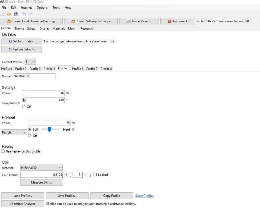

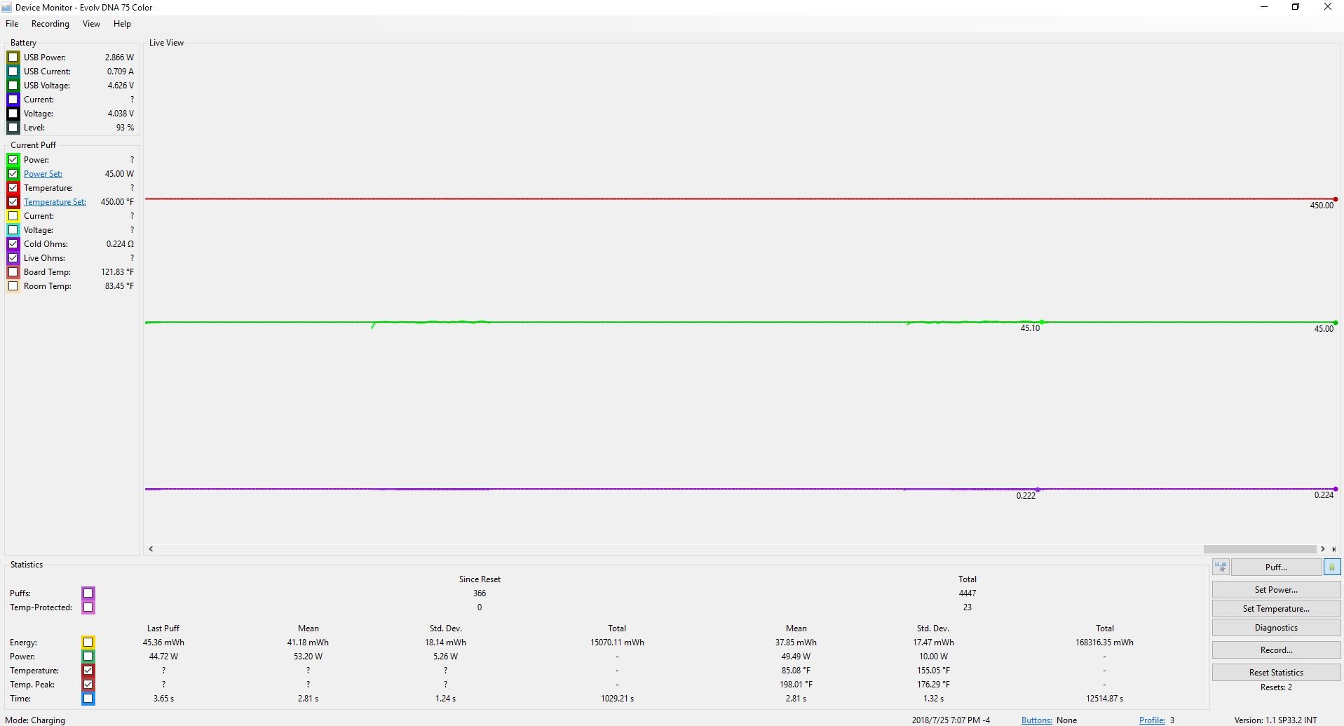

GTIJim Posted July 24, 2018 Report Posted July 24, 2018 Hey all, I've recently purchased a Lost Vape DNA 75C Mirage and I'm having issues with Temp Control. I can't get it to work at all with different materials and different atomizers. I've spent countless hours googling, youtubing, and searching the forums but can't figure out what's up. When I hook it up to Escribe and go to device monitor I get no temp reading when vaping. I've spent about a month pretty sure that this is due to my noobness with the DNA and Escribe but now I'm starting to wonder if there could be something wrong with the board. Can anyone help? Attached is a screenshot of device monitor with Temperature checked but not showing anything during two puffs. Atomizers Used: Smok TFRDTA GeekVape Avocado RDTA 24 Vandy Vape Bonza RDA Materials: SS Kanthal Ni80 Document.docx

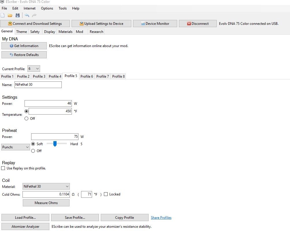

GTIJim Posted July 24, 2018 Author Report Posted July 24, 2018 Here is a screenshot of my Profile 5 settings. Is there anything else I should provide?
retird Posted July 25, 2018 Report Posted July 25, 2018 Best guess... N30 wire material per Profile 5... Your ohm's while firing are flat lining.... no change in ohms while firing thus the dna won't recognize the wire as a wire that will work with temp control (like kanthal does too)... Here is a TFR downloaded as a CSV file for DNA's from Steam Engine.... compare it to your N30 CSV.... I've never used N30. DNA200-NiFe30_(Resistherm_-_TCR)-SteamEngine.csv

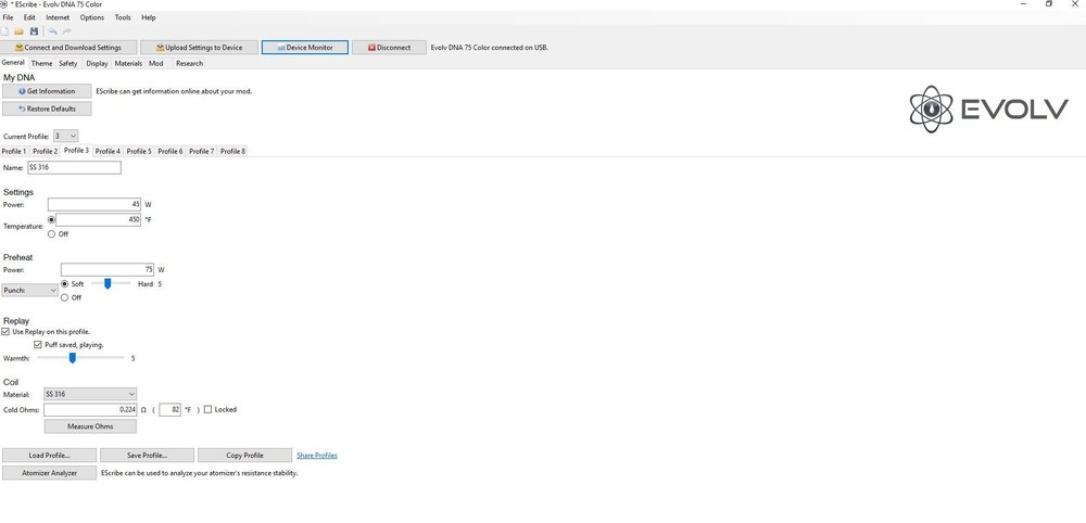

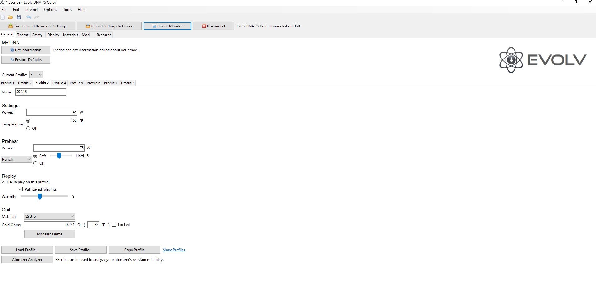

Wayneo Posted July 25, 2018 Report Posted July 25, 2018 Throw a SS build in your Bonza. Use the same settings as your Profile 5, cept make sure you select SS material. Post Printscreen with Cold ohms, Live ohms, Temp.
GTIJim Posted July 25, 2018 Author Report Posted July 25, 2018 I'll try that tonight and post some shots. Thanks!
GTIJim Posted July 25, 2018 Author Report Posted July 25, 2018 Here are my settings. I am using SS w 8 spaced wraps on the Bonza. No luck.
GTIJim Posted July 25, 2018 Author Report Posted July 25, 2018 Here are my settings. I am using ss w 8 spaced wraps on the Bonza. No luck.
GTIJim Posted July 25, 2018 Author Report Posted July 25, 2018 evolv approved an RMA request ticket. Is it time to send it in? I'd hate to do that if it's just user error but no matter what I try I get no temp reading.
Wayneo Posted July 26, 2018 Report Posted July 26, 2018 Wowza. I only have 1 last thought. Material tab. In the upper right hand listing of your materials, can you select SS316, and one last printscreen. Thanks.
