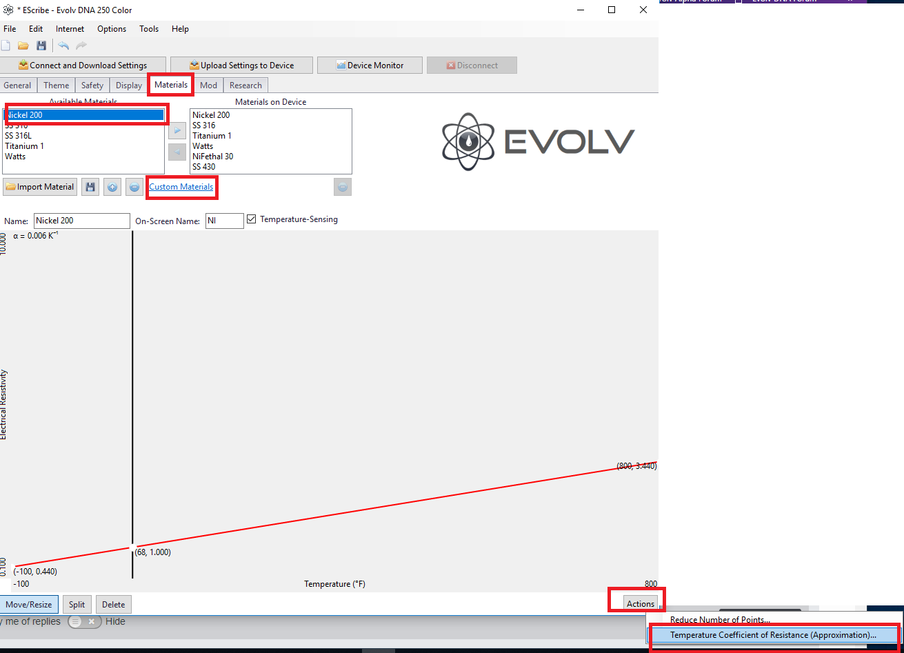

ParaVapor Posted July 21, 2018 Report Posted July 21, 2018 Where do I find the setting to adjust the TCR value on Escribe, or on my mod. Lost Vape Paranormal 250c.
retird Posted July 21, 2018 Report Posted July 21, 2018 Material tab in Escribe.... select a Material (or you can do a Custom Material)....

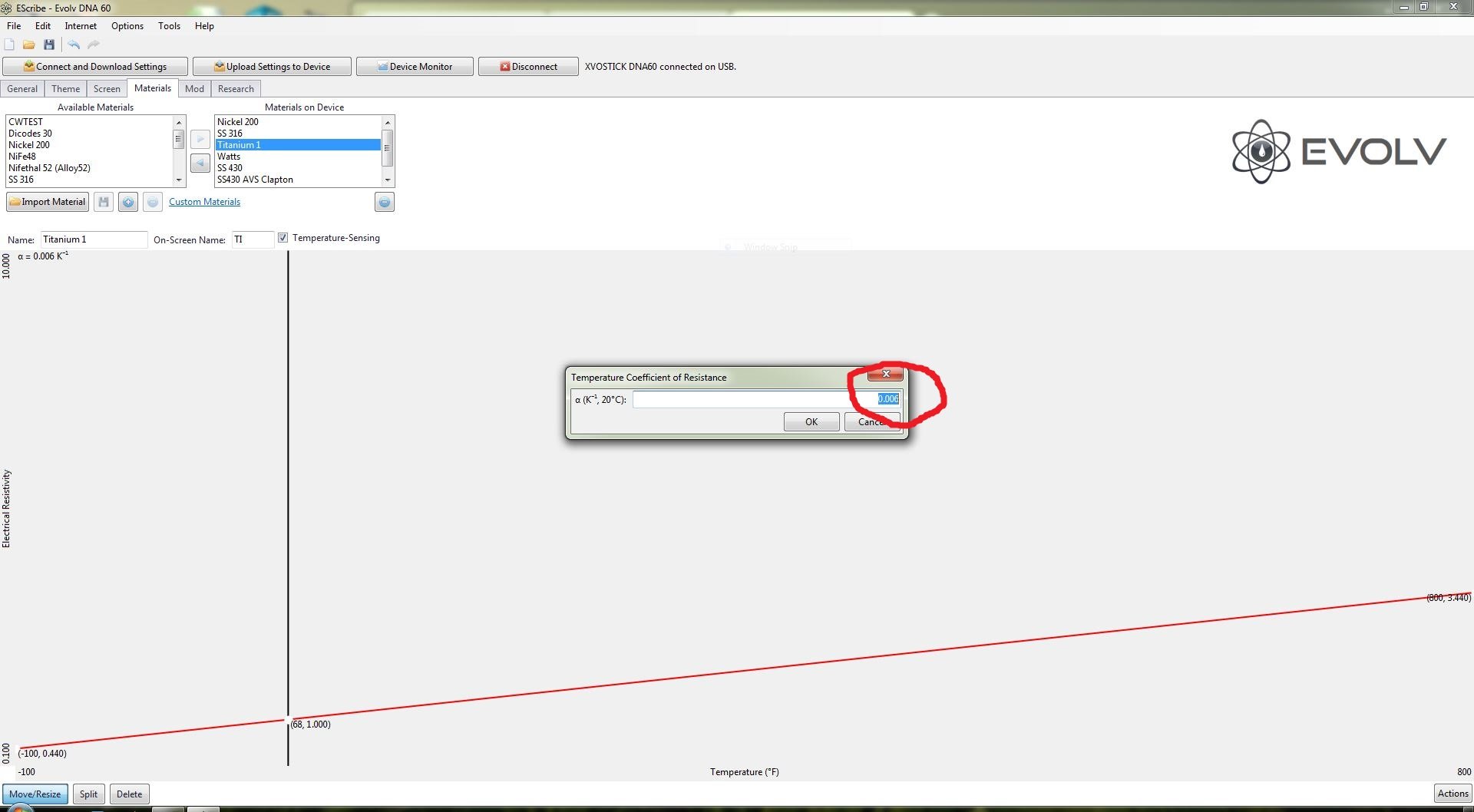

Dirone Posted December 23, 2019 Report Posted December 23, 2019 If I wanted a TCR of 300, what would I put in that box? Just confused on the conversion. I have a quartz quest and looking to set a profile for the below: TCR 300 49 Watts 500 F Any help would be greatly appreciated!
Dirone Posted December 23, 2019 Report Posted December 23, 2019 Thank you for the quick reply. What about if I want to bring the TCR down lower to two digit numbers? Say 98? Also, does the lower TCR mean a hotter temperature? Still trying to understand the TCR.
Wayneo Posted December 23, 2019 Report Posted December 23, 2019 So when you said ”If I wanted a TCR of 300, what would I put in that box? Just confused on the conversion” DW said 0.003, and that’s the same as 0.00300. Following that, a lower value of 98 would be 0.00098 The TCR of a material has nothing to do with hotter or colder. It merely states how much a material heats up. The 98 would heat up slower. (All things being equal) See that 500F you wrote, that’s the hotter or colder part.
