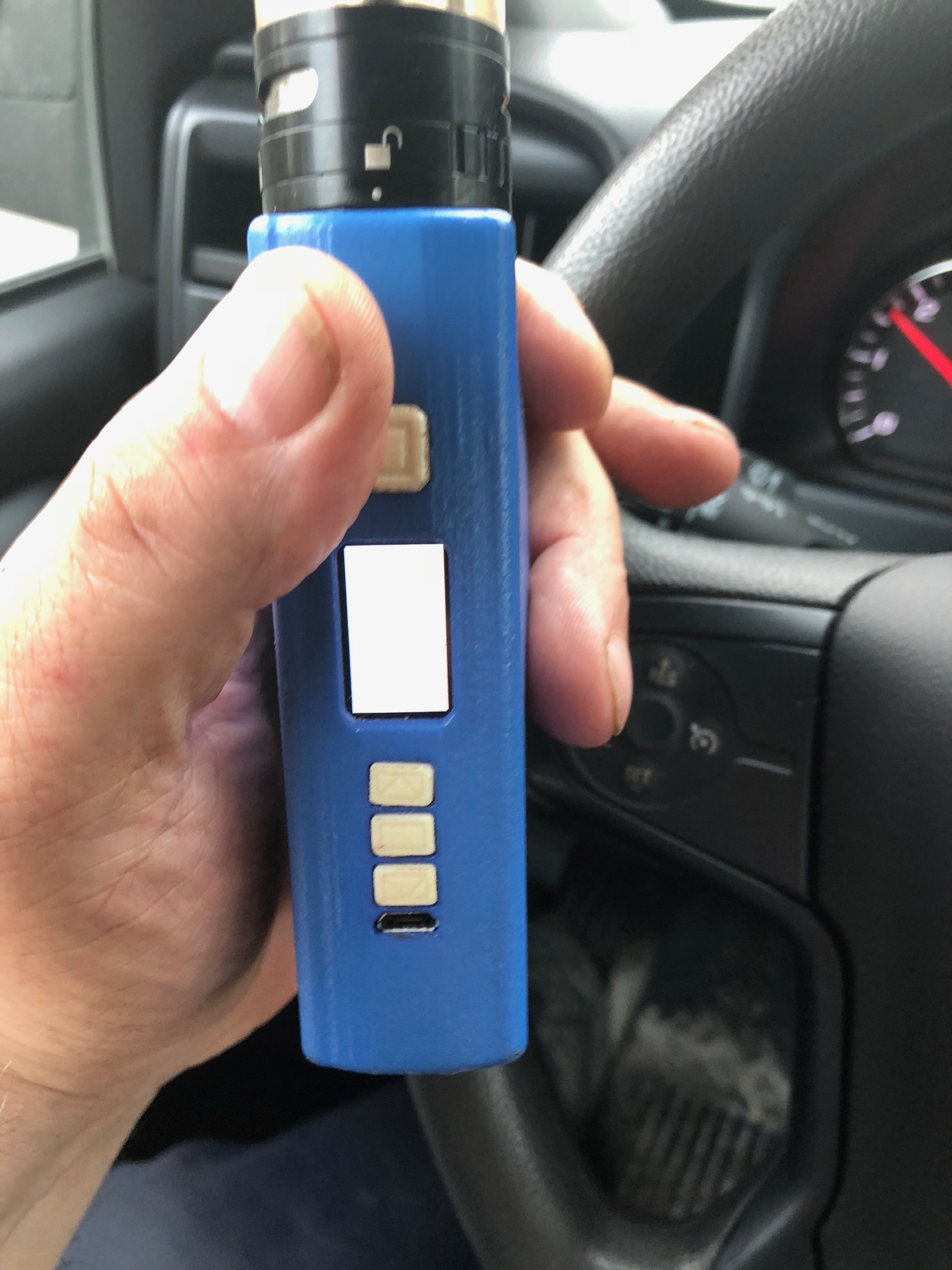

steamer861 Posted May 30, 2018 Report Posted May 30, 2018 Hi One of my 250c's, got a white screen yesterday, just out of the blue. I tried to rewrite the firmware , didn't work. I tried disconnecting & reconnecting the battery, didn't work. I tried rewriting the theme, didn't work. I tried a Hard Reboot & the screen came back :) But It did it 2 more times today :( The Hard reboot still worked :) How ever it is getting annoying now to have to do a Hard Reboot to get my screen back. Is this a known issue? Can I do some thing to Stop This from happening? BTW the Chip still works Fine, when this happens, just a White Screen
VapingBad Posted May 30, 2018 Report Posted May 30, 2018 I had it with fixed battery when connecting the screen after connecting the battery, disconnecting the battery and reconnecting solved it. 1
steamer861 Posted May 30, 2018 Author Report Posted May 30, 2018 2 hours ago, VapingBad said: I had it with fixed battery when connecting the screen after connecting the battery, disconnecting the battery and reconnecting solved it. Thanks for the reply The lipo has a XT30, I tried disconnecting the battery & no Go It seems the only thing that works is Hard Reboot. Also the screen isn't working perfectly either, The fonts get a bit distorted (pixelated) , the firing word on the bottom is missing letters, or don't work at all. Right after the hard Reboot the screen appears normal, until I hit the fire button, them the screen isn't normal any more It has done it, several times now over the past few days I fear the screen may not be making perfect contact at the Zif? I found they were harder to insert with the colour screen. It still works for now, this weekend I will open it up & investigate. Thanks again for the reply 1
steamer861 Posted June 2, 2018 Author Report Posted June 2, 2018 So I opened it up, I tried a new screen & it works again I tried the old screen on another 250c & it's white there to. So I think the screen is the issue? Luckily I have some extra Colour screens coming with my latest order 3
ruckus Posted June 8, 2018 Report Posted June 8, 2018 @steamer861 did you ever manage to fix this issue ? Just started happening to me few minutes ago.
steamer861 Posted June 8, 2018 Author Report Posted June 8, 2018 3 hours ago, ruckus said: @steamer861 did you ever manage to fix this issue ? Just started happening to me few minutes ago. Yes, the mod has been working fine for several days now. It was the screen. When I opened the mod. I was expecting, some thing obvious? A bad kink in the lead? a juice soaked screen? a loose Zif? None of that Every thing looked perfect! I guess the screen just went out.
